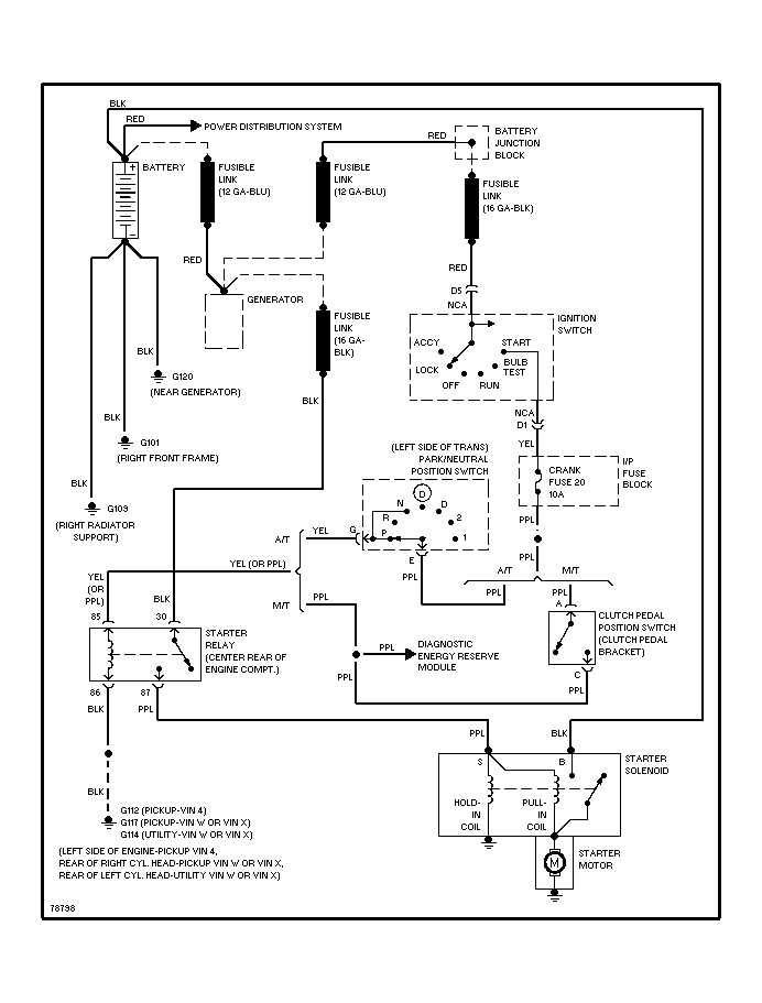

Question starting circuit
dose anyone have a correct wiring digram for a starting circuit for a 96 S-10 blazer with auto trans. and 4.3 V6 , lost power to park neutral safety switch , the yellow one that sends power to the starter relay purple.
thanks for any help
Old Aug 16, 2010 | 11:42 PM
Here ya go:

you are the best man thanks i will keep digging with your info now. i will let you know how it goes. later
