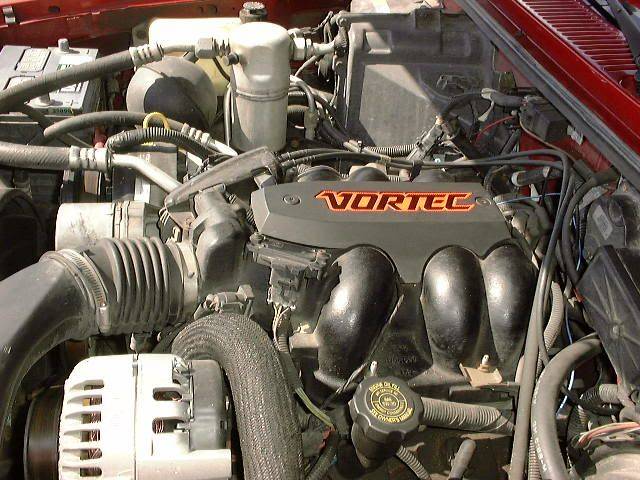

I have a 95 Blazer LT. And I want to put a Kn intake on , But it says it has to be a vortec cpi. How do I find out wich is my engine?

It should say "Vortec" on the plastic cover over the intake.

Yes I know it's a vortec but how do i find if its a TBI or CPI ?

If it's a 1995 S-series Blazer, then it is a CPI engine. TBI wasn't an option in 95 for the s-series SUV. If you need further confirmation, a TBI engine would have the air cleaner mounted on top of the engine.

Thank you very much , the air filter isn't. On top of motor. You are a big help thanks again
