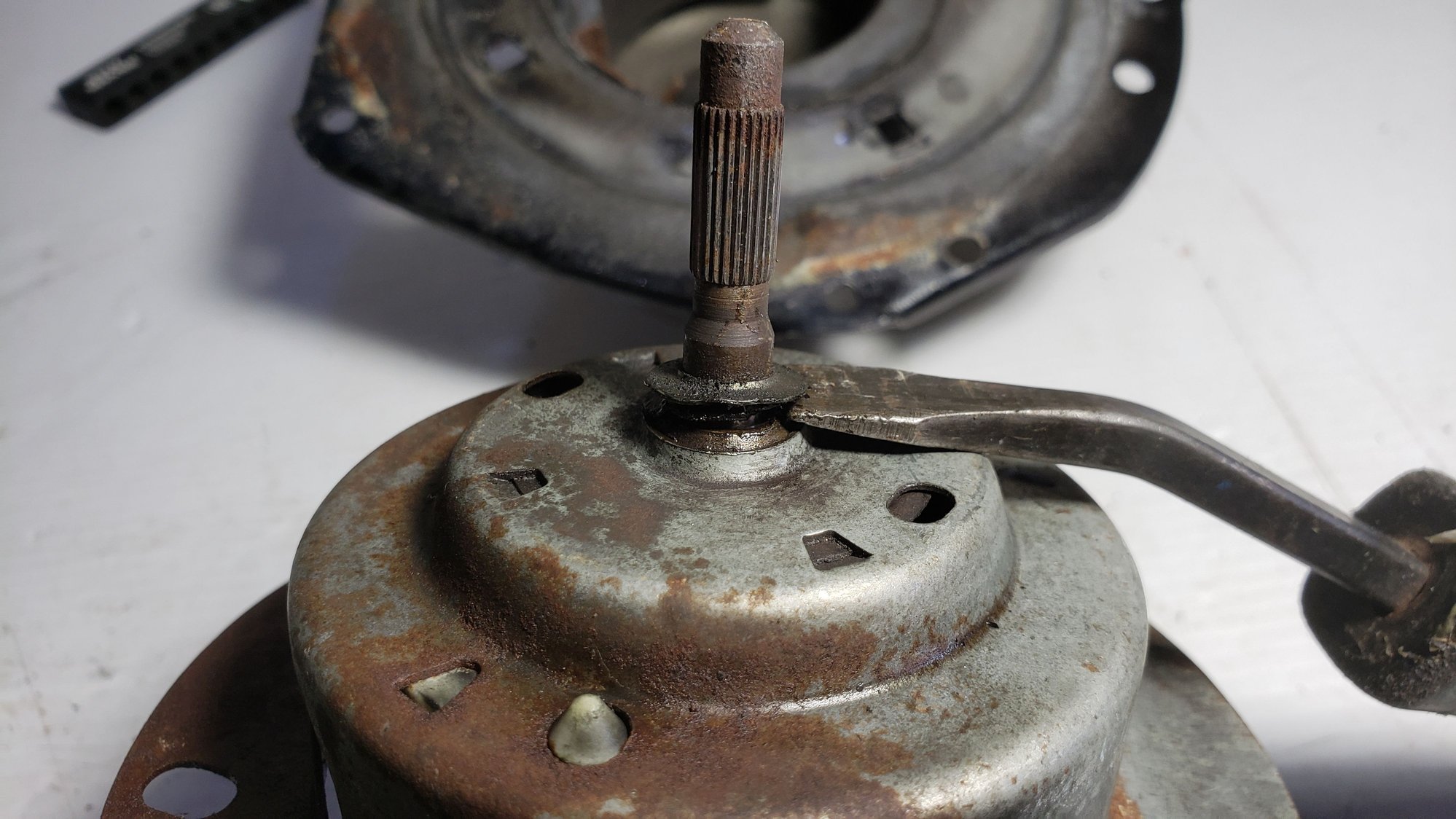

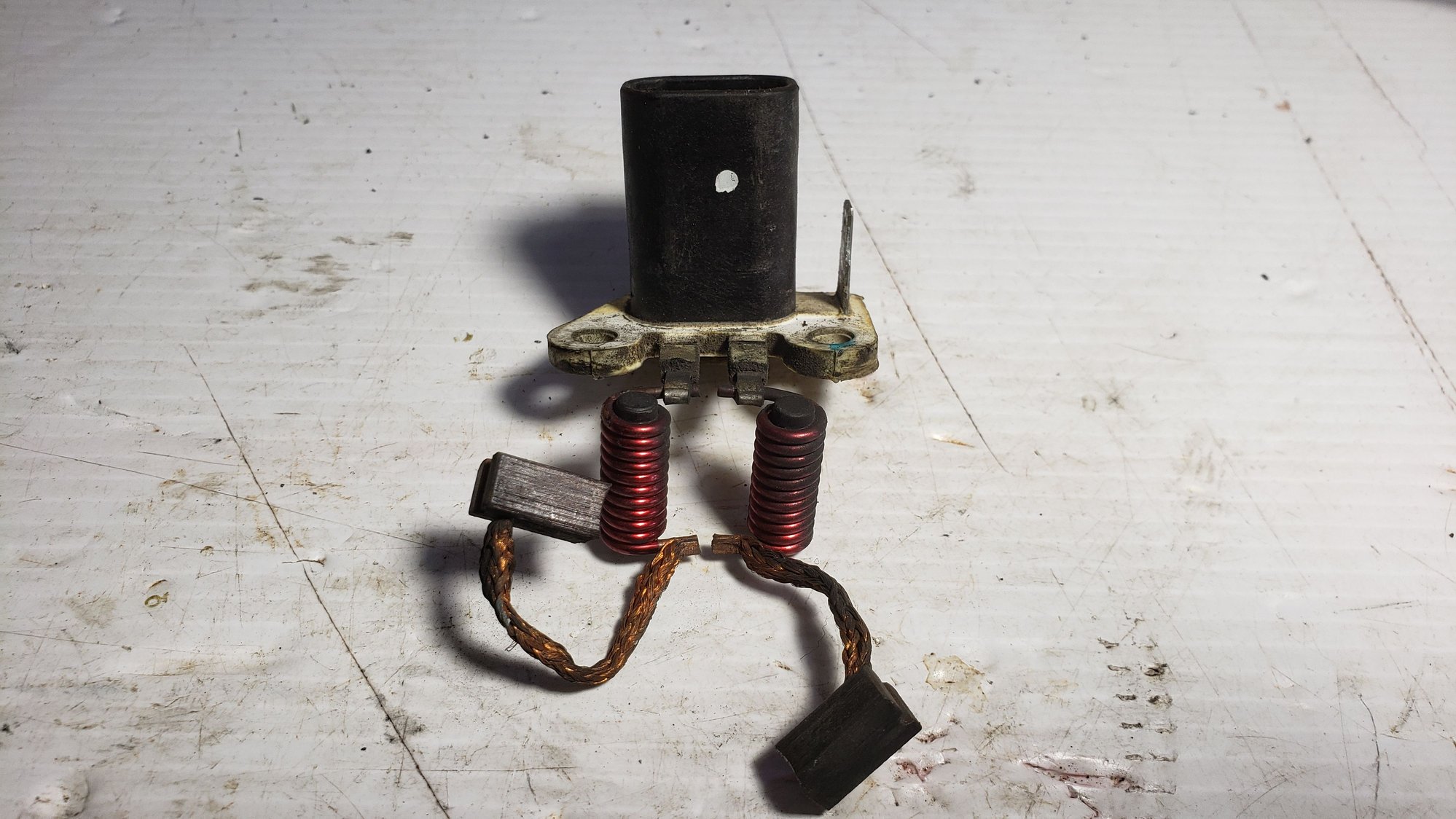

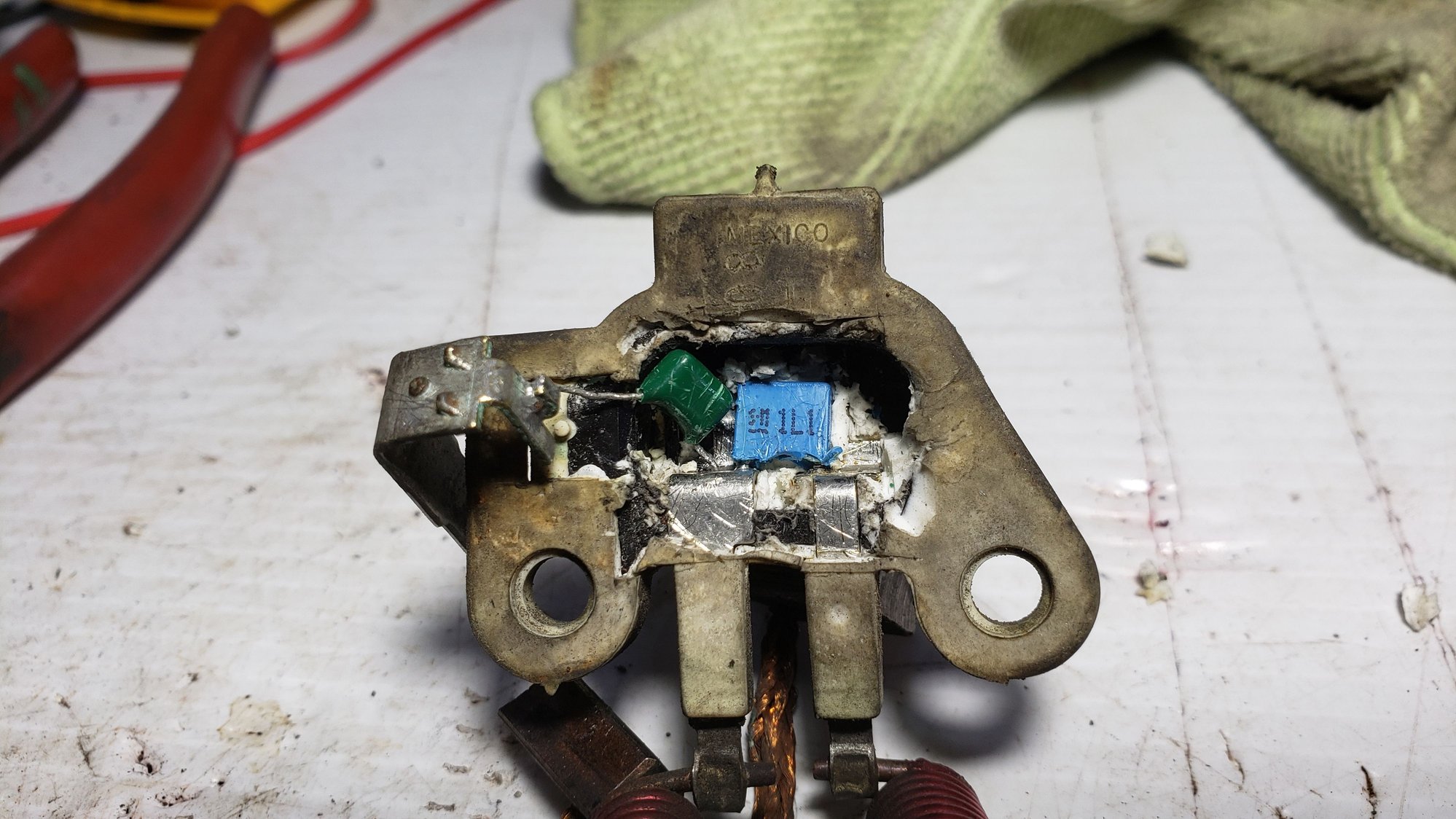

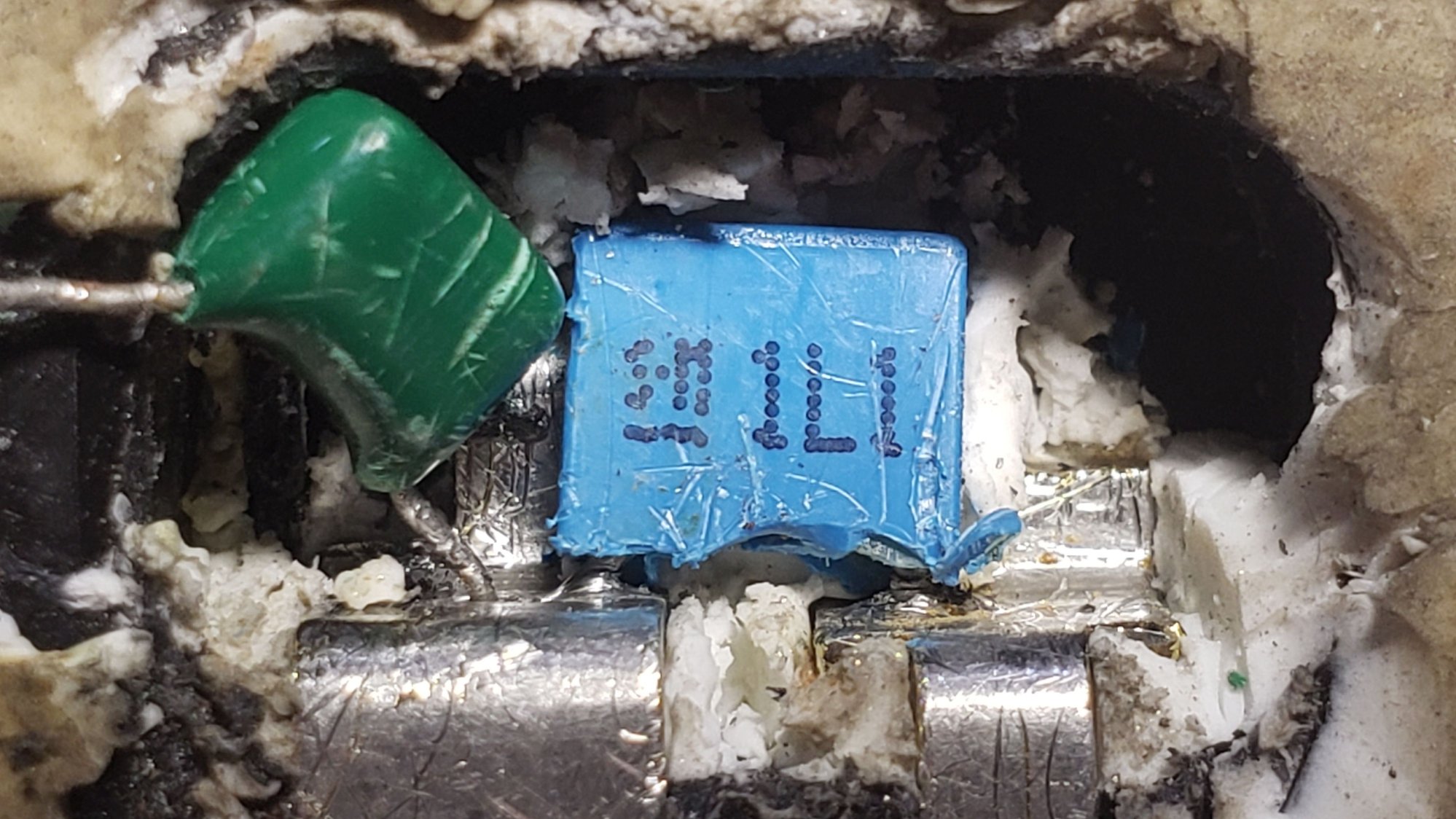

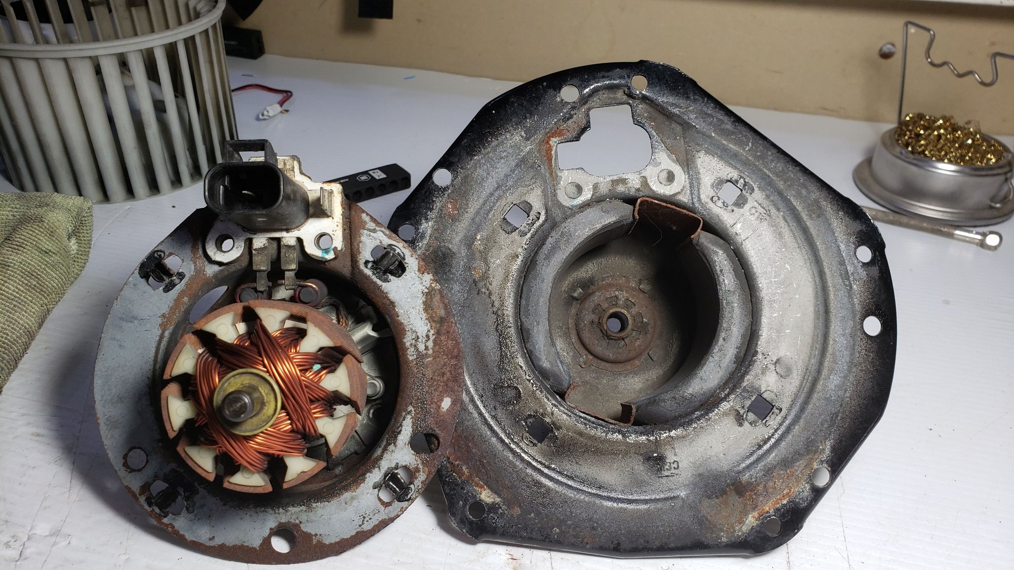

Default I did it this morning, dismantle my blower

I've already changed my blower for the Four Season 35159, so everything seems to work, as usual, the outside temperature does not permit me to use the A/C in real condition. I'm going to rebuild my original blower soon as I have new bushing/bearing made. The shaft is 5/16 (.312) .035 loose on the blower side.
