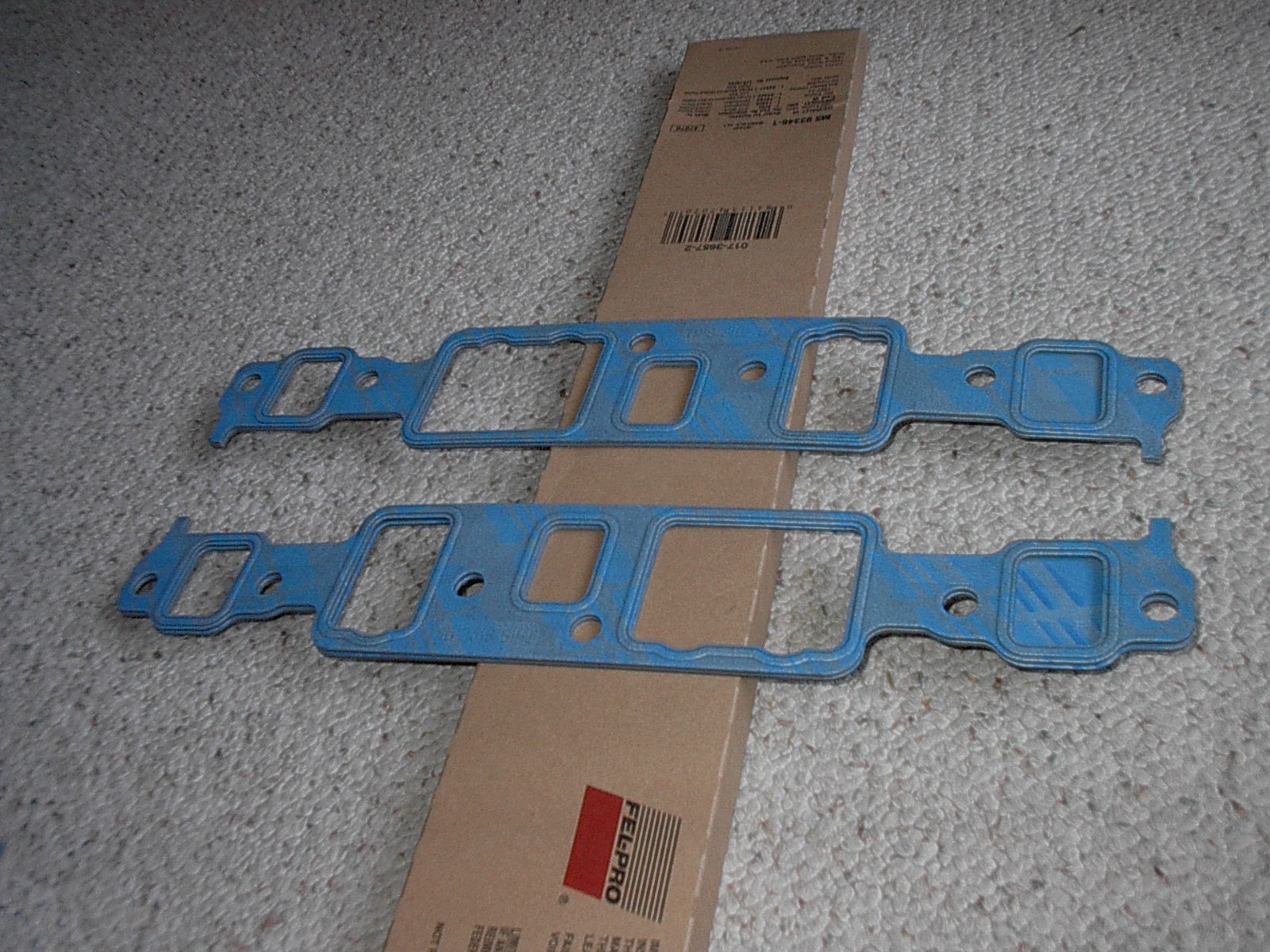

ok i figured out which is the better lower intake gaskets to use for the 92 thru 95 CPI "W" engine... it is the Felpro part# MS93346-1 .... because they have the rear coolant passages blocked off and they have the same size intake runner ports as the felpro MS95832.... so this makes the MS93346-1 ideal for the CPI "W" engines.... i have comparsion pics if anyone wants....or if someone can tell me how to post them here...

#1 here is a picture showing the comparison of the two different part number gaskets layed on top of each other. they are exact except for the coolant passage at the rear is blocked off. its best to use the blocked off gaskets for better sealing around the coolant hole. refer to my post#7 for more details.
#2 another side by side picture...i have many more pictures of you need of these gaskets, just let me know...
Attached Thumbnails Which of these two intake gaskets should i buy?-im003488.jpg   Which of these two intake gaskets should i buy?-im003490.jpg
Old Feb 10, 2010 | 09:19 AM
Posts: 41,345
Yep, identical except for the rear coolant port.
