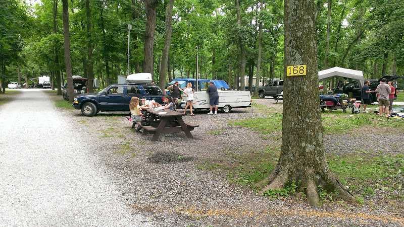

I've done some searching and haven't really found exactly what I'm looking for. I have a 99 Blazer 4d 4wd. My family and I are looking for a camper but I want to make sure I don't buy something that is to heavy for this vehicle to tow. We borrowed a pop up camper this weekend and towed it about 130 miles each direction(house to campground and back). During the trip I kept it in 3rd gear as we were driving on some hilly roads. We were fully loaded in the back with coolers and camping gear, the camper was loaded down to a total of around 1 ton gross weight and we also had a full cargo carrier on the roof rack. I have a scangauge II and had it setup to monitor tranny temp as well as several other temps. We did the trip in 85-90 degree weather most of the way. During the trip the tranny temp varied from 190-220, with the higher temps being when we were going through hilly areas. The previous owner told me the truck had the heavy duty towing package from the dealer which he said included a lower gearing, the wiring, hitch, and tranny cooler(I have not confirmed this exists, I can't see it from the front). I have what looks like the feature list from the bill of sale at the dealer and it lists:
Heavy Duty Trailering Equipment
Rear Axle - 3.73 Ratio
4 Speed Electronic Transmission with Overdrive
I was hoping someone with knowledge of towing with this vehicle could step in and tell me what they think would be the maximum weight that it would be safe to tow with this truck along with some insight into if those temps were two high or if they were ok. The engine temp remained constant the entire trip around 207.
I'm including a picture below fully loaded, dunno if it will help or not.

The factory rated trailer weight is 4000lbs, but if the trailer is a lot wider than the Blazer, I find that the wind drag affects it as much or more than the weight of the trailer. The factory transmission "cooler" is part of the radiator on the Blazers. If you're going to be pulling a heavier trailer a lot you might want to invest in an aftermarket cooler as it will be way more effective.
If you're pulling a trailer that is close to the factory rated weight and have a heavily loaded truck too I'd suggest that you seriously look into a trailer brake system because it will definitely affect your braking distances.

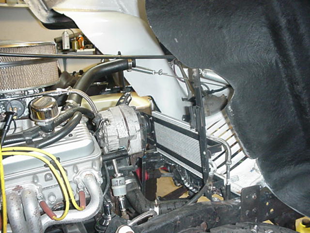

You are talking about a Plate that acts as a heatsink that you add to the belly pan OR it replaces the Pan. We are talking about a trani cooler that it literally a small radiator and it Plumbs into the Transmission lines that run to the front of the vehicle and currently run through the Coolant Radiator..
Here is a pic of one I put on my Jeep. In my case I did not run it through the coolant radiator.
My feeling is tranis like to run ' the cooler the better'. The Jeep has trailered my 20' boat for over 15 years with this setup.
