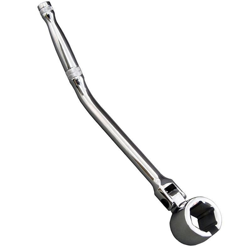

What I have done is spray it with penetrating oil for a few days before I try and if it breaks free run the truck until the exhaust heats up then let it cool until you can work on it but not stone cold and see if it comes out.. Forget to mention tapping the bung with a hammer help the oil work it's way in.
Also an O2 sensor socket and a breaker bar are helpful

Make sure that you use a proper wrench or socket that surrounds the nut near the base. Other things to try are PB Blaster, heat, cold freeze spray, wacking the wrench with a hammer a few times (not too hard) and tightening first before going the other way.
