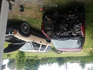

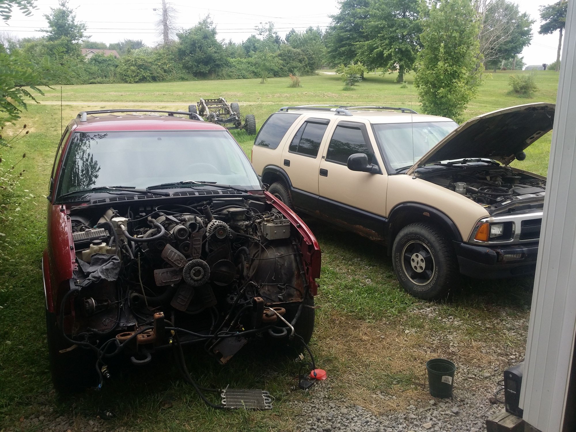

Yes both Blazers have the squid looking fuel injection system. I'm not sure the technical name for that type of fuel injection but it looks like an octopus when the fuel injection system is on the bench.
8th digit in the VIN is both W.
In these pics I will refer to each Blazer with the corresponding colors you can see I have one Red Blazer and a Tan Blazer.
Attached Thumbnails Two 95 Blazers with and without crank sensor?-20170817_130522.jpg

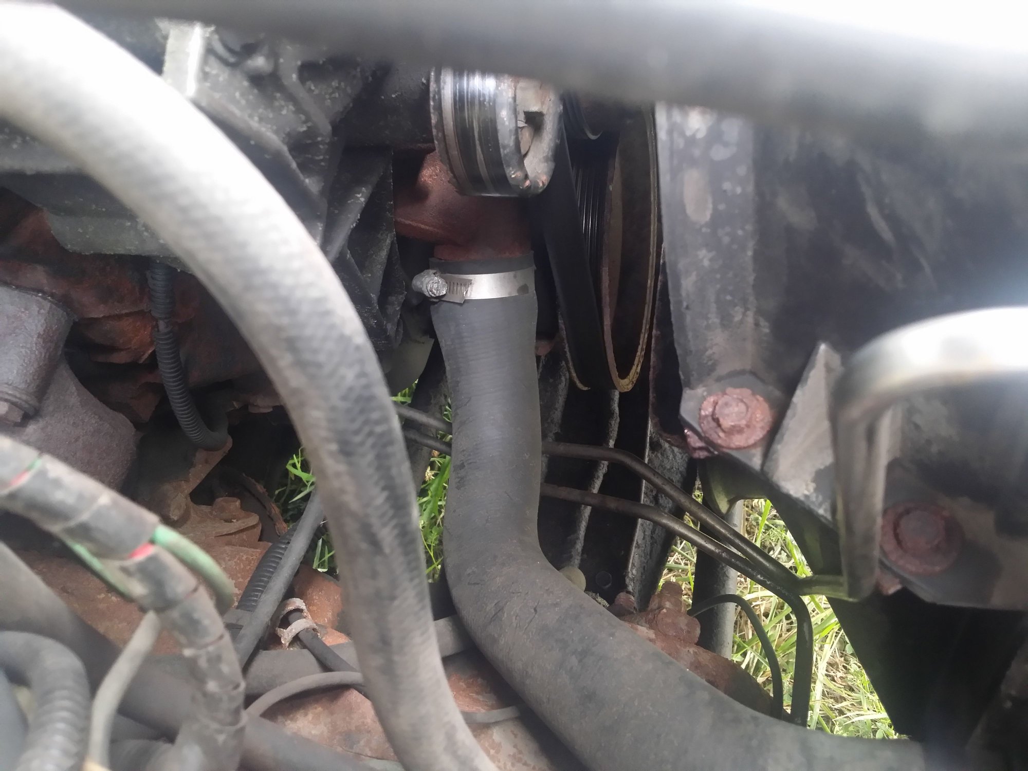

So here are close ups of the red blazer
Notice the distributor wires go on the cap sideways. Red Blazer
Can see the crank sensor red blazer

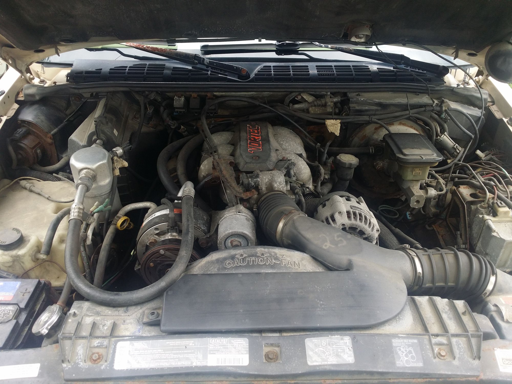

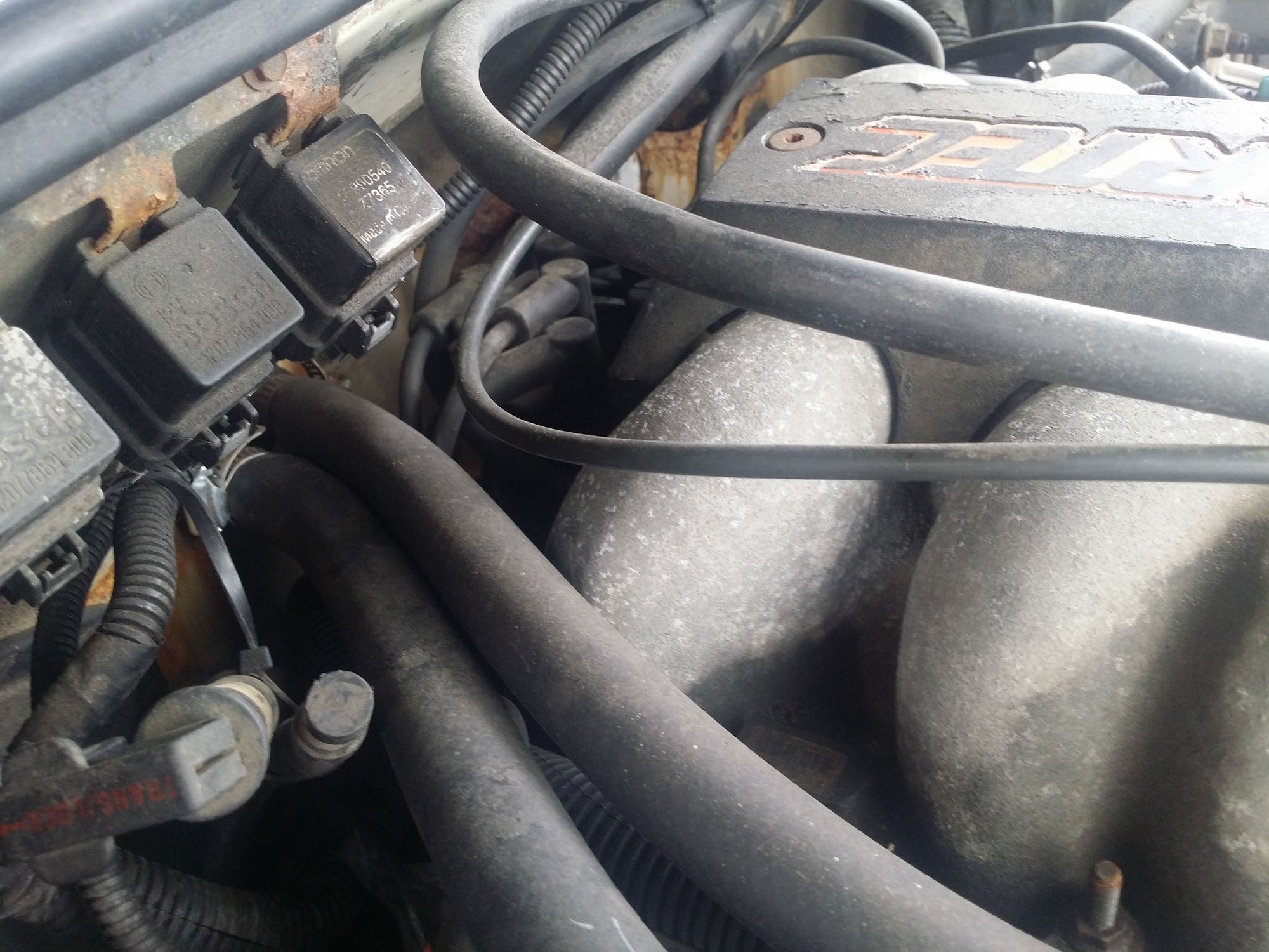

Tan Blazer Pics
Spark plug wires go on the top of distributor cap Tan Blazer
Hard to see but no crank sensor Tan Blazer
Tan Blazer
Tan Blazer
