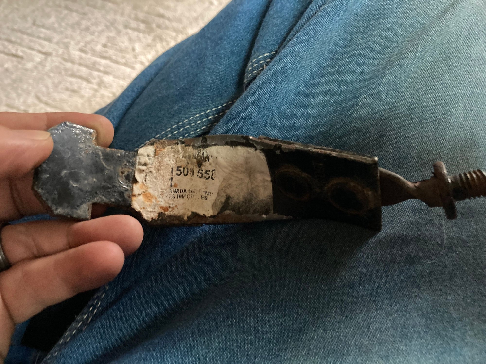

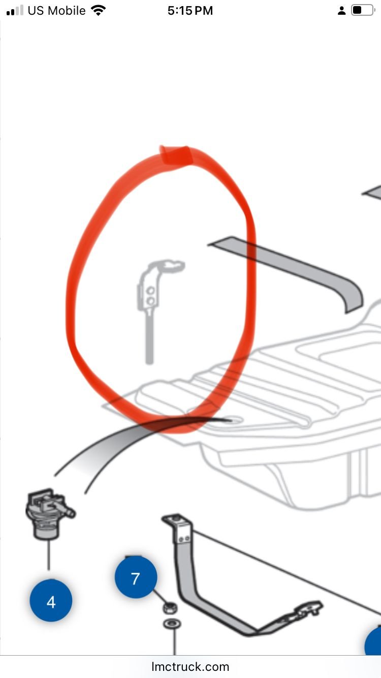

Hello. Working on a 2002 Chevrolet Blazer LS 4WD. I’ve ordered two new sets of fuel tank straps, and they are fine but seem to be missing this piece that mounts the front one to the frame. I found a picture of it in the LMC truck catalog, but it’s not identified. Does anyone know what it is called and how to maybe score one? My wife is a metal fabricator and could maybe fix this jacked up one, but I would rather see if I can get one first before I bother her with it.
LMC catalog shows it here
I bent it pretty bad taking it off.

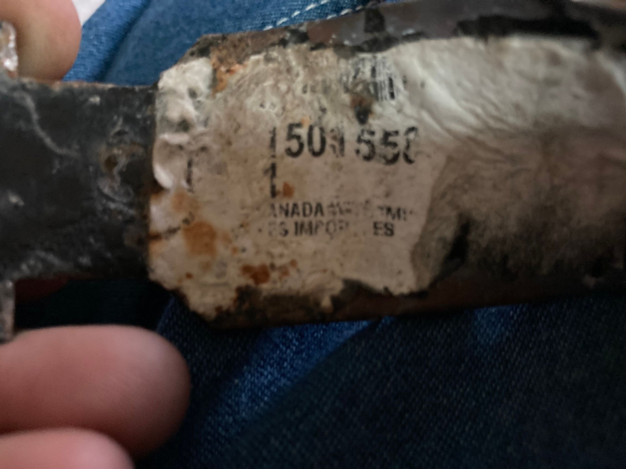

I can’t really make out the number in this label.

I think I found it on eBay. Here is the part number it was saying it was: 15980163
here is the eBay listing of the guy that sells them in case someone else needs them:
https://ebay.us/m/qJzsnD
I bought one and will report back if it works good.

it worked great. Dead on match.
