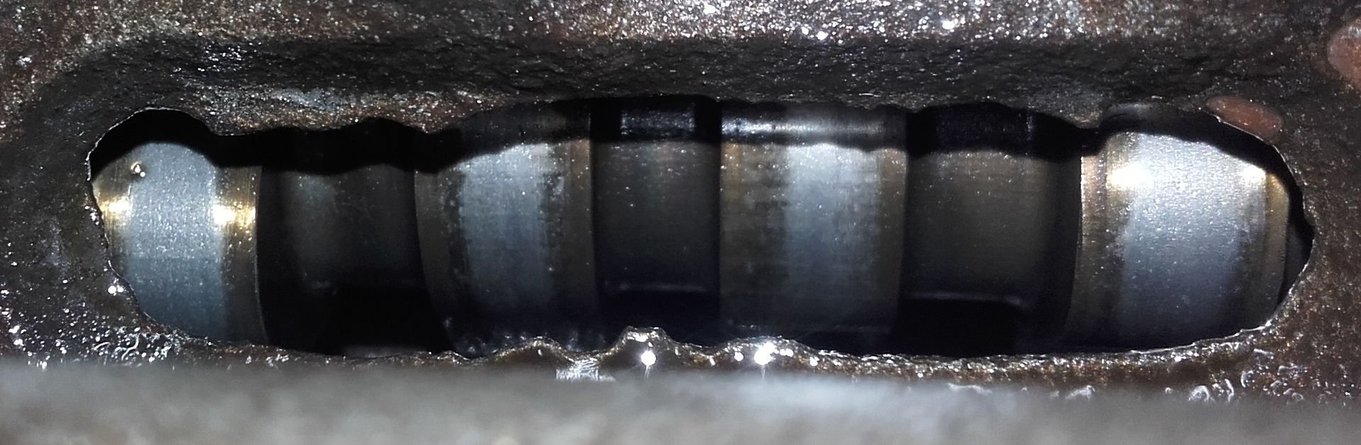

The photos taken of my camshaft:
and a valve lifter. They all look pretty much same:
It all makes sense to me. I had something thick in my oil pan and a worn off bearings with excessive clearance were compensated by a high viscosity. 5W30 was unable to compensate, so the lubrication pressure on idle was gone and it eventually killed valve lifters.
P.S. I got 115k mileage.

I only had 65K miles! Mine had the LIM gasket replaced, but apparently the damage to the engine bearings from coolant in the oil was already done. My camshaft and lifters were not so bad, but still one was collapsing from low oil pressure.
Time for engine to come out unless you're going to put 10w40 in it and try to sell. Pull #1 rod cap and main cap and check bearings - I bet these would be the worst as they are furthest from the oil pump and would starve for pressure if others are getting loose. You may want to evaluate scoring in lifter bores before spending any money on that block.
Unfortunately none of this is a good outcome for a new owner. Crank kit + camshaft and roller lifters are pretty big expense in an engine with old rings and valves. If you want to keep vehicle you might want to check into another engine or even a rebuilt. Not sure how much it takes to import but Jegs has complete GM Goodwrench engines for about $2000USD. I have no way of knowing what would be best for your situation, given your location.
