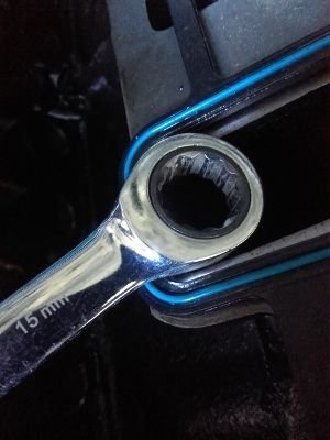

I went for a flat spanner with ratchet. It took me 10-15 minutes and $8 for the spanner Posting a photo, maybe it's gonna help someone in future.

Good!! The driver's side top bolt is usually fairly difficult! But now go for the next one down (behind the accelerator pedal). On mine the body was too close to get to it and/or get the bolt out even if loosened. I pulled the carpet up and zipped a little 2" x 2" flap in the cab floor behind the accelerator pedal with my Dremel cut off wheel - then bent it up to get at the bolt. You can drill through the floor with a very small drill bit (multiple times if necessary) to locate exactly where the bolt is, and where the flap needs to be cut. When finished I bent the flap back into place and sealed over it with duct tape. I was able to leave transmission and transfer case and crossmember and front axle and the body mounts in place (which is really a big time saver).
