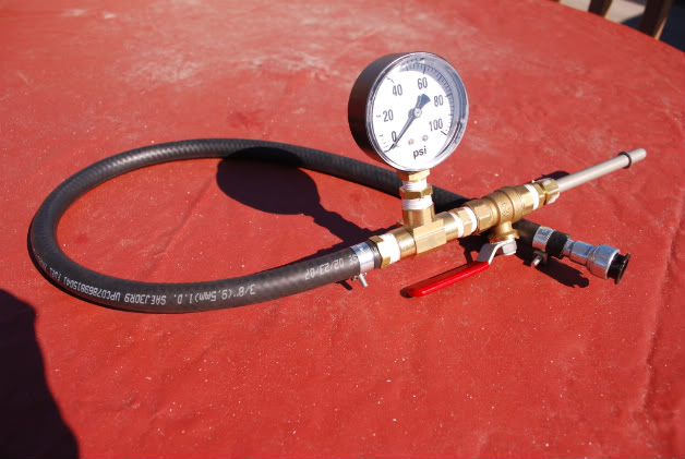

The 800-121 connects to the fuel filter outlet.
The 3/8" fuel injection hose connects to the 800-121 using a clamp.
The 1/4" MFL X 3/8" hose barb adapter connects to the other end of the 3/8" fuel injection hose using another clamp.
The fuel pressure tester connects to the 1/4" MLF adapter.
If I had a picture of it, I'd post it I have the adapter somewhere, but I never use it. I made a different set up that connects inline at the fuel filter outlet. Substantially more expensive to build, (~$60) but it checks regulated pressure and leakdown, along with pump max output pressure and leakdown, and you can run the engine while it's connected.

that picture did help thank you!
im going to have to order the dorman 800-121 via amazon
will this work for the hose barb adapter?
Tru-Flate 21-143 1/4 Tru-Flate 21-143 1/4" NPT Male Fitting x 3/8" ID Hose Barb Type Fitting: Amazon.com: Industrial & Scientific
as soon as i get the ok from you, i will order it and hopefully itll make it here saturday

Dorman 800-121 is very easy to disconnect when you're finished.
Dorman Products - Search Results
Dorman 800-082 can be used a a substitute, (at a cheaper price):
Dorman Products - 800-082
A good auto parts store will have both of them in stock.
The fitting in your link is 1/4"NPT x 3/8" hose barb and will NOT work.
You need 1/4"MFL x 3/8" hose barb. Here is a link for what you need:
SS 1/4 MFL x 3/8 barb

The 800-082 is cheaper, and it will work fine, it's just a little tricky to disconnect, (need the tool). Don't go cheap on the hose or clamps. It has to be marked "fuel injection rated" on the side of the hose. Don't use the "worm gear" type hose clamps, they will cut the hose and leak.... not a lot of fun having 100psi fuel squirting everywhere. Use the fuel injection type clamps.

The connector that you have on the vehicle now, is in fact an 800-082. The 3/8" fuel injection line that you buy will go onto the 800-082 very tight, probably need to lube it first. Make sure it goes all the way on, then clamp it.
The clamps that come with the Actron are worm gear, don't use them. Use these: Autocraft 3/8" Automotive Fuel Injection Hose Clamp (4-Pack) AC52F16V: Get the best Hose Clamp at Advance Auto Parts
