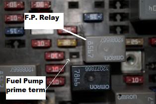

Remove the plenum & reconnect the fuel pressure and return lines. Remove the nozzles from the lower intake manifold. Activate the fuel pump and check for leaks at the regulator, the fuel injector metering block, and at each nozzle.... everything should be bone dry while the pump is running. Post your results. On your 2000, you can activate the fuel pump by applying battery voltage to the pump prime terminal located in the underhood fuse panel.

to apply battery voltage to the prime terminal, do i use a jumper to another fuse outlet?

Toward the front of the underhood fuse panel, there is a stud with an 8 gauge red wire, jump from there to the pump prime terminal and the pump will run continuously while the jumper is connected.
