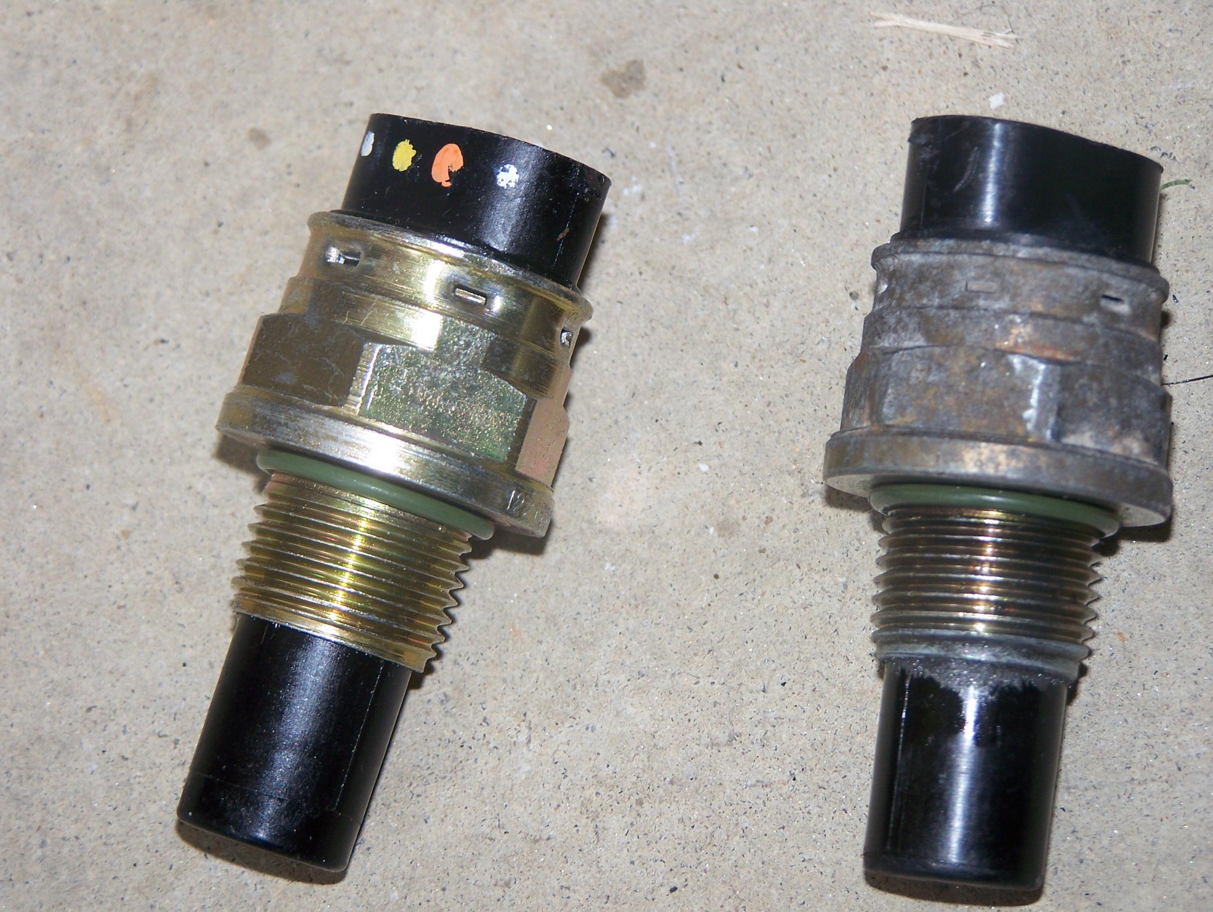

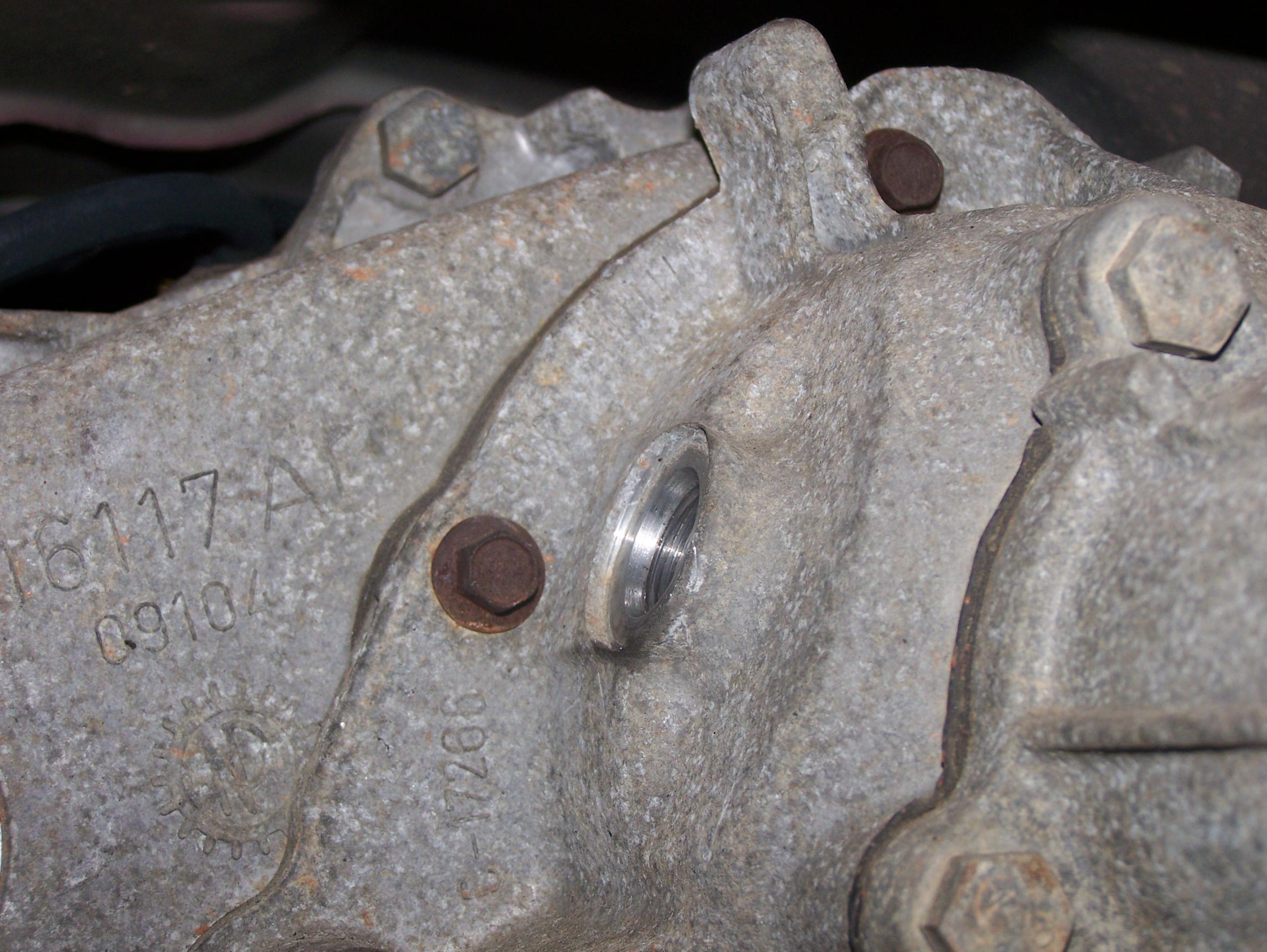

Where is the speed sensor on my 2000 chevy blazer? I have a HAAYNES REPAIR MANUAL and can't find it in there anywhere..........HELP

2wd, it is in the tail housing on the back of the transmission.
4wd, it is in the rear output housing on the back of the transfer case.

thnks, does it require any special tools or anything? what does it look like?

I dont know where to post this maybe an administrator can help out...............there are pics of the VSS and pics of its location on my profile BIG-RED
