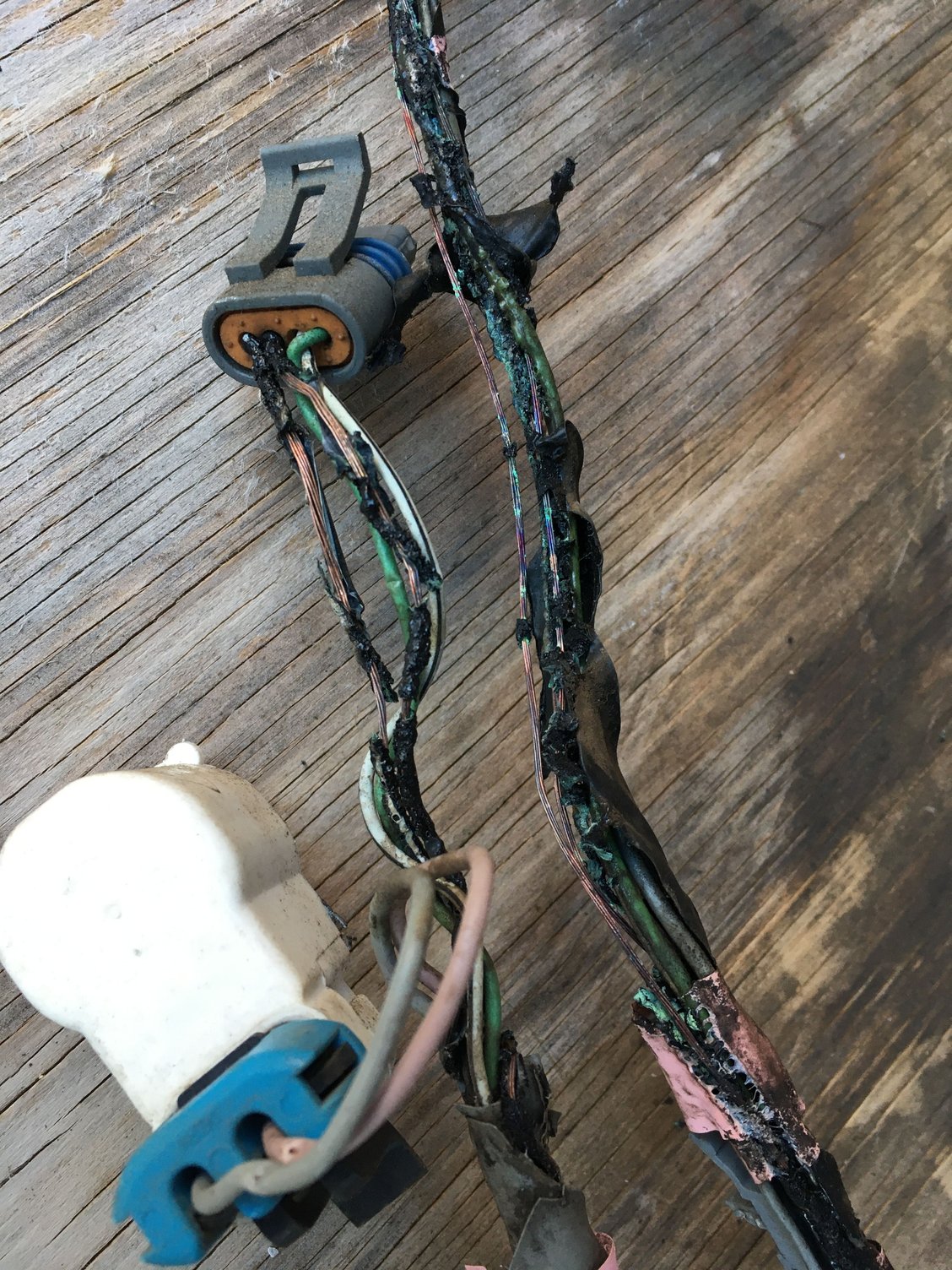

Well I got into it... all the wires to the drivers side actuator are burnt completely... as those wires merge with the next group of wires from the switch. some of those are damaged all the way though to the cab... Crazy thing the 15amp fuse never blew... Other than the door locks every thing works ( today )
Wondering if I could... Replace the door harness... seal up the section that goes into the cab... Re-tape what I can.... or?
Leads to dash side fuse box area
Only one is melted here

Wow that is a mess. Did the door damage the wiring harness or did they damage it during the door replacement?
