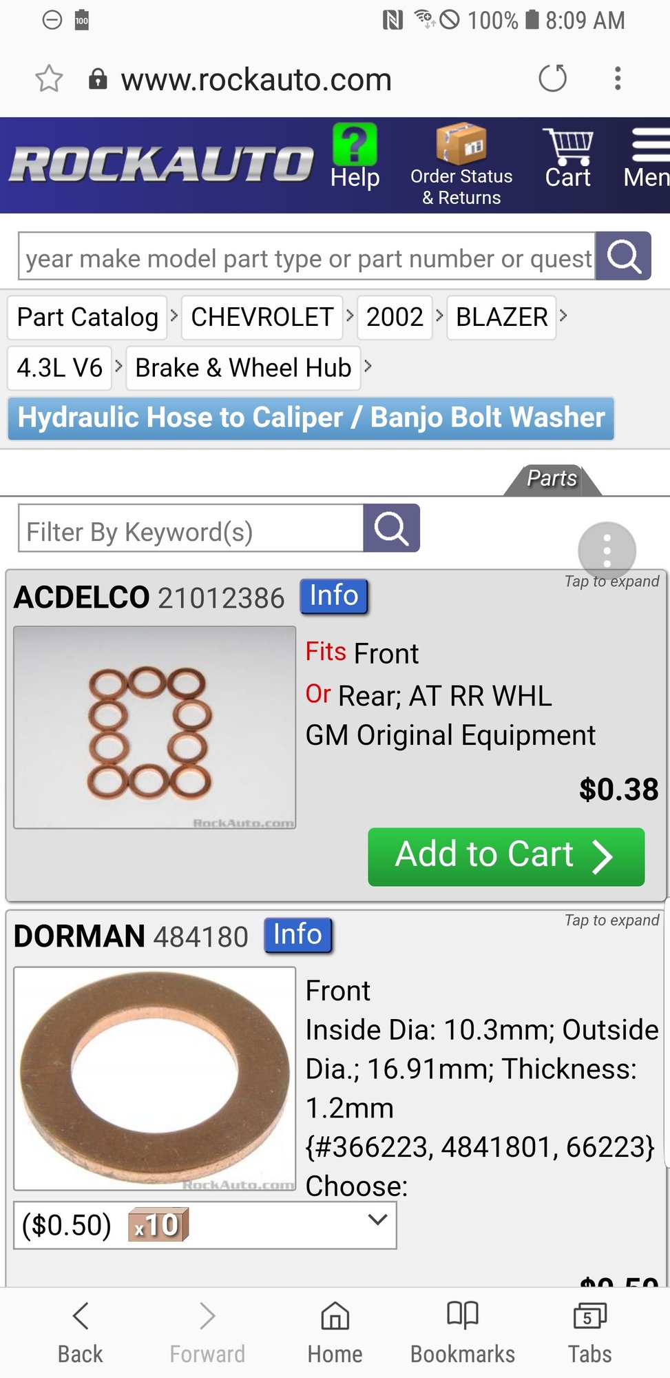

Make sue that you have a copper washer on both sides with clean surfaces. If that doesn't solve the problem anneal the washers with a propane torch (bright red) then 400 grit to get them shiny and flat and you'll be good.

Will do. Thanks!
Old Nov 13, 2018 | 06:52 AM
GreenBlazer2002's Avatar
Joined: Oct 2016
Posts: 605
From: Thomson, Ga.

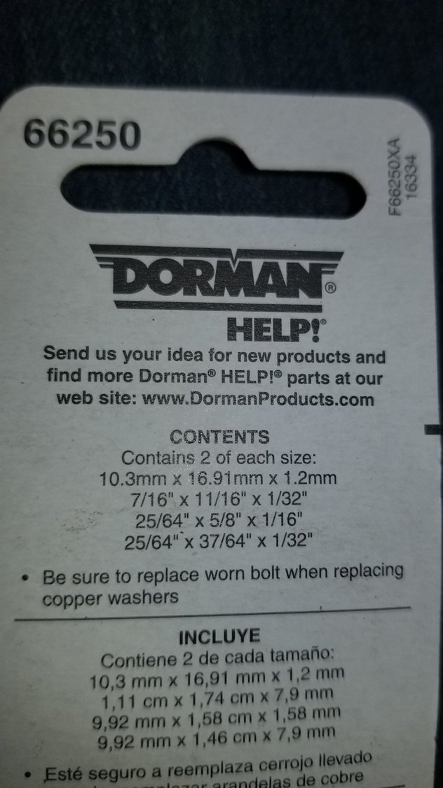

Doh! Just read this. Ordered new ones.
Old Nov 13, 2018 | 07:11 AM
Joined: Oct 2016
Posts: 605
From: Thomson, Ga.
found a pack at O'Reilly with 2 of the size I need to get me by in the meantime.
