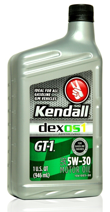

Changed the oil and oil filter today so now i am sure that oil viscosity is correct
I used Kendall GT-1 Dexos 1 5W-30 oil and a new Mann oil filter
Attached Thumbnails What kind of oil viscosity do you use on your 4,3 l V6 Vortec engine?-kendall-gt-1-dexos-1-5w-30.jpg
