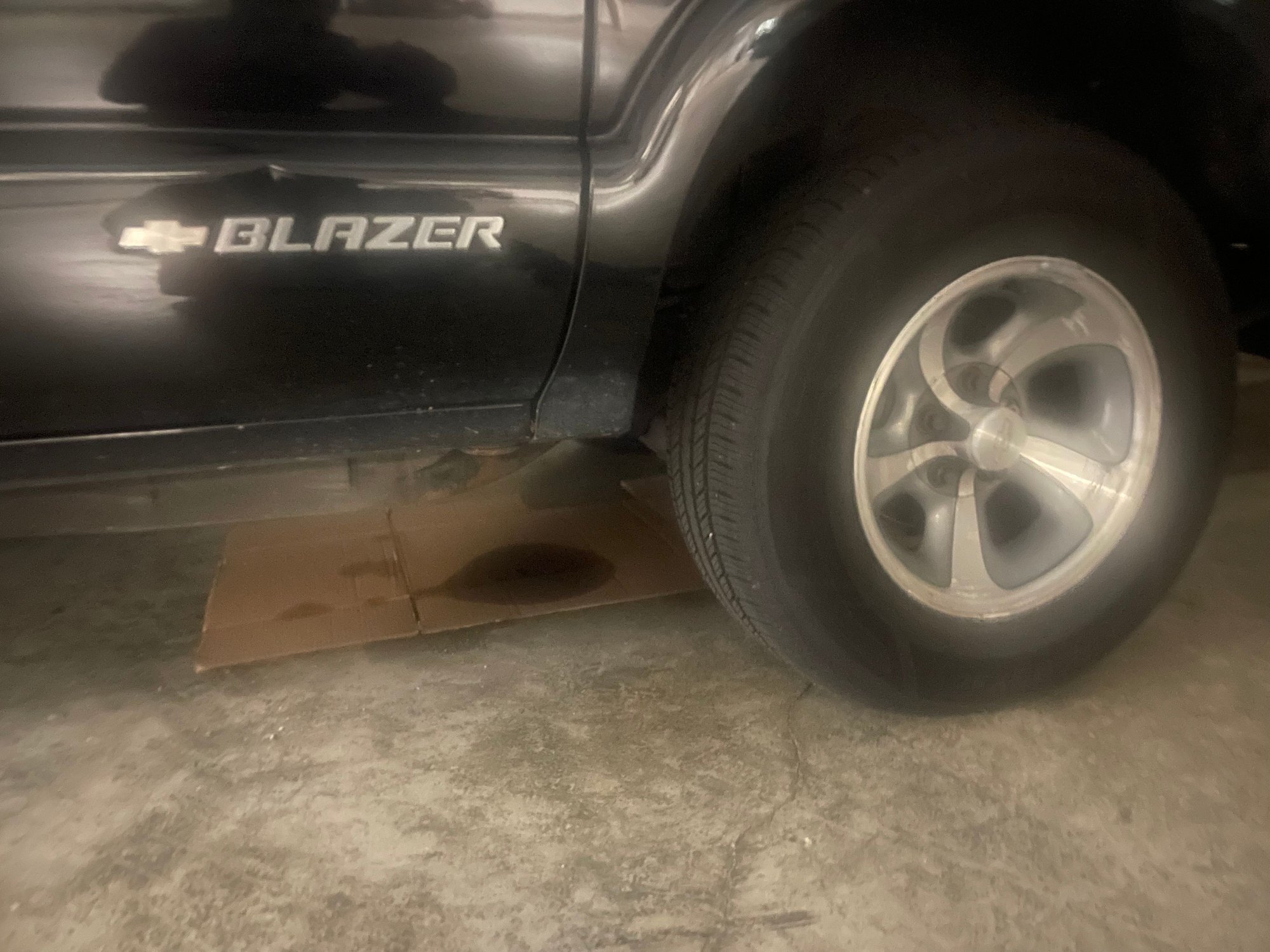

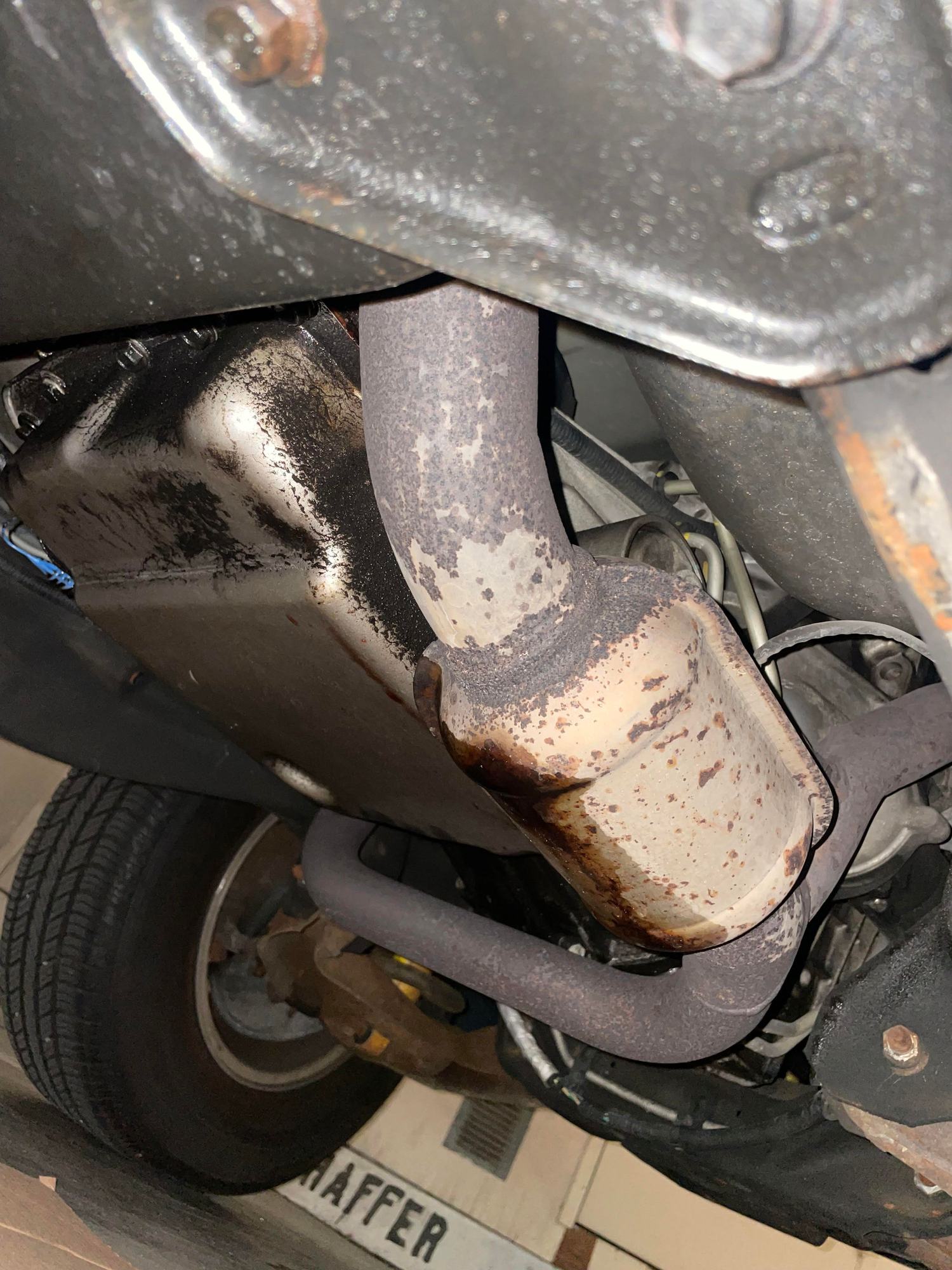

there is a fluid collecting on the bottom of my precat and burning when driving. is this fluid automatic transmission fluid?
oil coolant lines replaced by the dealer with OEM GM oil lines and the bottom (including precat) was subsequently washed 200 miles ago
dealer recommended noted somewhat of a transmission fluid leak and replacing the automatic transmission gasket.
or is this an oil leak? what am i looking at here?

Was it the engine oil remote cooler lines that were replaced or the transmission cooling lines thst were replaced. The engine oil lines are on the driver's side whereas the transmission fluis cooler lines are on the passenger side.
I would guess that it is more likely a leak of transmission fluid.
If there is enough of the fluid to have a few (unburnt) drops, dabbing them with a white paper towel should allow you to see the color of the fluid. If red, it is transmission fluid.
The transmission cooling lines although metal, can wear through if there is metel-on-metal contact. I was able to catch where a sharp corner on the iderlet arm bracket almost wore through one of my transmission cooler lines because of that.

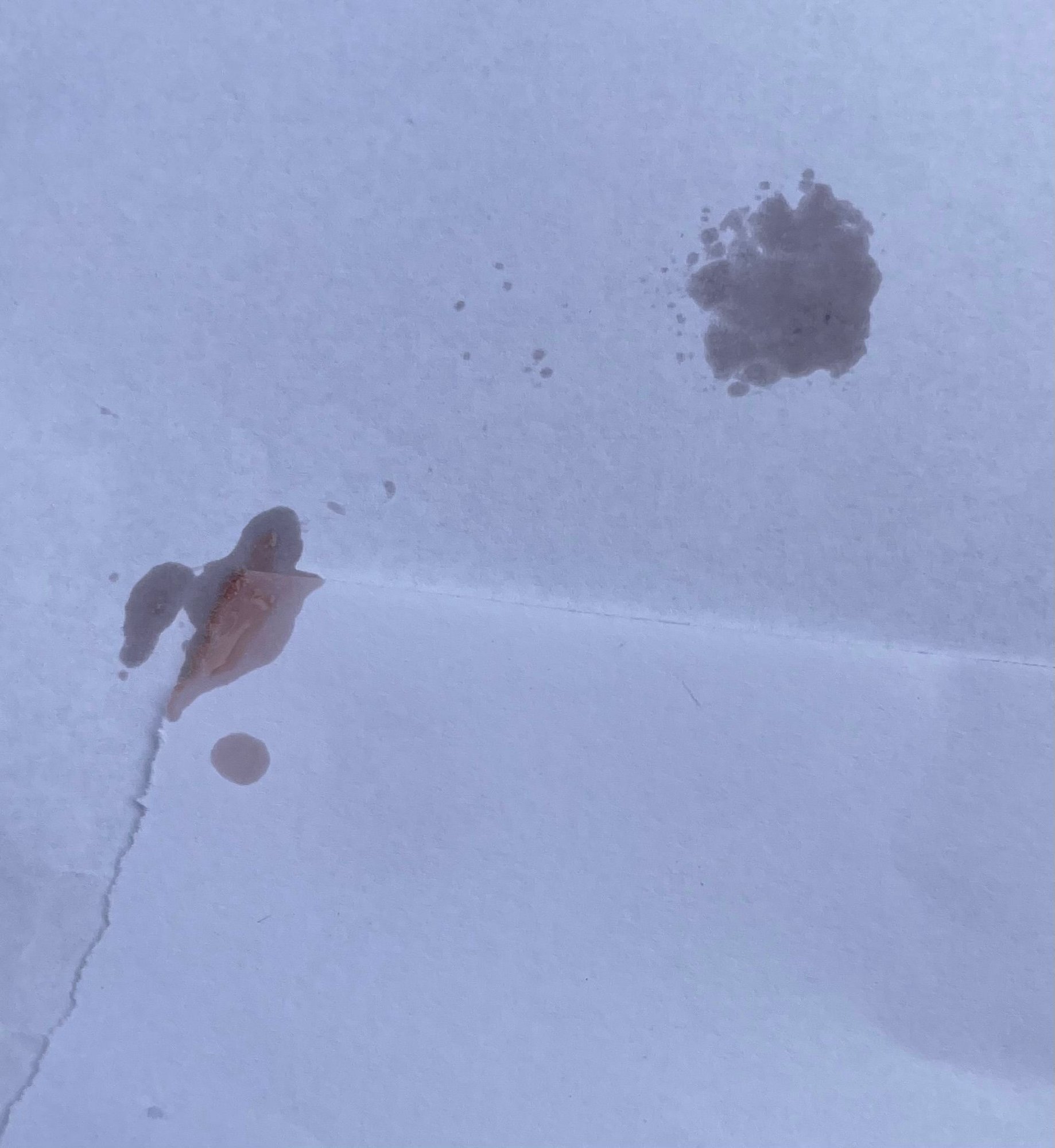

Wiped it with white printer paper, this is photographed in full sunlight. The left spot is directly from the precat, the right spot is wiped on the carboard below.

The fluid at the corner of the paper looks reddish. If it is, that is not engine oil and is most likely transmission fluid.

Yep, I think it is transmission fluid.
Edit: I spent some time moving a flashlight around. I see no wetness on the transmission coolant lines and no obvious mechanical defect.
The bottom of the automatic transmission pan has reddish drops of fluid on it. The side of the precat closer to the automatic transmission pan is wet.
So I think this is the automatic transmission pan gasket.
