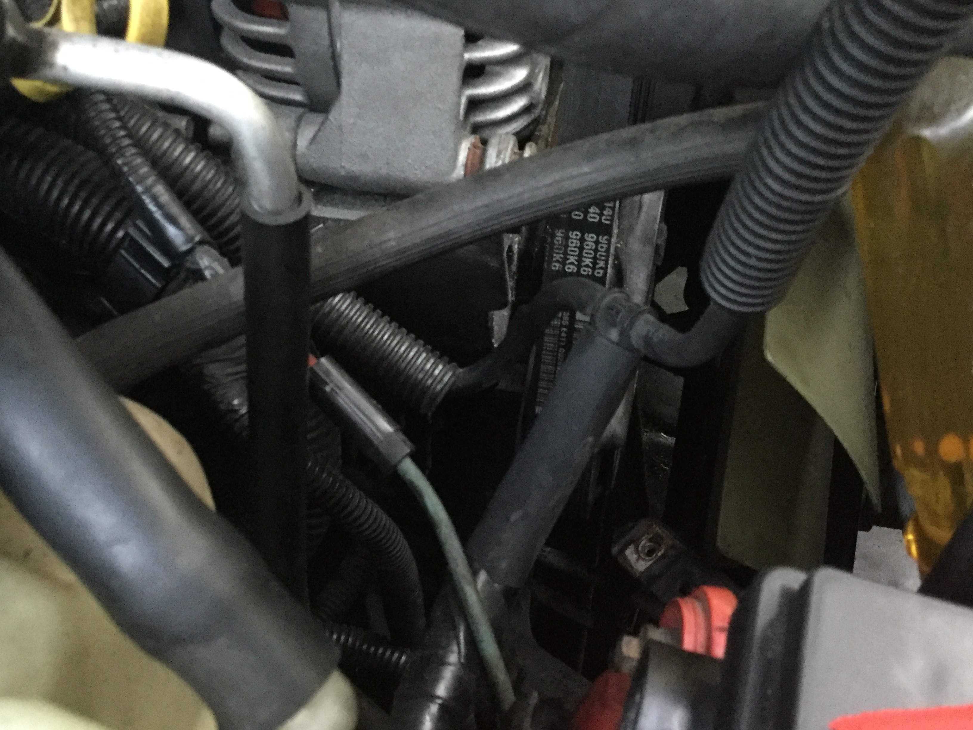

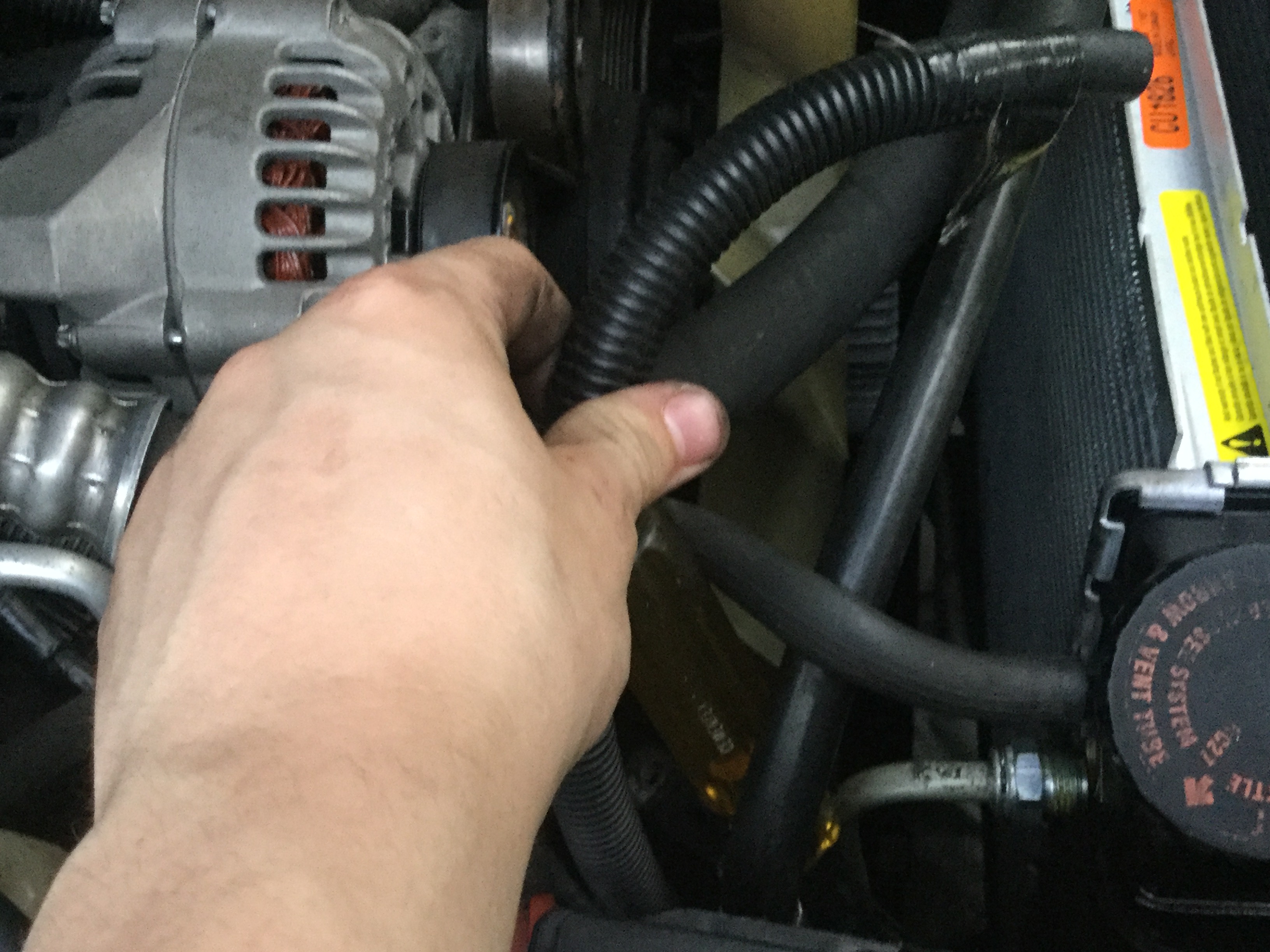

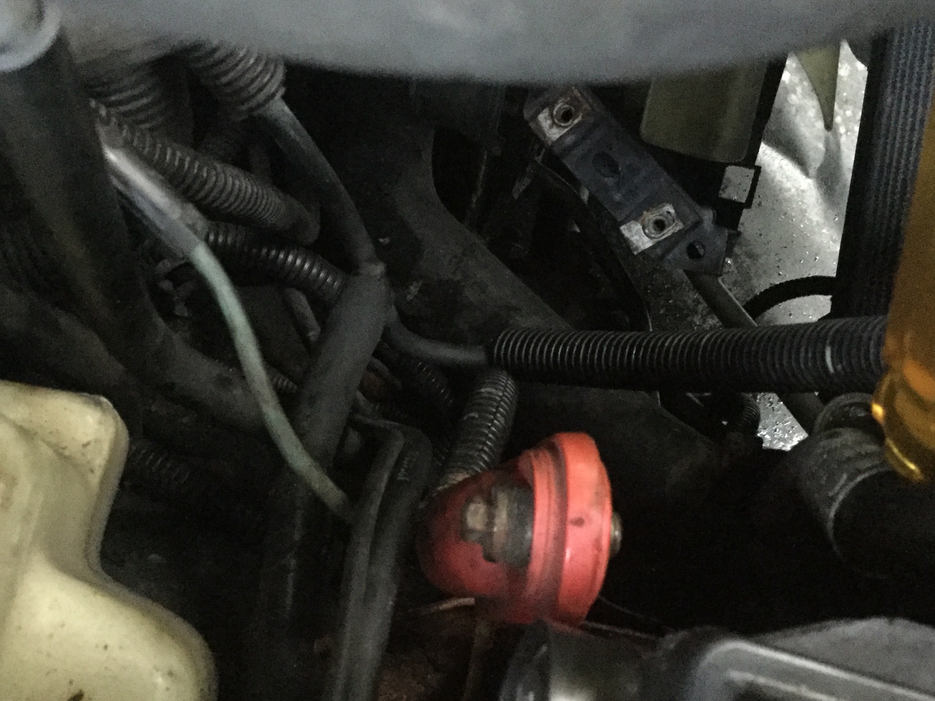

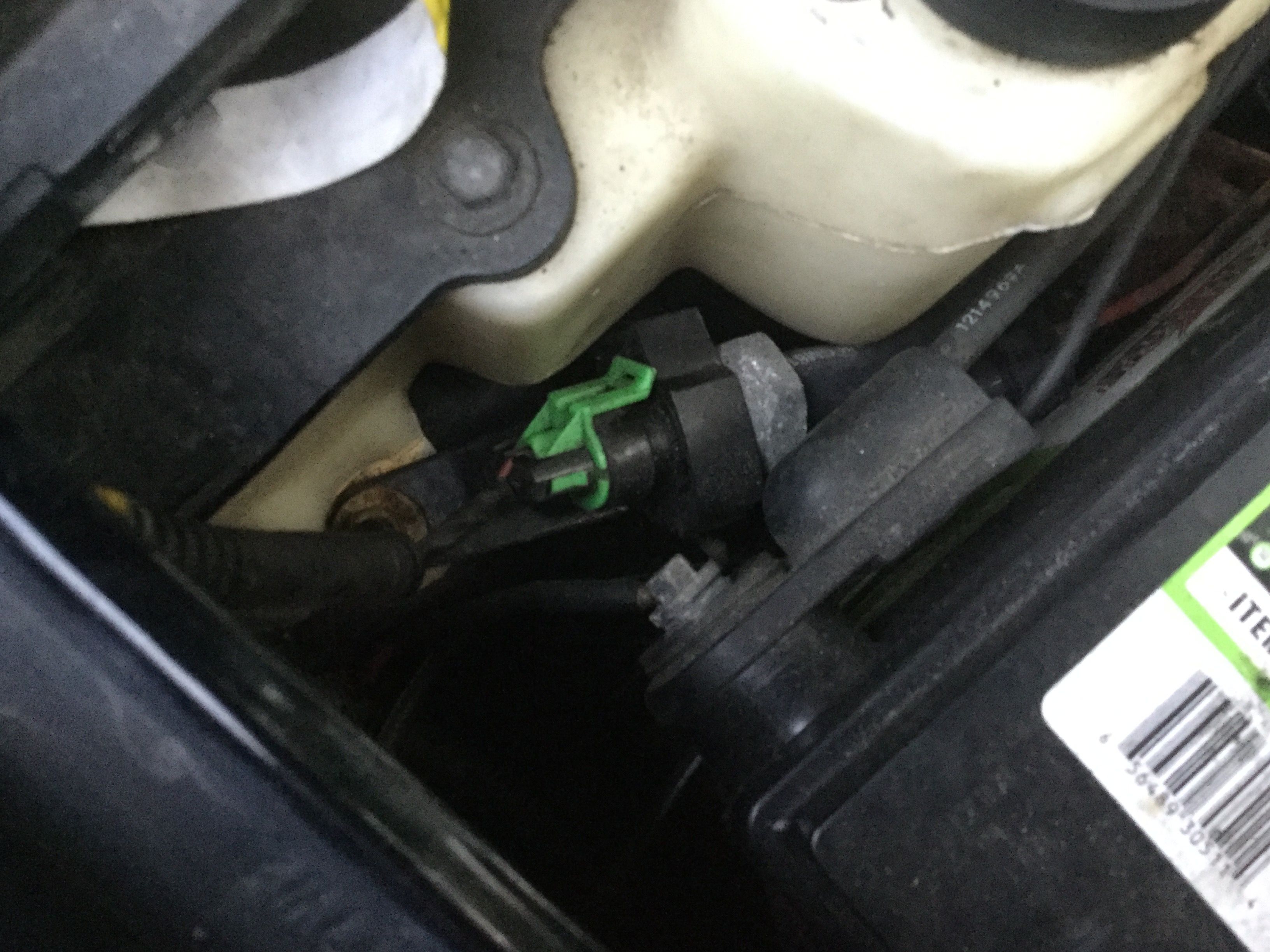

After doing the intake manifold on my 96 4 door, I notice one hose wasn't connected, it comes from a lime green connector by the coolant overflow tank and is by the radiator, but I can't tell where it plugs in, please help!

The green connector doesn't look familiar to me, but I believe that hose goes to the vacuum actuator for your front diff. Its under the battery tray

yep i would actuator under battery. you`ll most likely have to remove batter and tray to access
