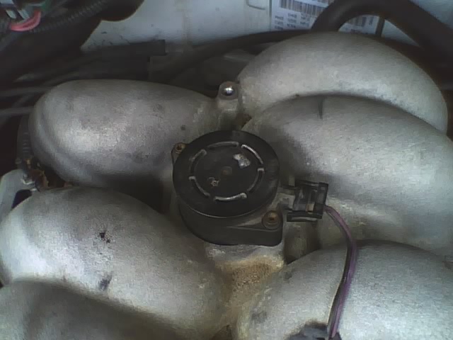

hey guys im new here could use some insight on what this part is thanks

Thats the IMTV or Intake Manifold Tuning Valve. What it does is really for performance. It opens or closes a paddle in the center of the manifold allowing the intake to either act as a 180 degree manifold or 360 degree manifold. During cruising its normally closed and the manifold acts a 180 degree manifold for economy. But under acceleration it opens the paddle and allows the manifold to become a 360 degree manifold for performance.
at least i was told that.

hey thanks thats what i needed to know
