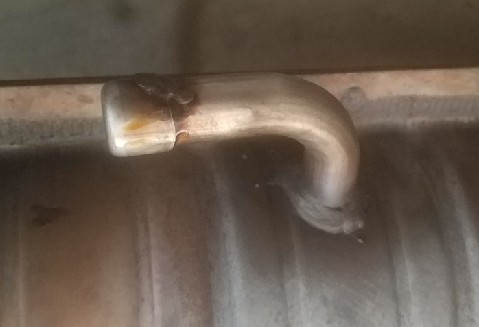

Seems I am on the right track to resolve my white smoke issue... I found what appears to be proof tranny fluid is getting to the combustion chamber. The engine vac source at the back of the manifold is sucking fluid through the (bad) T-case vac switch. The proof came while while surveying what's needed to drop the T-case. I see a mount arm on the cat that appears to be leaking what looks like tranny fluid. it fairly clean now after my fingers wiped it off...I guess this mount arm is hollow and goes inside the cat? Seems weird to me as this would be a lot of heat for a rubber mount, but there is no other place tranny fluid can get to that arm. Also, the cat is mounted upside down, so this arm isn't used as a mount anyway.
So far, the T-case vac switch, vac actuator, and vac lines have been replaced. The vac actuator was so bad the post just flops around. Vac ball also full, so I flushed out really good with hot soapy water. Next step is to resolve the well documented T-case seal issue, which is obviously the source of the fluid throughout the vac system.
I'll update again after the t-case is back in. Not sure if the tranny fluid has ruined the cat, so I hope it will just burn out. Side note, between this issue and the previous leaky regulator, maybe this is why the cat is mounted upside down and the paper work shows previous owner replaced the cat twice in 3 years...

That "arm" is a pipe that introduces air into the cat on some applications. Yours doesn't require it, so it's capped off.
