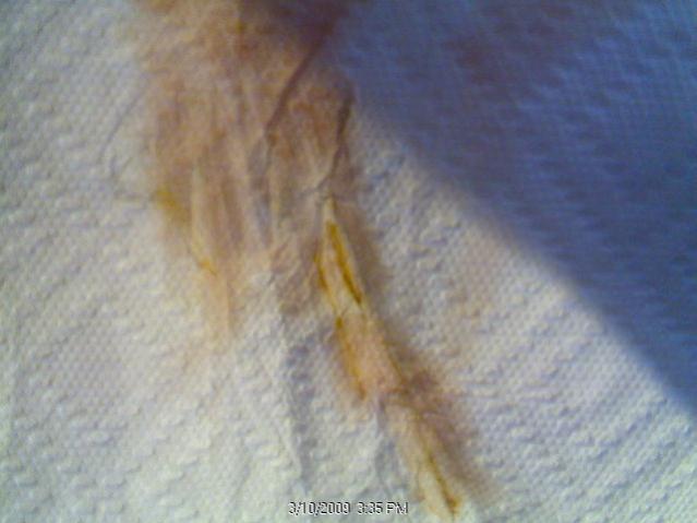

This is going to sound really weird about the 4L60-E. When I got home from school today, I accidentally overshot D and 3 when I got back into the car after getting the mail and was about to go up our steep driveway. I accidentally shifted into 2 and I gave it gas and got very little response. It moved forward SLOW at higher RPM, which I thought it was in 2nd gear (isn't it supposed to go 1-2 in 2????). I put it into 1 and it went up the hill as usual. I tried again in 3 and D and it did it okay and seemed like it was in 1. It seems that if it is in 2, it is starting in 2 because it is not shifting and it feels like it IS in 2 when I got it in 2. Did I break my 2nd gear??? The tranny fluid is red and looks okay, but there is a little residue. The car seems to drive okay, although since there is so much traffic, i couldn't accelerate at a steady enough rate to count the shifts. Also, there are no codes in the computer. We had to get a new solenoid on the tranny one year ago because it was shifting rough(repair bill says "K6353 Solenoid, pressure control replace"). It still shifted rough for another 6 months until I found a loose connector on the PCM, reseated it and had no problems since. They replaced 6 quarts of the ATF at the same time with DEXRON VI. The car has never given me this type of problem before. PLEASE tell me i didn't blow my tranny!!!! Please see the photo of the fluid. I don't know what it could be. It seems to be starting in 2nd with it in 2, but 1 works in 1, 3, D.

If changing the filter helped, you are living on borrowed time. The only thing that plugs up a filter is transmission parts...
I have nothing to base this on as far as the s-series vehicles go, but I know that there are some vehicles that when put into '2' will lock in to that gear to allow for a 2nd gear start. This can be useful in slippery conditions where too much torque multiplication would result in wheel spin.

The car seems to drive okay, though. If I have a flat, straight road, I can count 3 shifts(1-2 and 2-3 at around 2500-3000 rpm to 1500 rpm if I really put the pedal down, and 3-4 is barely noticable, with only up to a 500 rpm reduction) before 45-55 mph (all four gears in OD) depending on throttle. No check engine light or codes on the computer. The only time it really goes crazy is when I push ACCEL on the cruise control to accelerate if I am going like 60 mph and it takes it 700 rpm away from the redline, so I only accelerate using the pedal with the cruise on. I hope that Aamco can check it out when they drop the pan. I asked them to drop the pan, change the filter, put it back together and do a complete flush. If the transmission is seriously close to failure that is surprising news to me because I don't even race or abuse it. I have only towed a trailer once, and it was so light I could move it with my hands unassisted and I used gear 3 and only did 30 MPH on rural roads! Unlike alot of people who do burnouts and drive reckless on school grounds where I go to school, I don't even approach over 3500 rpm unless I am merging onto an interstate and I got to do it "NOW". My friends say I drive like an "old lady" and that my car should last another 100k at least the way I drive and maintain it. The tranny only has 717** miles! How could it be close to failing? The fluid has been pink-red since the tranny pressure control repair at 58000 and they replaced 6 quarts of ATF.

Sounds like you have answered your own question. There may not be anything wrong.
My comment about a filter/fluid change helping the transmission was directed to chevyracen.
