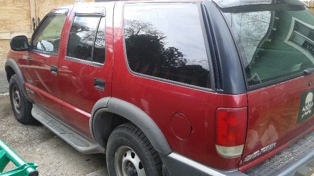

Soo, I was boonie bouncing yesterday and when I went to shift to 4HI, the the little light just flashed and never shifted, I eventually, after about 5 minutes or so, just clicked 2HI.
Any ideas?
P.S.
2001 GMC JIMMY

Yup, from what I've heard the floor shift and the large factory flares are rare
