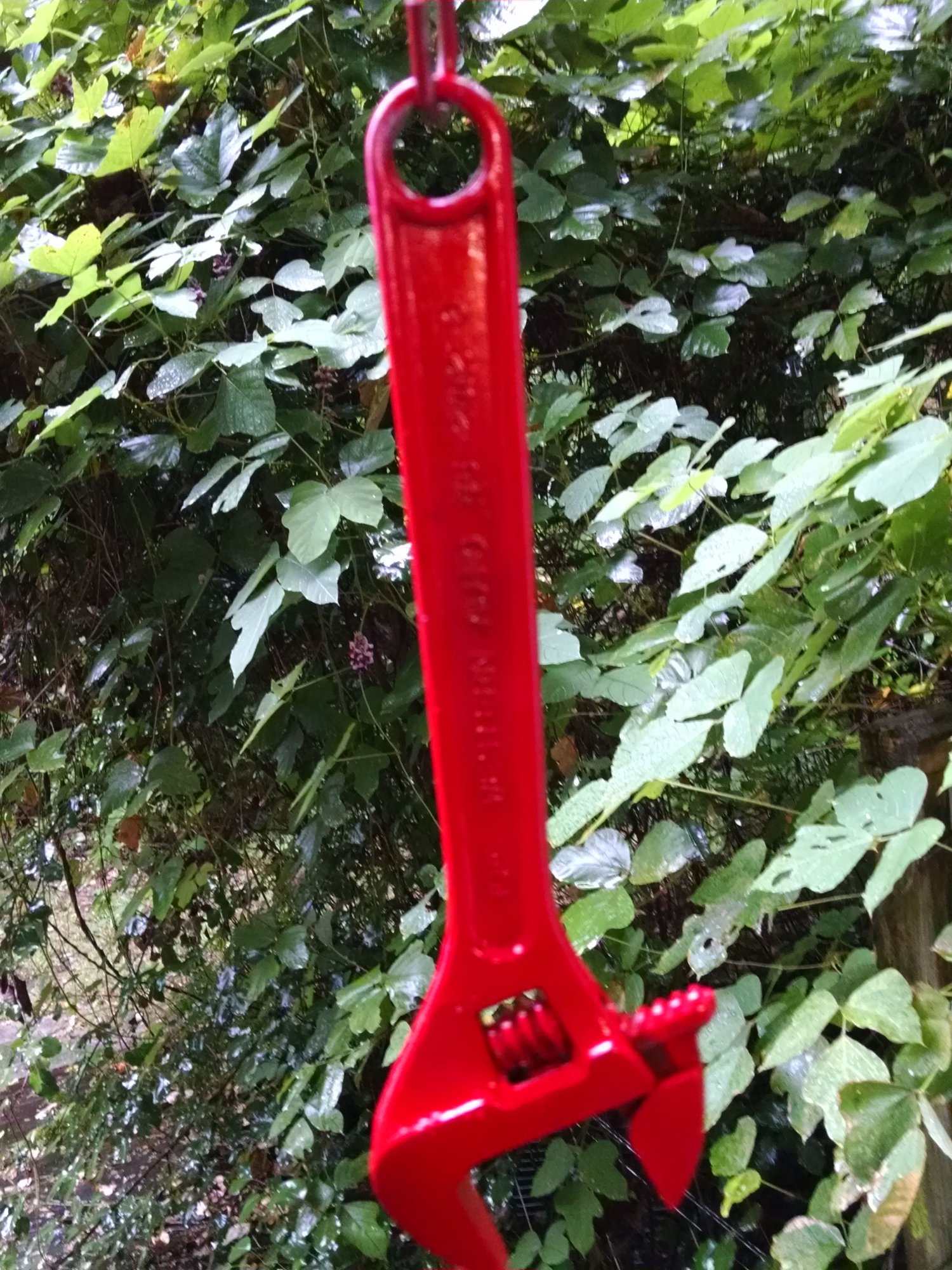

Old cheap set of cresent wrenches bought Western Auto years ago.. MADE IN CHINA junk.. any way never stayed set , floppy jaws . PIA.. Need to replace water pump on 99 Blazer and new Radiator Do a 1 time and Done with it. well fited the Wrench to fan Hub.. took the set screw out to make it long and fit fan nut. marked it. took to a local machine shop for tack weld . and forget 36mm ?? but he charged me $5.00 for the very simple tacks with welder. Used it. then painted it to find easiy later...
Home made fan nut wrench
fits a Blazer of course and a Dodge 1500 4x4 truck and i'm sure other Brands 36mm if I recall correctly any way. for Laying around a un used Piece of China Junk from the 90's.. it works .. just short on handle length, so a open end wrench in end for a cheater to make length longer..

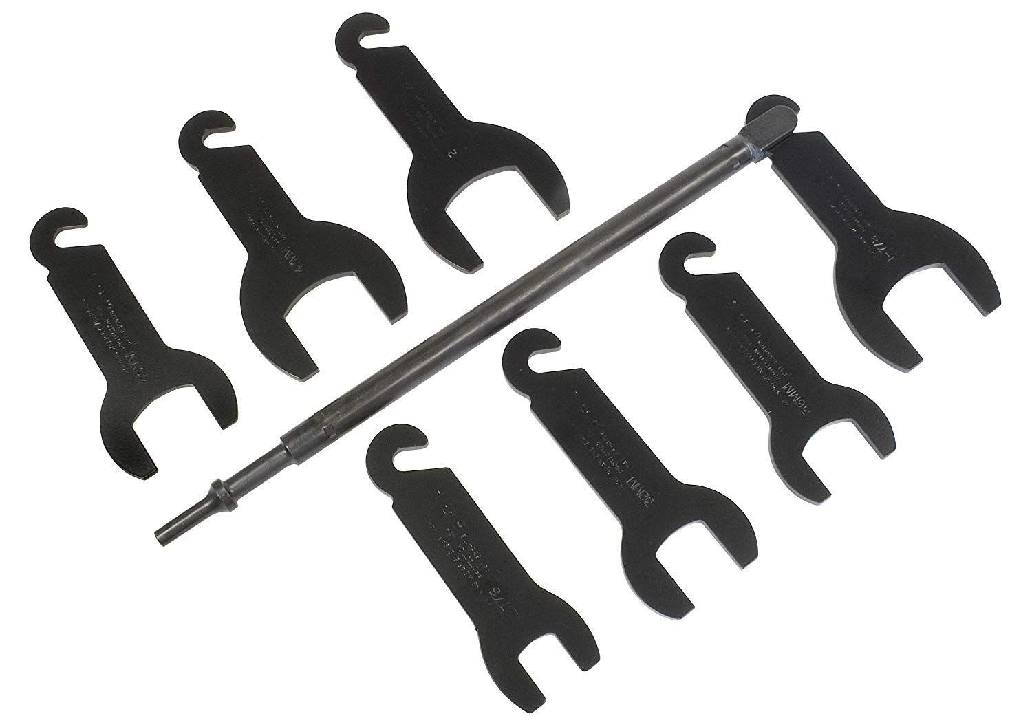

Even better, if you're going to do more than one or two fan clutches,
buy this tool. buy this tool.
It makes the job a piece of cake.
