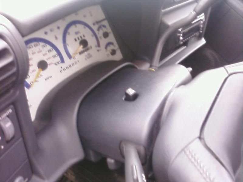

This is very inexpensive and easy fix for any S-series vehicle from 1995 and up.
All you need is a pair of needle nose pliers (or leatherman) and a replacement hazard switch.

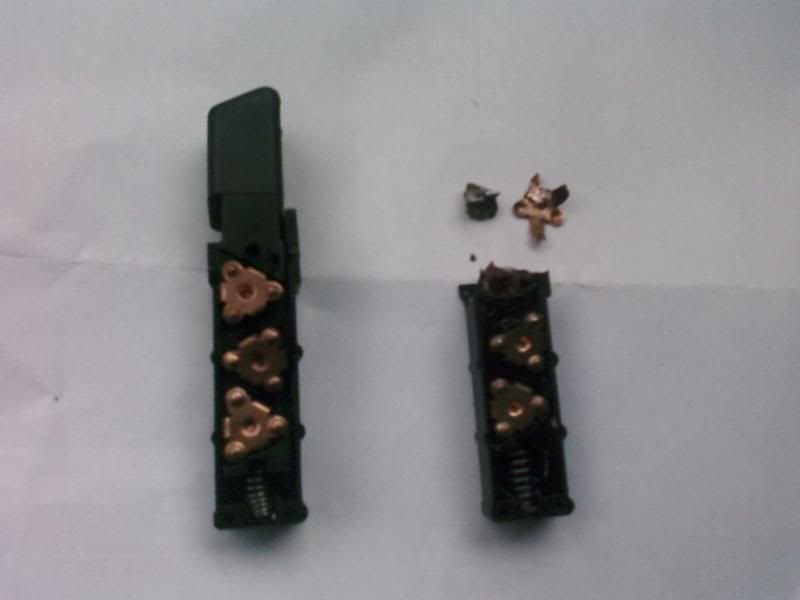

chances are you had some ghetto setup like this to keep your hazard lights from constantly flashing.

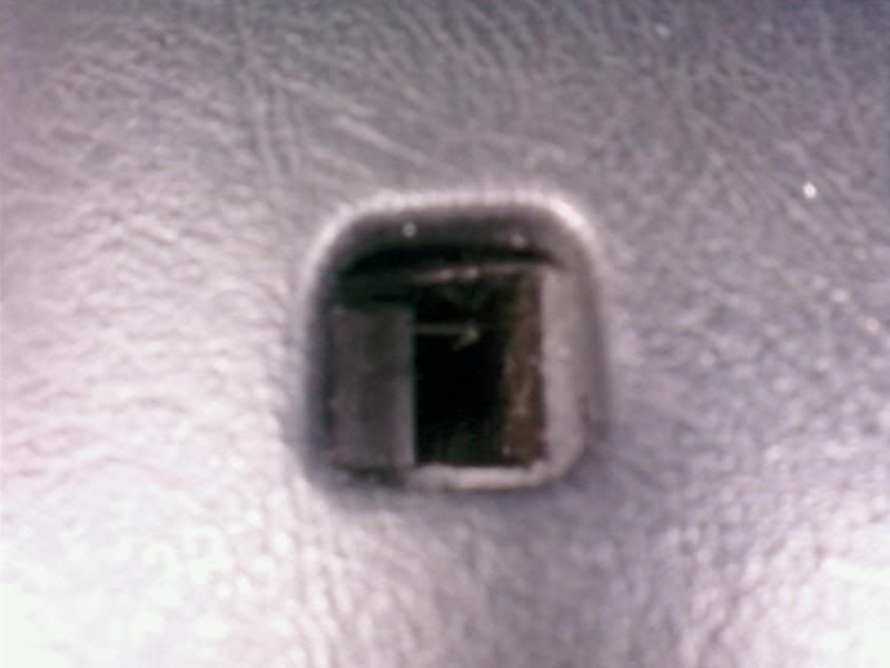

The switch is broken half-way off in the socket

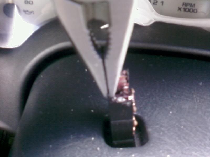

Grab the edge of the switch and just yank it out. You may have to wiggle the plastic housing to get the broken switch completely out.
The new switch and whats left of the old one.
If there's any little pieces of plasic or other debris in the empty socket, now is the time to get it out.

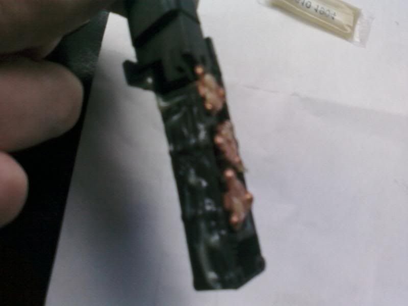

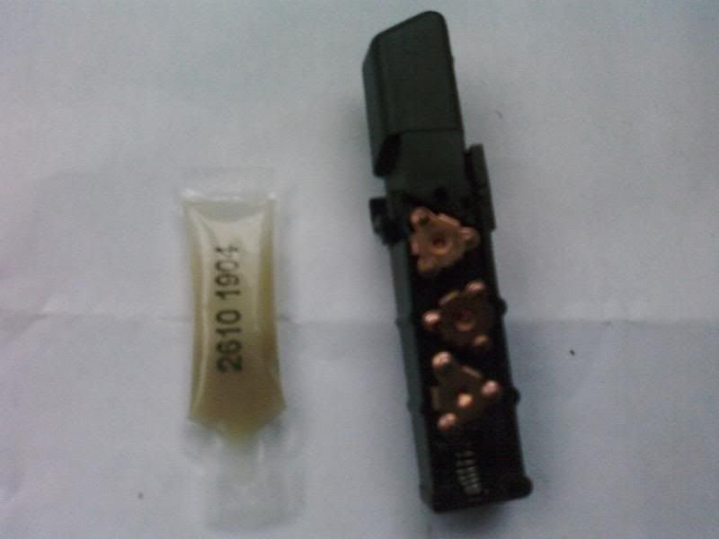

This kit comes comes with a small tube of dielectric grease. Coat the lower section of the switch.
juicy
Insert the new switch and you're done. Much cheaper than purchasing a new assembly.

What part of the description above didn't you understand...? Grab a hold of the switch and pull....
This picture shows it quite well and sentence under completes it:

If you read this post here and look at the pictures, you will see that a screwdriver is not used. Only a pair of needle nose pliers (well, in this case, they look like a Leatherman Super Tool, but that is besides the point).
If you really want to make this more difficult than it needs to be, tear apart your steering column and use the screw driver as shown in that document (or this one 98+ Hazard Switch Replacement - you could have saved yourself some time searching through NHTSA). It really is quite easy, but you probably won't believe me (or anyone else) until you get in there and actually try it.

If it isn't broke, then it's even easier. Grab hold of it with pliers and pull. It'll pop right out.
