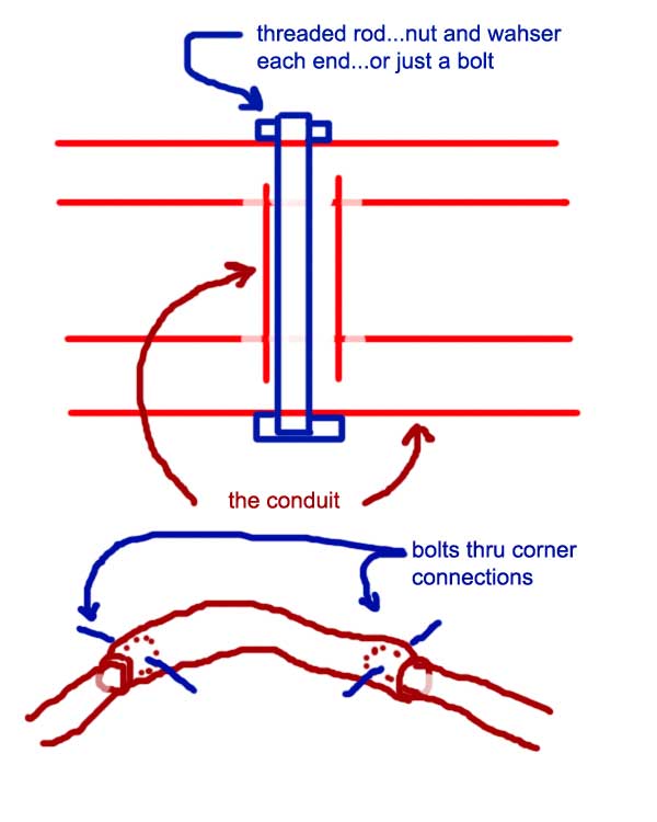

I don"t have a welder, so how could you get around that issue and still make it strong? I does look awsome though.
the only thing i can think of is using bolts at the connections...i think however they might wear the holes eventually. check pic for what i was thinking.
jb weld maybe? again...long term i dont think either will hold up.

Thanks brother, I will look into it and if i come up with something else to help the cause or to update what you have done I will post it here, thanks.
