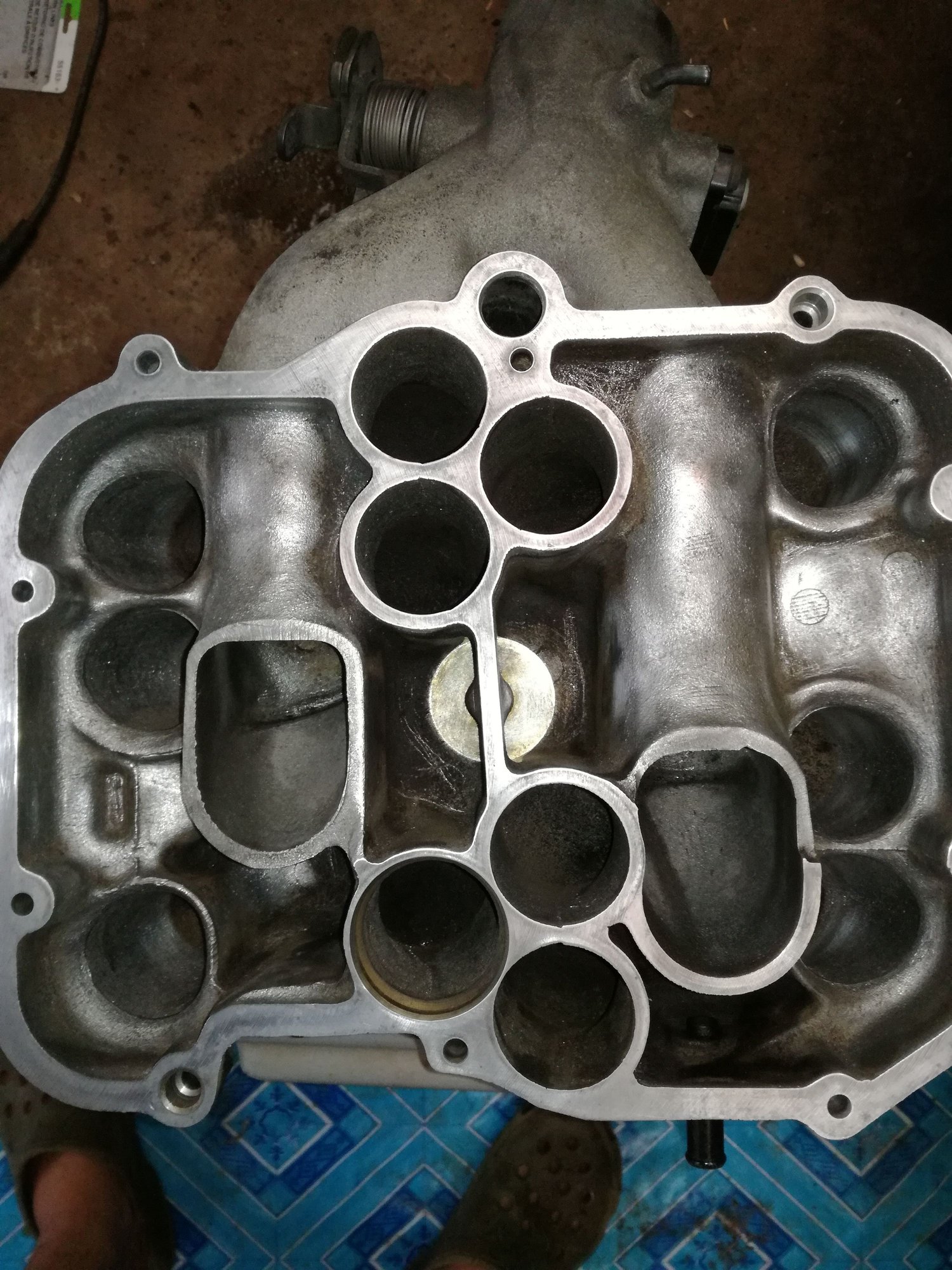

Well, I am back working on this issue again. Why? The same thing that clued me into this problem is happening again: the fan is interfering with the shroud quite a bit. So much so that about a mile down the road I smell burning plastic + the noise! Rather than screw up the water pump, I decided to tackle this problem again.
So... what happened to the mounts? My theory is: I've had a gas leak for a while but couldn't pinpoint the source. I finally realized it was leaking under the shrader valve on the fuel injector intake block running into the plenum. See the thing w/ the blue cap here:
https://imgur.com/alNaX2H
I think what's been happening is: the gas slowly leaks off this intake block and drips down the block, eventually settling on the driver's side motor mount. I don't know if it's the heat (and lack of heat shield on the exhaust headers) AND/OR the gas breaking down the polyurethane mount, but it seems to have happened.

Nicely written, I was looking for info about the Energy suspension engine mounts, I probably have to replace mine because there is a "thump" sound whenever I gave it hard acceleration, I'm glad I found this. I think the part number is different for 95+ blazers, 31144, also I think I need to replace the transmission mount.
Everything seems pretty good, the only thing that is bothering me it the wedged are plugs and the electric tape inside the plenum, bad idea, they are going to get sucked by the engine eventually.
I just replaced the spider in mine, I had to clean everything, it was a mess.
Now my next problem is a leak in transmission and engine oil.
Doesn't the gasket seal off the 6 air intake holes when the plenum is fastened down? Am I missing something?

As you can see in my previous post in the second photo is from the upper intake, you would probably notice the flow of the intake, after it passes the throttle body it gets divided and blows directly on top of the injector spider then it goes to the top perimetral holes that are connected to the center ones, if those plugs or the tape come loose they will get absorbed by those perimetral holes and get into your engine, probably will not cause any major damage, but I would not risk it.
