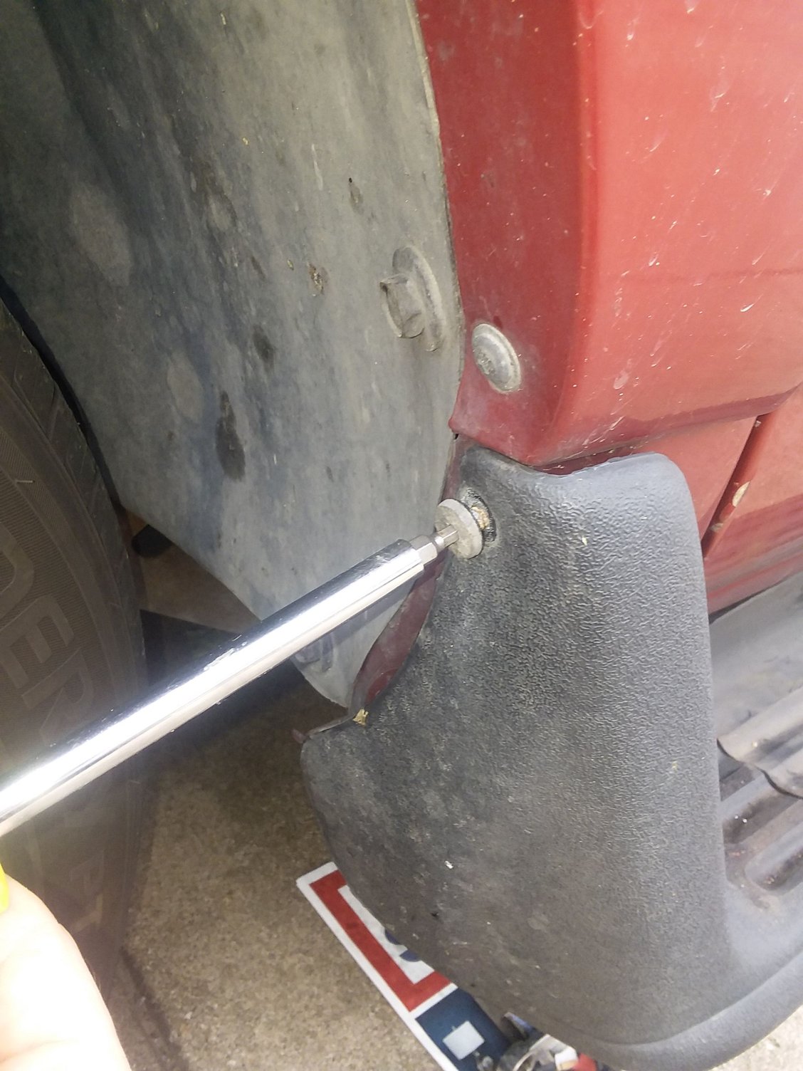

I removed my worn out running boards and wanted to share the process.
This is a before picture.
Start by turning the wheel so you can get the front piece off with a 5/32 hex bit.
The front and back pieces are also connected by two 1/4 bolts underneath.

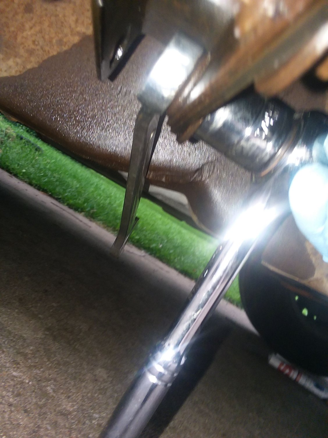

Next there are 6 bolts on each side that were tricky to get off. I hit them with some penetrating oil and use a 19 mm wrench and 3/4 socket to break them free.
They were very hard to turn so I used a floor jack to assist in pushing the wrench on the very hard ones.
I still have some brackets that I need to remove or replace with new running boards. I'd like to ask for opinions on leaving these off. Maybe get some splash guards so I'm not kicking up a lot of crud under my car?
Tell me what you think and I hope this helps anyone thinking about removing their running boards.
