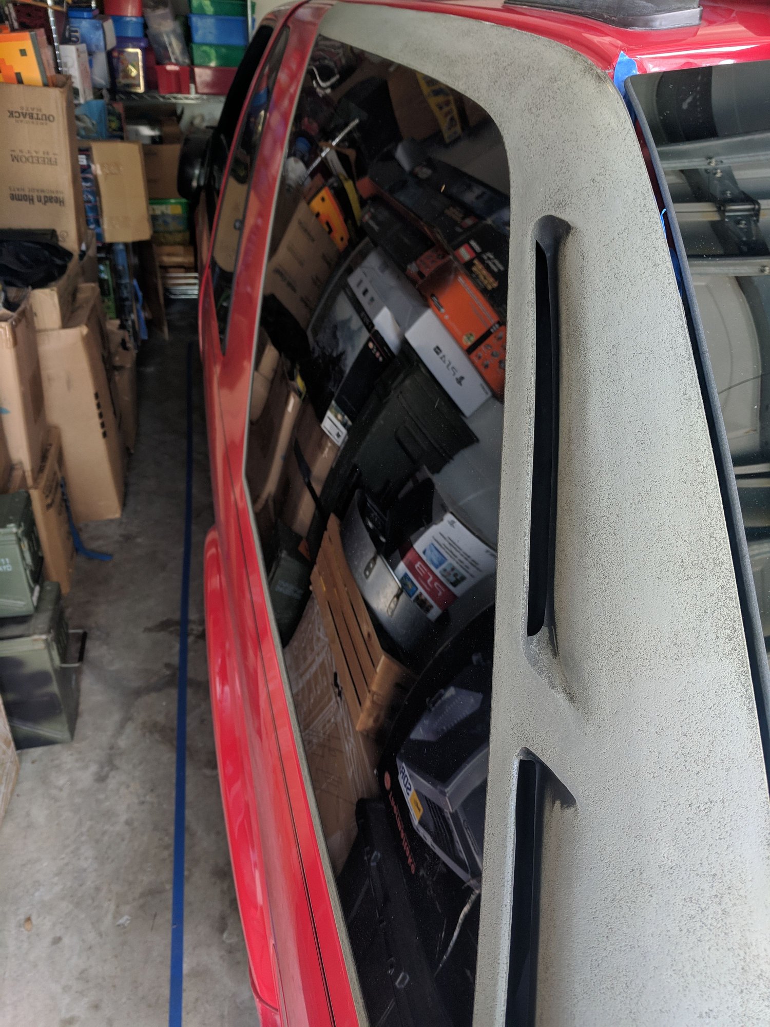

When I got this Blazer the rear trim was in pretty rough shape. I'm sure anyone with a 2-door model is familiar with this.
I've been getting really into detailing, and having the plastic trim look like this after waxing really bummed me out. So, I began looking into methods for how to restore.
The best solution I came up with after looking around for ideas was to just keep sanding it down and repainting it over and over.
Here's the products I used.
First I masked off the windows and body panels with blue tape and newspaper. A painter tarp might have been better, but I didn't want to spend the money on it when I have piles of newspaper waiting to be recycled.
Then I sanded it down first with 80 grit. My goal was to sand it down until the little divots where flushed out. Then I used the sanding primer to lay down an initial coat. Then 180 grit sand paper. Primer. 320 grit. Etc... You get the idea.
I spent about 1/2 day just doing prep work, 2 days on constant sanding and priming, then the final day spraying the final coat.
Fully sanded down. No paint. I did have this covered and removed for the photo.
Sanded primer.
I went through maybe 4 cans of sanding primer and bumping up the grit count on each new layer until I was ready to polish it down.
After using 1500 grit to polish, then I used the Trim and Bumper paint for the final coat.
Final polish and coat with bumper trim.
The above is what the final coat looks like. I was really static when I saw how well this looked. I wasn't expecting much from the bumper trim paint.
And now the final result
There are still a few light scratches from getting too aggressive with sandpaper and not doing enough polishing. I was wasn't able to sand it flush with all the divots in the plastic, However, that kind of texture it left behind has grown on me.
In retrospect, I think maybe using a light body filler after the first sanding to fill in the divots would have probably worked better and saved time with the constant priming.

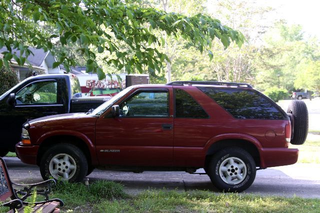

Looks fantastic man, I have the same issue with my 2000 red blazer. You've inspired me to do the same thing. Thanks a mil! if you zoom in the pic, you'll see it.
