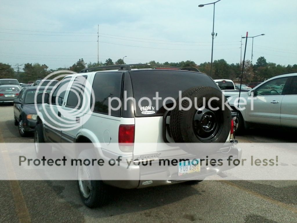

Well here's mine all done with custom antenna mount all coated in POR15.
<a href="http://s982.photobucket.com/albums/ae307/joshamarion/?action=view&amp;current=IMG_20120731_165300.jpg" target="_blank"><img src="http://i982.photobucket.com/albums/ae307/joshamarion/IMG_20120731_165300.jpg" border="0" alt="Photobucket"></a>

Click for bigger
Here's Josh's pic for you guys to see

Originally Posted by Joshs4x4
AHH cool thank you!
Looks good Josh! Very clean install!

question here boys now you said you didnt add extra support inside the panel of the truck and this did not rip out the bolts the first time you took it off road i would like to make sure its going to stay in before i start punching holes in my truck
Old Aug 7, 2012 | 06:46 PM
  #367
warthogdriver's Avatar
Posts: 2,785
From: Bay City, Michigan
When i did mine i ran the bolts thru the outer and inner panel and then got a piece of bar stock atl from the depot to tie the bolts together and brace it. I have never had a day of trouble with it...and the body panels are still in perfect shape.
Now granted i am not a heavy off roader..but still, no issues thus far.

You're fine man. I have no extra support besides the bolts in the body and I have been off road a good bit. I've been in mud up to my doors (I'm glad I didn't know it was that high when I went through it. I would of been like oh #$%$) and also up and down some pretty big hills/inclines/declines. Mine is the same as the day it was installed. No damage anywhere.
Although I won't be going in mud that deep for awhile. The mud caused my truck not to start up a few months ago. I had fried something because mud got in it. Ahhh.... mud does evil things.... evil things man.

well thats good enough for me i am going to start the process of the install today i have some 1/4 inch thick steel bar here i am going to use to reinforce at the bolts inside thank you for the quick replys on this
