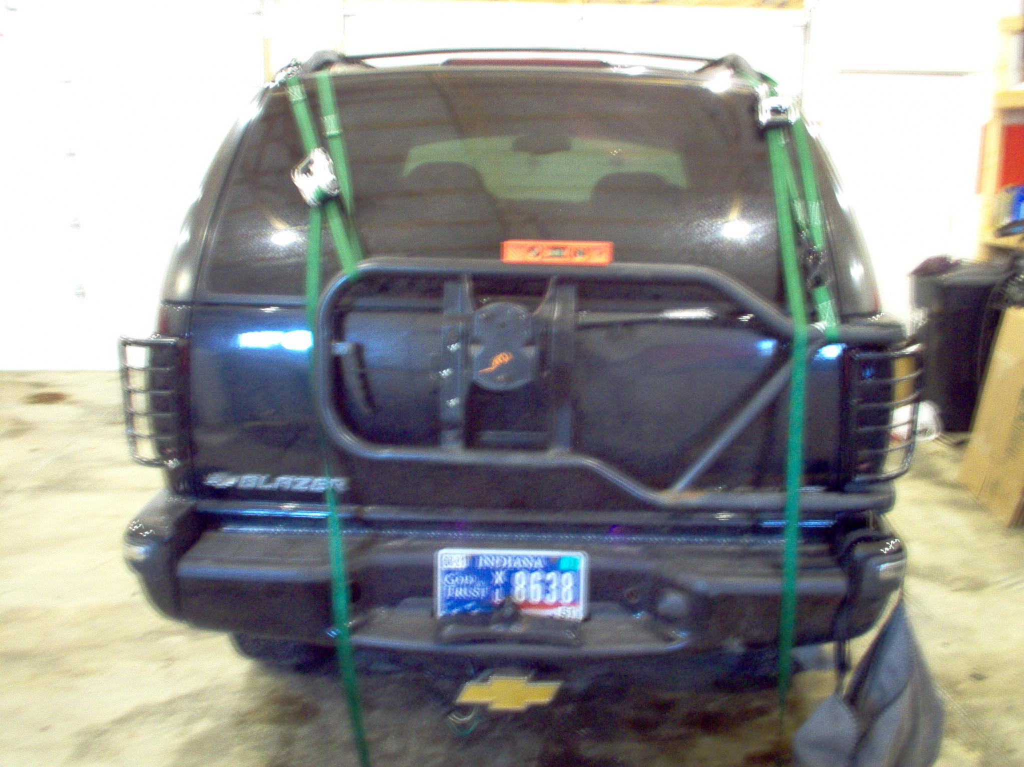

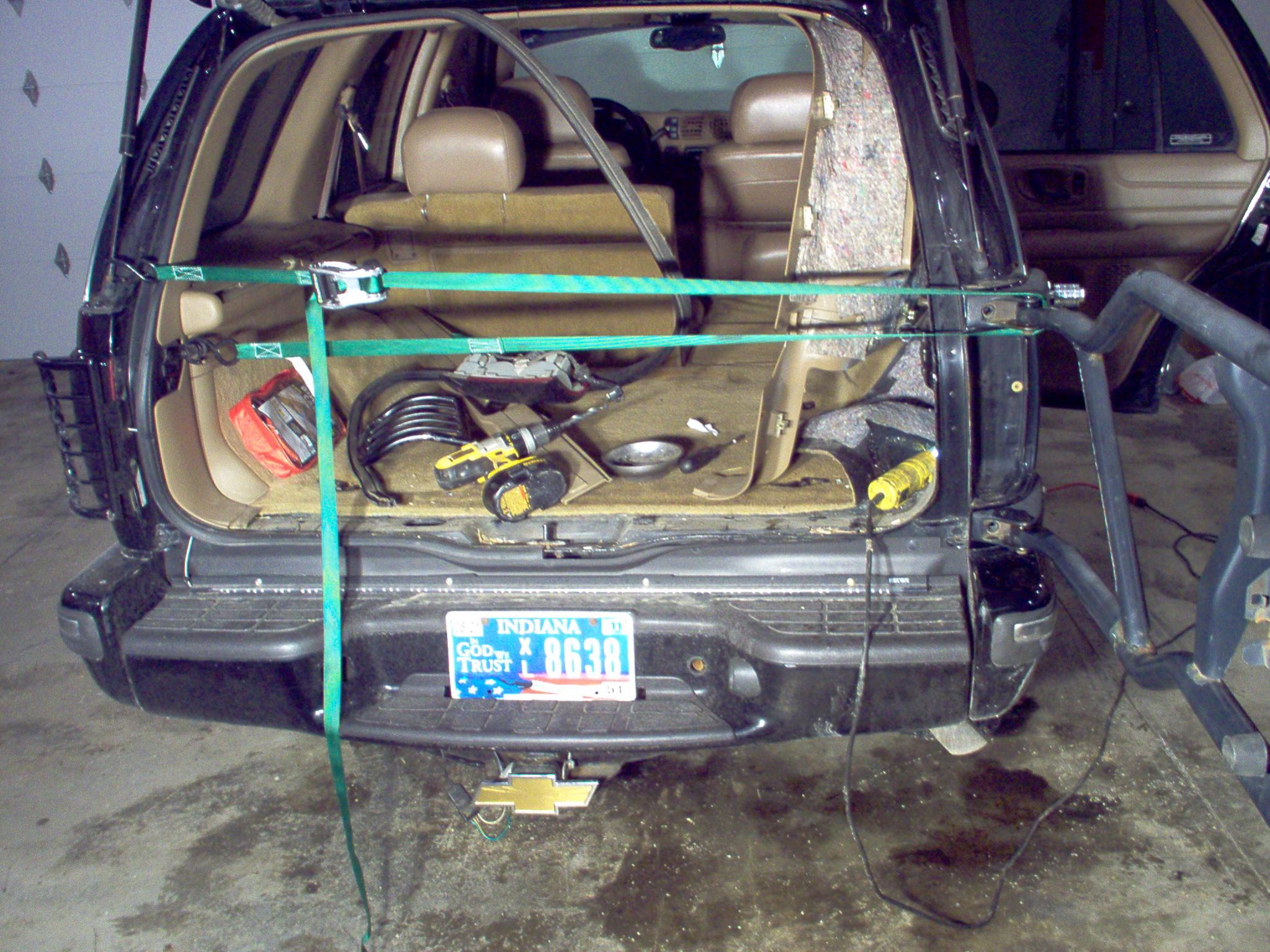

I used two straps and hung it from the luggage rack. I got the two front bolts in and snugged up. Then I took the two straps and ran them to the drivers side to help pull the carrier tight against the body panel so I could drill the rest of the holes where they needed to be.

looking good...thats almost exactly how i did it.
those straps come in handy.
