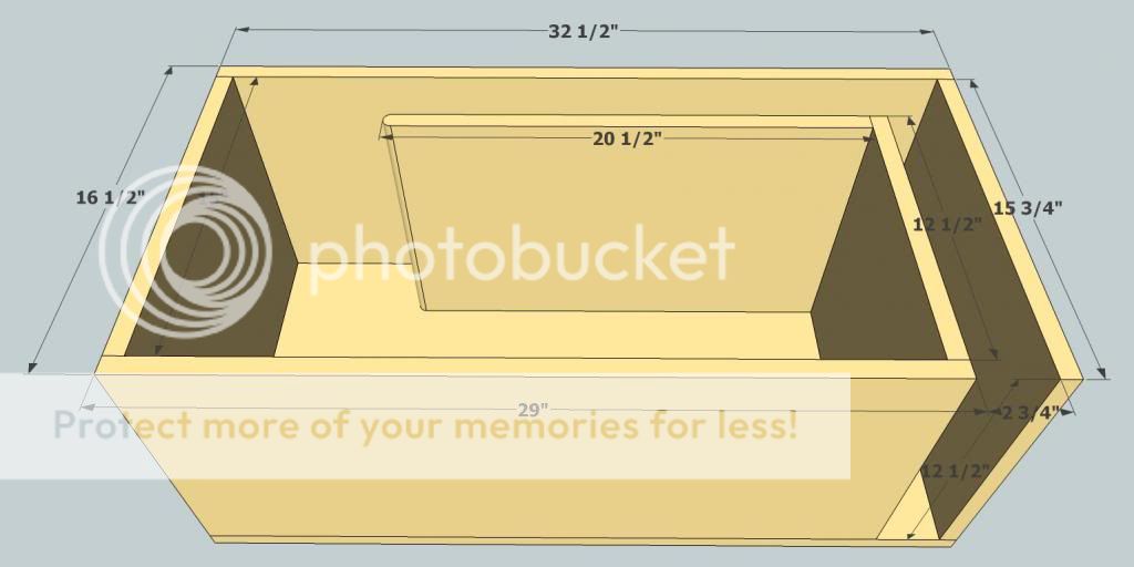

So the same width and depth as the MTX box (32.5 x 16.5)?
I take it that keeping the height to about 14" or so is ideal for you? Could you possibly go as high as 15"?
If so that gives about 3.36cuft GROSS to work with and should be almost perfect for a good, efficient low tuned enclosure.

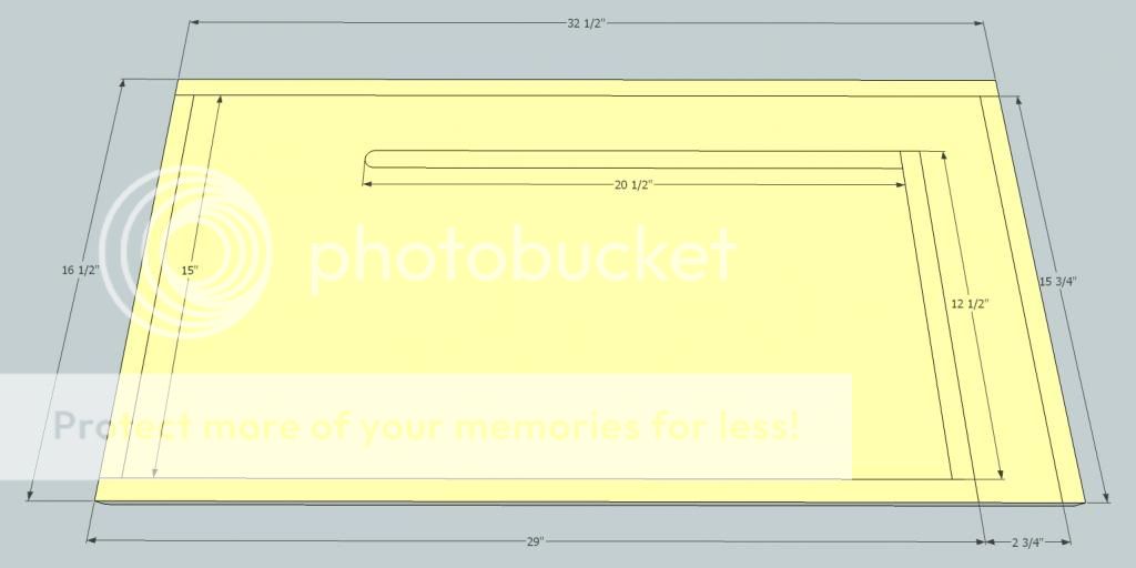

Well, looks good is a relative statement, sounds good is always the goal.
With the limited space it's hard to get anything very fancy, such as a center slot port design, but I think a standard slot port will look and perform just fine for you. This is 2.2cuft NET tuned to 32hz with a 2.75" x 12.5" port. Fairly run of the mill and should do great for you.
If it suits you then I'll get the design finished and the cut sheet posted up for you.

yes that will work as long as it is for 2 10s thank you
