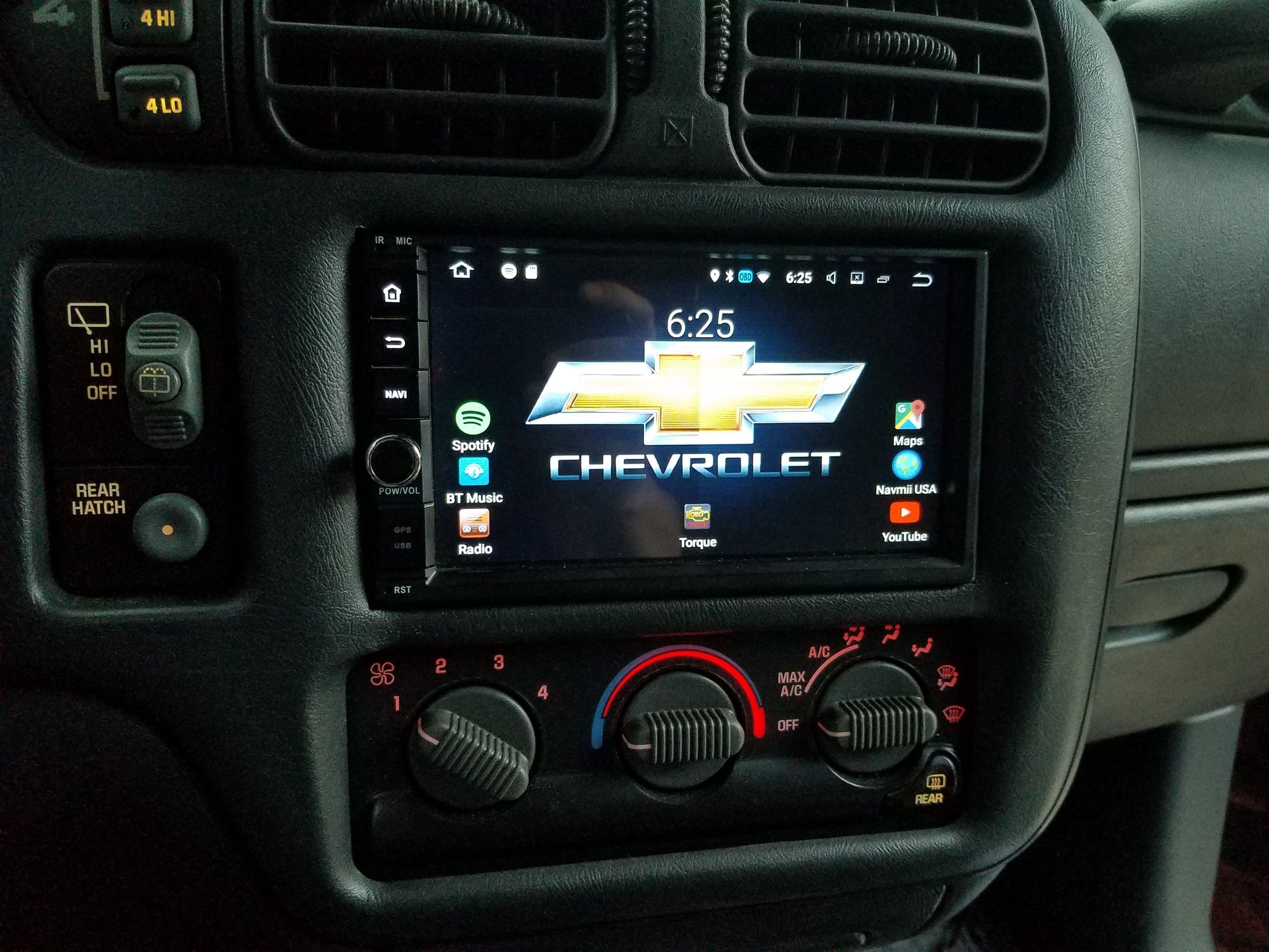

I recently installed a 7" Android Head Unit. I would like to get the steering wheel controls on my 1999 Blazer working with it. I have determined with an ohm meter two wires that show resistance when the steering wheel keys are pressed. They each have a unique impedance and are the only wires that are effected when the steering wheel buttons are pressed. The wire colors on the radio harness connector are blue and green. I connect them to the Key 1 and key 2 connections on the head unit but it has trouble learning them. For example when I set up for volume up, the volume up is continuous, as if the button is being held down. I was also able to program the mute button. but that was all. No other bottoms could be programmed.
I have also tried connecting only one wire to Key 1 but I get no response from the radio at all when connected that way..
Do I need an interface for this? If so which one? Is there an alternative to using the interface? Am I making the wrong connections?
I have scoured the internet and forums for information on this with no luck. Any help is appreciated.
