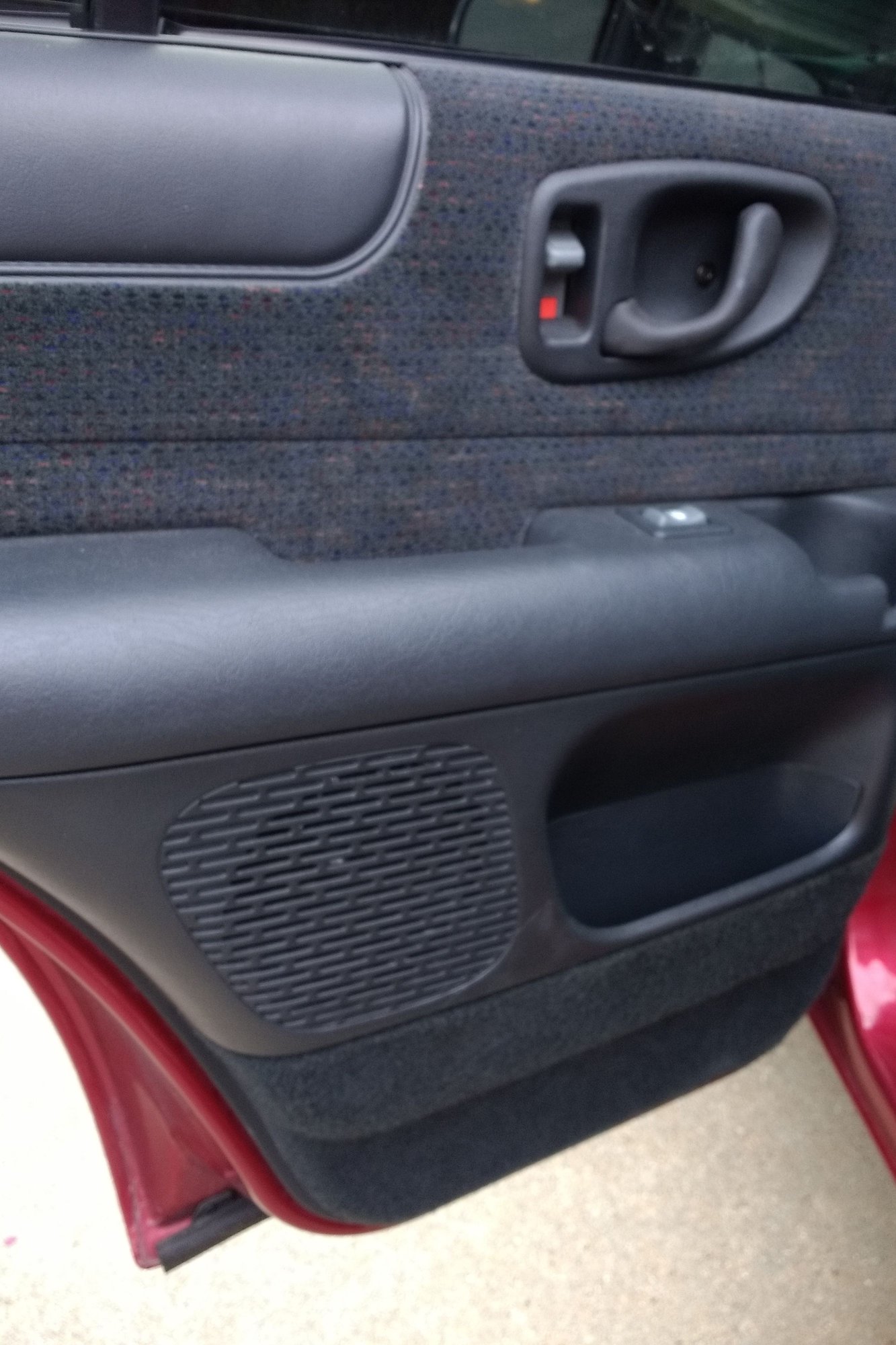

I installed factory pioneers out of a factory pioneer Pontiac Aztec in my door of my blazer and I like how they sound the only mods I had to do was to the speaker housing on the rear doors and I spliced the Aztec speaker wiring into the rear door speaker wire and trim a little on the back of door panels front speaker justs plug in and had to trim the back of door panel plus you can never tell whey didn't come in the blazer

In process of installing 4 Focal RSE-165s (6.5" component speakers) in my 2001 LT 4x4. Got all four for $233.82 off Ebay - pretty good price for Focals I think. Front tweeters are in the stock brackets in the dash to bounce off the windshield. Rear tweeters high in the rear doors. Speakers required 1/2" spacers to clear the magnets in all doors + drilling at a slant to fit the 6.5" speakers. Rear door panels required removing the internal plastic ring in the inside speaker area for clearance. Front door panels required cutting the built-in speaker grille out and letting the Focals poke through the panel using their own grille. Took out the analog OnStar system from the right side cargo area and installed a Soundstream PN5640D 5-channel amp on the bracket inside the compartment. Bought an 8" BT8024DVC Bazooka tube to mount in the back and point at the corner, but haven't even taken it out of the box yet. Hopefully can get all the wiring and crossovers run next weekend. Taking it slow and trying to do it right. Already have a Kenwood do/play everything head unit with 6 preouts installed from a few years ago. Did I mention this is the vehicle that my wife drives..... No Pop, Hip Hop, or Rap music for her - she listens to Progressive - like Magic Pie, Airbag, Porcupine Tree, Riverside, and Dream Theater so I think she deserves it. Happy wife! Happy life!! She has time for one nice 25 minute long Prog song each way to work! I think she is going to really like the sound out of this system. Not a thumper stereo - but balanced sound in a SUV, without killing all the cargo space is the objective.

Haha! Well, got it all finished up this last weekend. The four RSE-165 Focals had to be spacered out 1/2" with a plastic ring to clear the magnets on all doors and then the screw holes redrilled in the speaker mounting surfaces. Had to cut out the speaker grilles in the front doors and let the speakers poke through with the Focal grilles in place. Rear doors only required trimming the internal speaker ring on the inside of the door panel flush. Mounted front tweeters in stock location under grilles in the dash. Mounted rear tweeters on inside of post between front and rear doors. Bazooka sub in the back, with the amp's sub-level control mounted inside the cassette cubby inside the front console. Soundstream Picasso Nano PN5640D Amp in place of the old analog OnStar equipment mounted on old bracket. Running off of the same Kenwood do-everything / play everything KDC-X898 head unit I had before. Never ran so many wires in my life - soldered everything. System really cranks and I think sounds great. Wife says she had no idea it would sound so good....... says it's like having new music to listen to.
