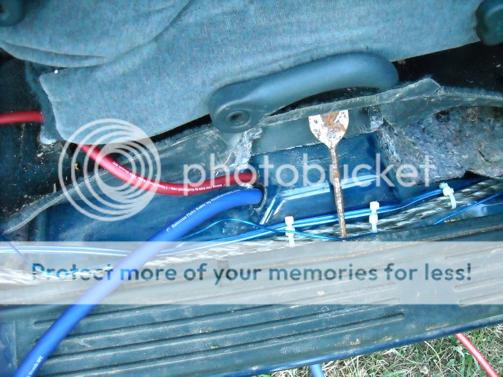

Do it right the first time. If you're running the wire back to the rear of the vehicle for your amp you might look at running it under the truck to the rear mounting point for the passenger seat. You can drill the hole there on the angled part and then the wire will hide easily under the carpet back to wherever your amp will be located. Either way you go you should do it right, don't cut the factory grommets and don't run it up around the fender/hood/door area. Sure, people do it all the time and may not have any issues while they own the vehicle but that doesn't mean it's the right way to do it.
Here's a picture of the wires coming through under the place where the passenger seat mounts. That's a 4 AWG and a 1/0 AWG side by side.

alton,
Thanks for the pic! I will probably do the same thing or something very similar.
