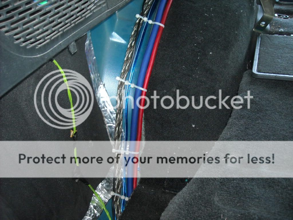

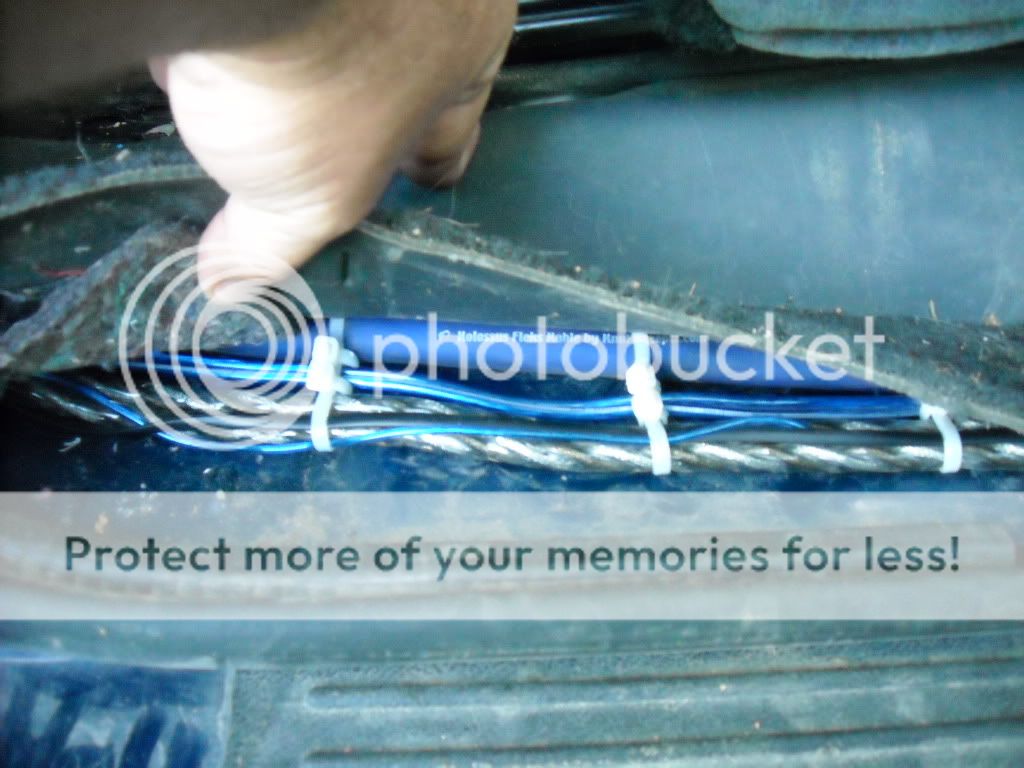

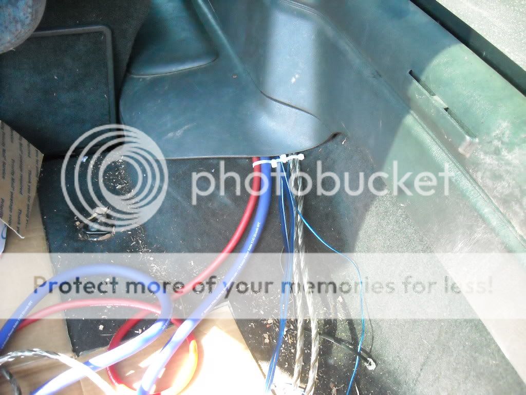

I went through the bump in the floor pan that's underneath the rear of the passenger seat with 1/0 and 4 gauge. I didn't have to fight anything that way, the wires followed the frame, and the wires made it under the carpet super easy from that location.
Here's a few pics to illustrate.
Here's where the power wires came up through the bump in the pan under the seat.
Here you can see the power wire lying nicely with the rest.
And here's the entire bundle coming out from under the carpet and making its way over the rear wheel well toward the location of the amp rack.

From: under Los Angeles
Signal and power running parallel?
Yes. First of all they're separated by the zip ties throughout the run. Second the need to have them ran separately isn't nearly as critical as it's made out to be.
