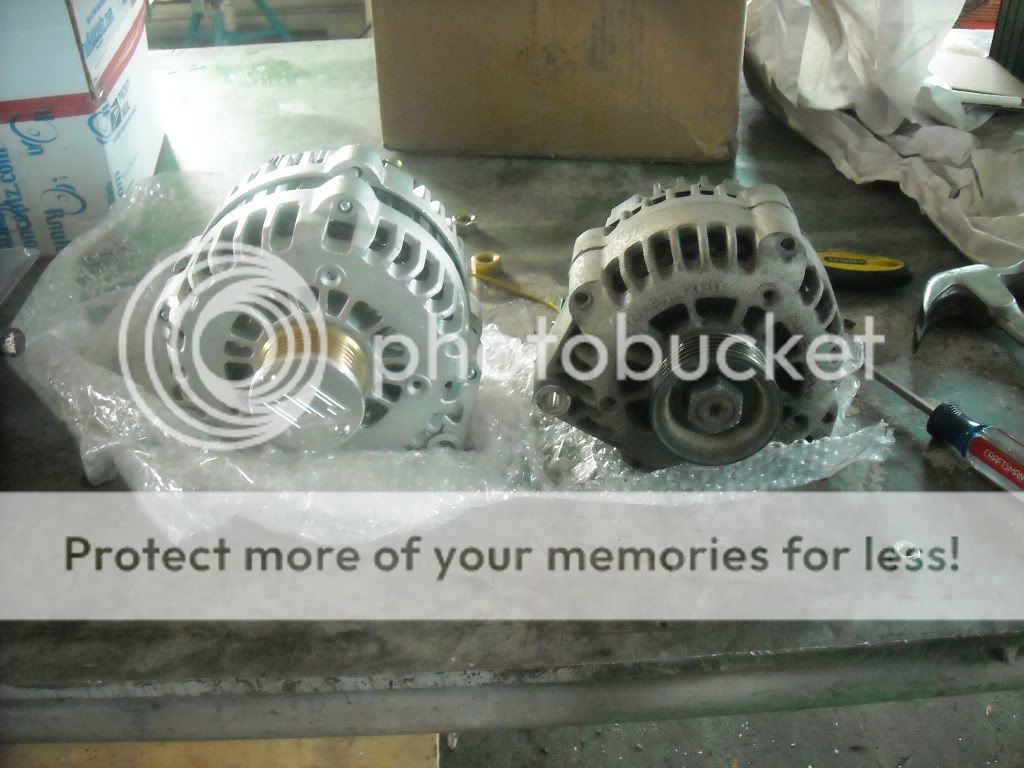

I've never heard anyone refer to the wattage output of an alternator before, it's not really relevant. For arguments sake though 12V*250A=3000W, just so it's out there. As for the size, the HO alternator is a "large case" alternator, just the same as an AD244. Those are used in other GM trucks and are rated and capable of more current output than the CS130 alternators that come with our trucks. The good news is they bolt up and plug in exactly the same and only require a belt that's 1" longer to make it around the slightly raised pully.
Here's a picture of my stock 105A CS130 case alternator next to the new Singer AD244 case 250A High Output alternator that I replaced it with.
