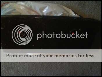

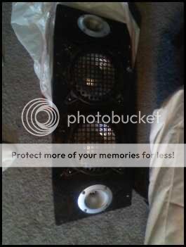

I recently acquired a free speaker box that has two speakers and two subwoofers all together. I wanted to mount this in my trunk of my 94 blazer. I was wondering how I wire this to my aftermarket JVC radio? the speaker box has a black slot and a red slot for wires on either side of it.

You may have to buy and amplifier for the sub woofers but if not you should be able to splice into the speaker wires on your cdplay and then run them to the box and hook them up into the terminals

well first off your probaly going to need an amplifier to power the subs, then an amplifier wiring kit to wire the amp up. Then im sure your hu (head unit) has a subwoofer or a rear output rca female connectors on the back of it. That is where you would connect the wires for both the subs and the speakers. they then would run those wires to the amp, then the amp wold go to the box. make sure you run the power cable straight from the batt to the amp. Also the ground would be as short as possibly (less than 24") and make sure to run the power cable along one side of the car, and the rca cables alsong the other so th electrical field around the power cable doesn't interfer witht the rca wires. hopefully i didn't confuse you to much. if you can take a picture of the box it would help.

no that actually helped alot thank you. ill get pics up. also my headunit is a brand new jvc one so im sure it has the female rca because my old panasonic one did, I just havent checked yet

you could run an amp with that setup but it would need to be small. i would just run it off the speaker wires tho.

ya you could but your radio only puts out 22 watts rms (uaslly around that) so you wouldn't even get enough power to the subs to let them hit hard. those subs need an amp if you want them to hit hard. you could run the other speaker (i think tweeters you said) off your radio wires. But you definitly need an amp. Find out the subs rms power and peak power and look for an amp. though when you are looking go by rms it is more accurite and make sure you don't get anything more powerful then the subs otherwise you will blow them fast.

sorry man, bad idea to run subs off the h.u. your best bet is to find a tiny 2 channel at a pawn shop or something. but then your just going to want bigger and better.

i was saying not to run an amp because i ran those same subs in my first car and they could not handle anything. i could be wrong though
