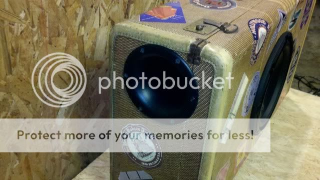

It has been awhile. Havent done much with the truck since. I finally started to utilize the cargo area for what it was meant for. Was getting tired of removing everything when i needed to carry something and Im passed the faze of big bass and wanted something subtle and could easily be removed. Anyways here is the setup I was running.

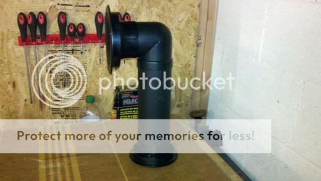

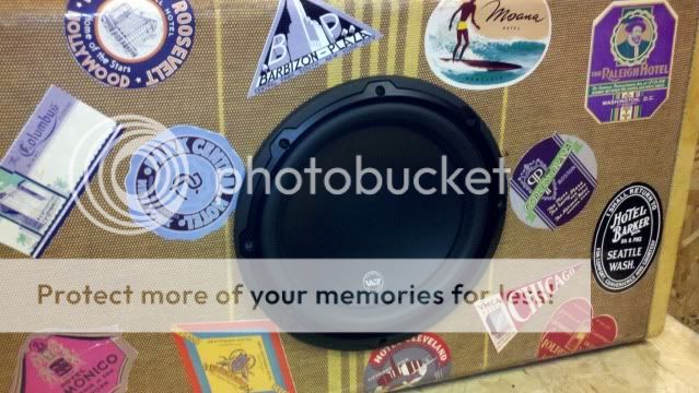

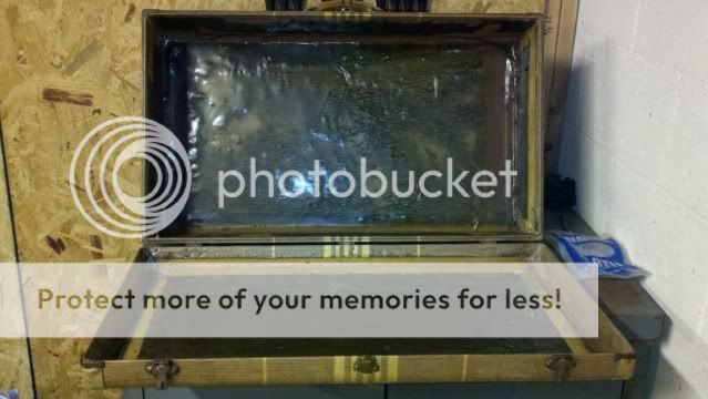

and here is the new enclosure. Its a 1940's suit case. Interior was fiber glassed, reinforced and sealed. 15" long 3" port ,final tune 35hz. Running a JL 10w3v3-4. Finished it off with the retro travel stickers. It will be held down on a bracket that it will slide on attached to the back of the seats. Lift to remove along with quick connect wires. No more then 30 seconds to remove.
I replaced my amps aswell. I am now running a JL XD 400/4 mini, which powers the JL c3 components up front and a JL XD 300/1 for the sub. Cargo area is still being worked on. Im currently working on putting down a retro style wood floor with chrome strips. Final pics will be up when complete.

Thats cool. how did you seal the box though? I get the Fiberglass reinforcement, but that big crack all around it, how is that sealed?
Old Dec 22, 2011 | 08:10 AM
Unlimitedsp's Avatar
Posts: 1,183
Once I had everything where it needed to be. I fiberglassed it shut thru the sub opening.
