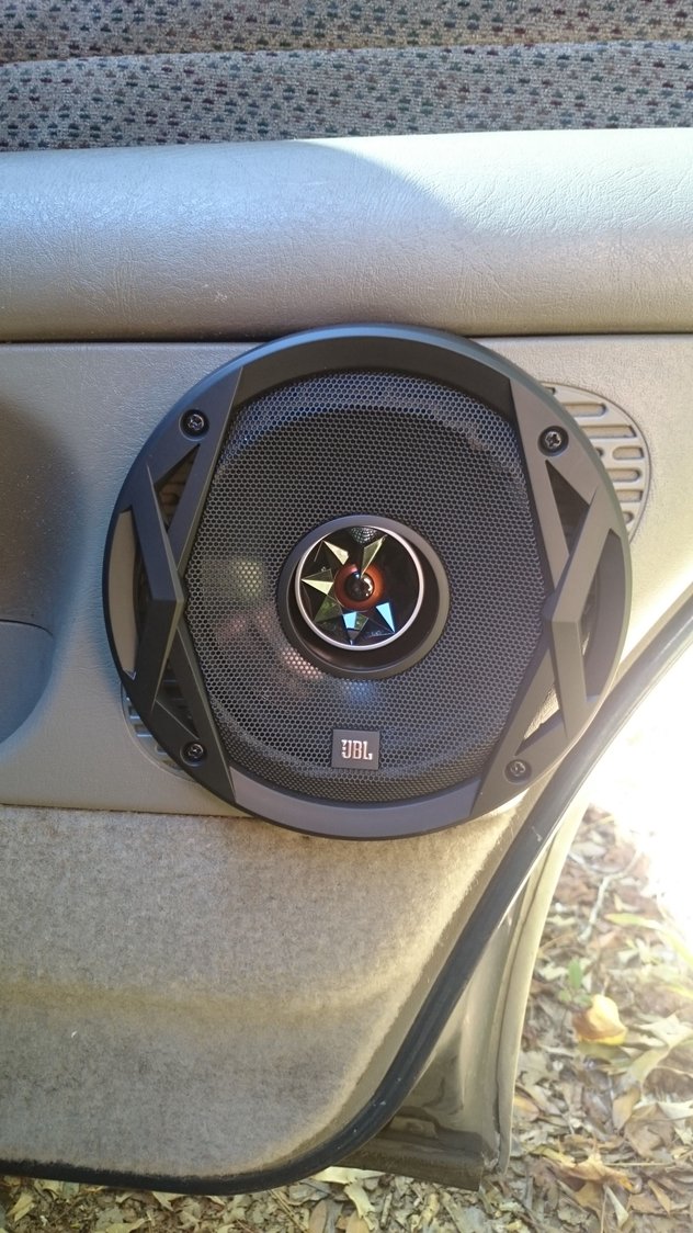

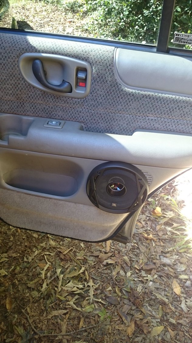

Yeah, I didn't really wanna change the appearance either, but since half of the slots in the door grills have broken, I wound up cutting them out and using the jbl speaker grills in the rear doors and I'm gonna do the same with the front. On the rear, they don't look really great, but they're functional. That's why I was thinking about flush mounting the tweeters in the dash speaker grills just to add to the custom look and mainly so I could hear and aim them better. Unless someone knows a better way . I mean I can replace the dash grills a whole lot easier than a door panel or an a pillar if I don't like it or mess up . Lol

Old Oct 21, 2018 | 01:48 PM
