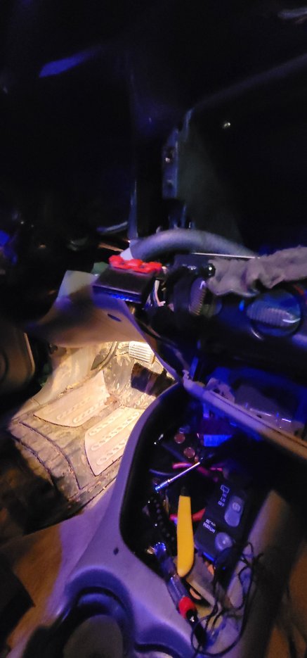

I am trying to install a pioneer stereo in my wife's 2000 chevy blazer and the stick stereo had 2 plugs in the back with wiring. 1 plug had a bunch of wires and I'm assuming that is for the stereo because it has speaker wires. The other only has about 5 or 6 wires to it and that is the one I am not sure what it goes to or how critical it is.
This is the one with the speaker wires
This is the plug i am not sure about
These are the wires going to the smaller plug

That one looks like it might go to the cassette deck.

You wouldn't use it at all with an aftermarket stereo (if that's what it really is).

The grey/black plug has all the wires you need for an aftermarket radio. I'd suggest you get an adaptor plug for it rather than cutting the plug off and attaching directly to the factory wires. They're really cheap and make the job a ton easier.
The black plug is for a remote cassette player that would be located in the centre console under the heater controls. You can just leave this tucked inside the dash. It does not need to be plugged in at all. The harness may be there even if the truck did not have the factory remote cassette player option installed.
