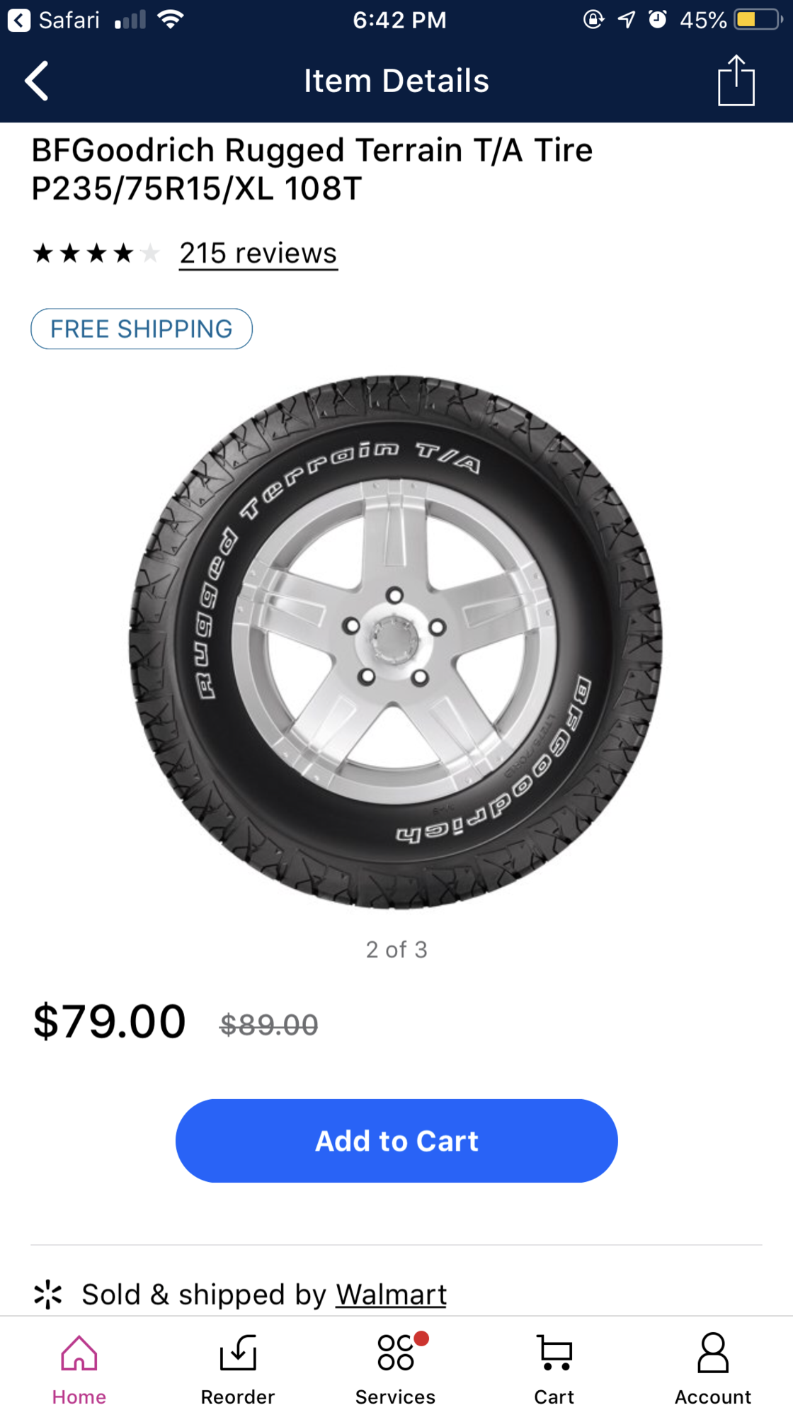

She ran pretty good both codes have returned although she does seem to be idling better than before. So you added a extra washer to o2 sensor? Yeah hopefully I do my heater core before winter lol. Also probably going to buy 2 tires this week or next. Nothing to fancy I really want these even though she’s 2wd...

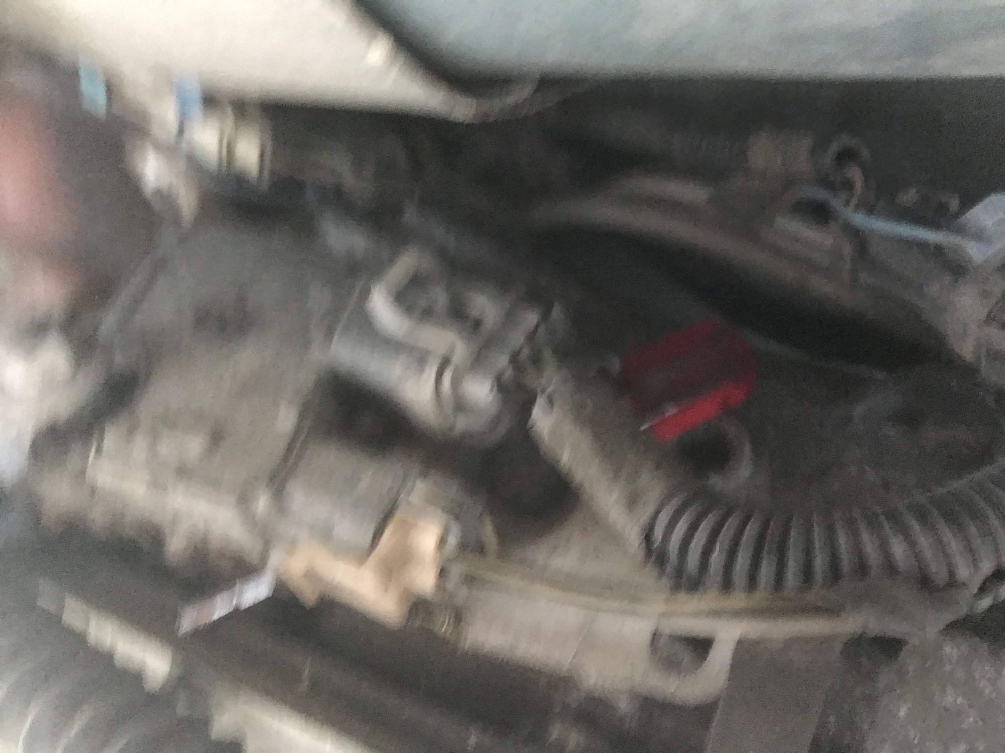

Well I swapped the o2 sensors around and now I got P0135 so I’ll be going to PAP Saturday return the wrong o2 sensor I have and get the correct replacement. Also while swapping them I noticed this
Torx screw driver... I left it there because I guess previous owner had it there for a reason lol it hasn’t affected anything that I could notice kinda scared to take it out
