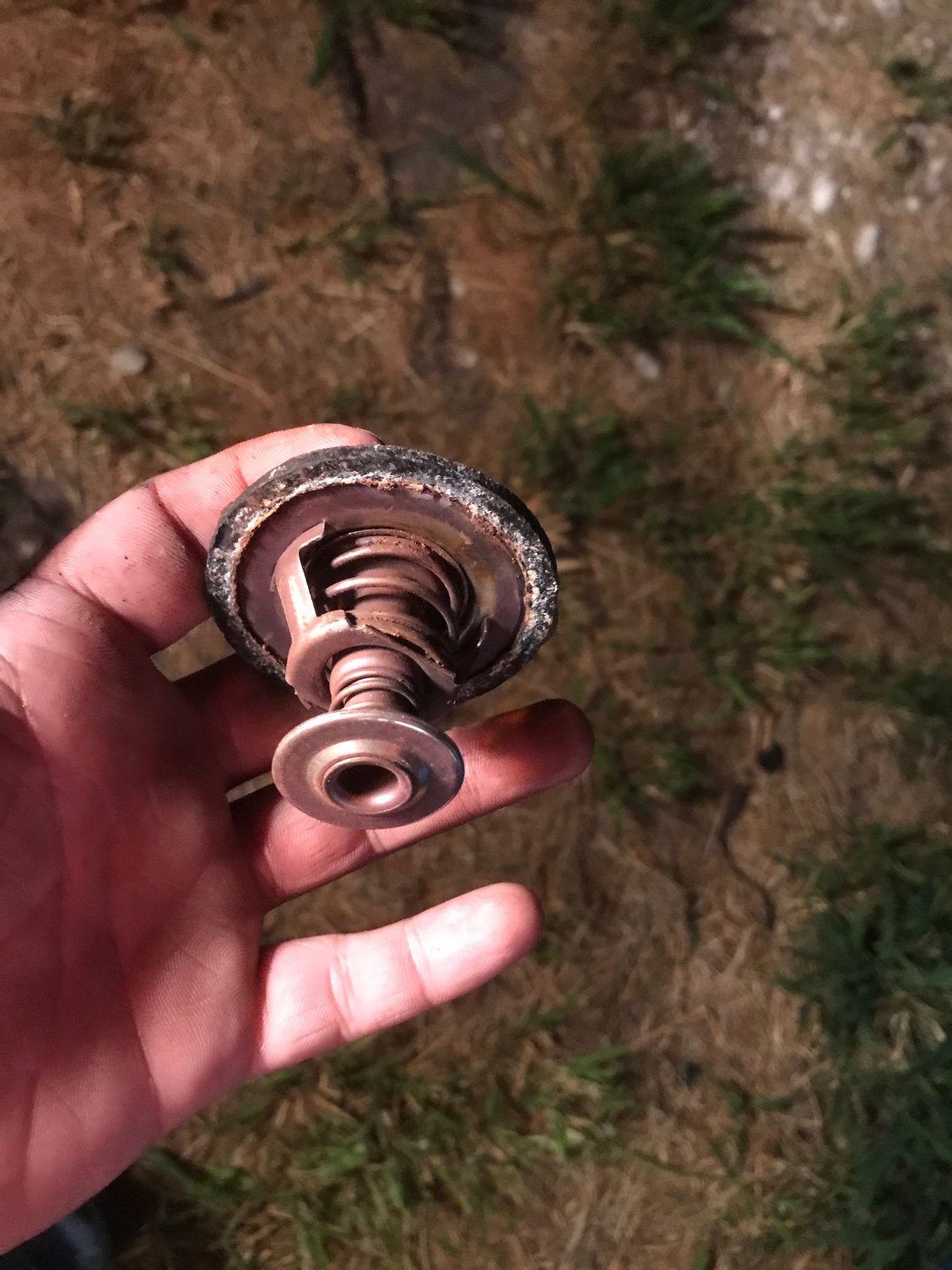

Replaced thermostat last night and stumbled upon a connector behind reservoir can anyone identify?

So today I was at Walmart and my wife daughter and Rottie stayed in the blazer why I handled some business (ac running blazer idling). When I returned I immediately noticed the blazer was running hot about 240*F so I shut her off (I could hear the coolant/water bubbling also) checked for leaks. No signs of coolant loss or leaks in radiator I called my dad he suggested looking at fan clutch and he came and checked it out and said it appears to be normal once she cooled down a bit we removed radiator cap and she was full of coolant reservoir was full also. So I let her cool down some more and drove her home she stayed at 210*F the entire ride home except for when I stopped and she idled in drive for a bit she peaked a bit over 210*F. My dad suggests my new thermostat might’ve been faulty (it is the gates brand OE 195*F temp oreillys didn’t have acdelco in stock) anyone else had a similar issue before? I’d also like to throw in that the heater core is bypassed (by previous owners) so that’s out of the equation

Mine does this every time I drive it. At around 235°F or so you hear the fan clutch kick in with a mighty wooosh and it cools down pretty quick. I know something isn't right but I'm not sure what. I've changed everything related to the cooling system with the same results. My 03 S-10 doesn't do any of that nonsense. Runs the exact same temp whether I'm standing still with the a/c on in 105 degree weather or cruise down the highway on a 70 degree night.

Sitting, at idle, with AC on. Right there the combination of the 3 will test any cooling system.
