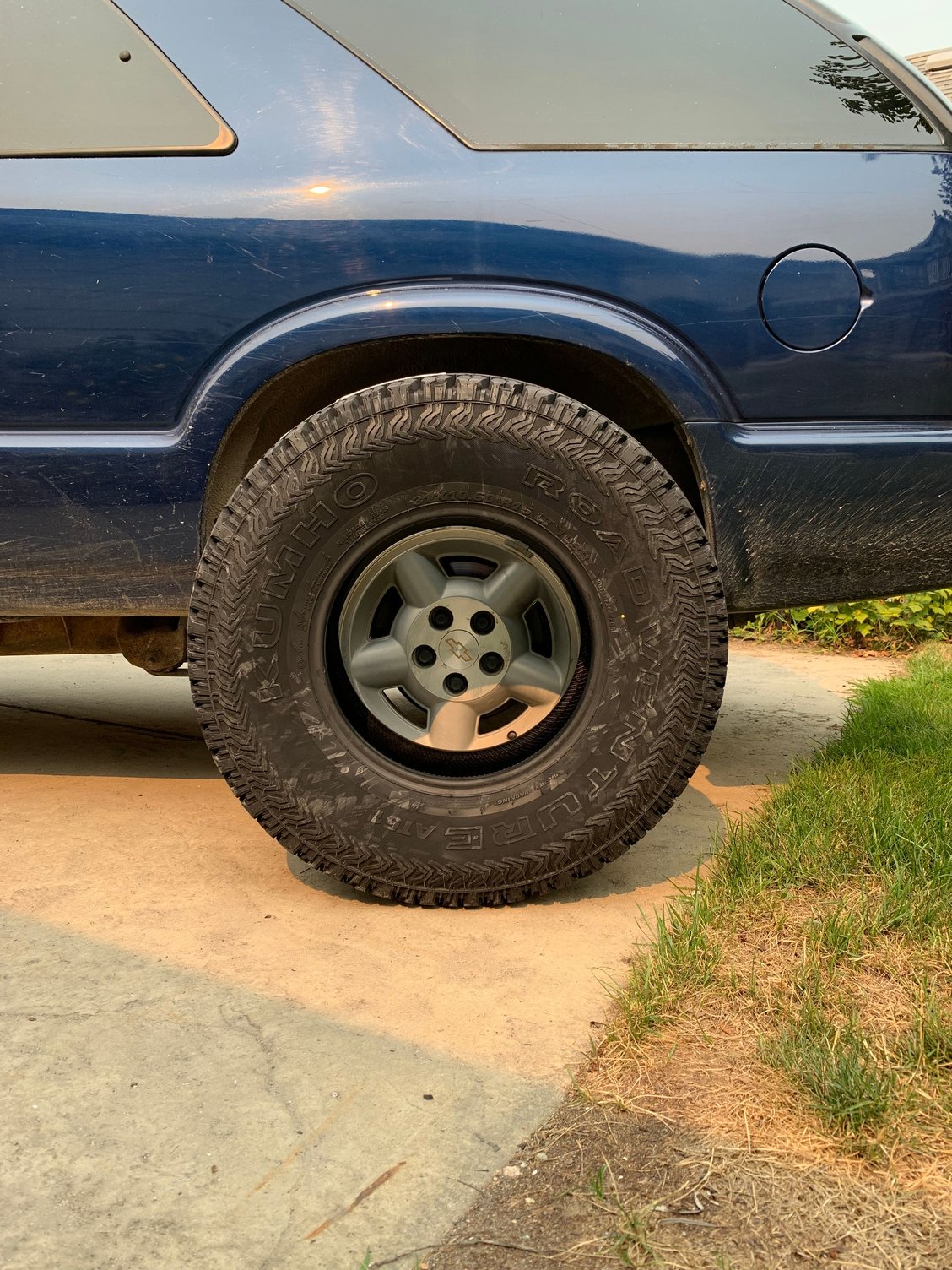

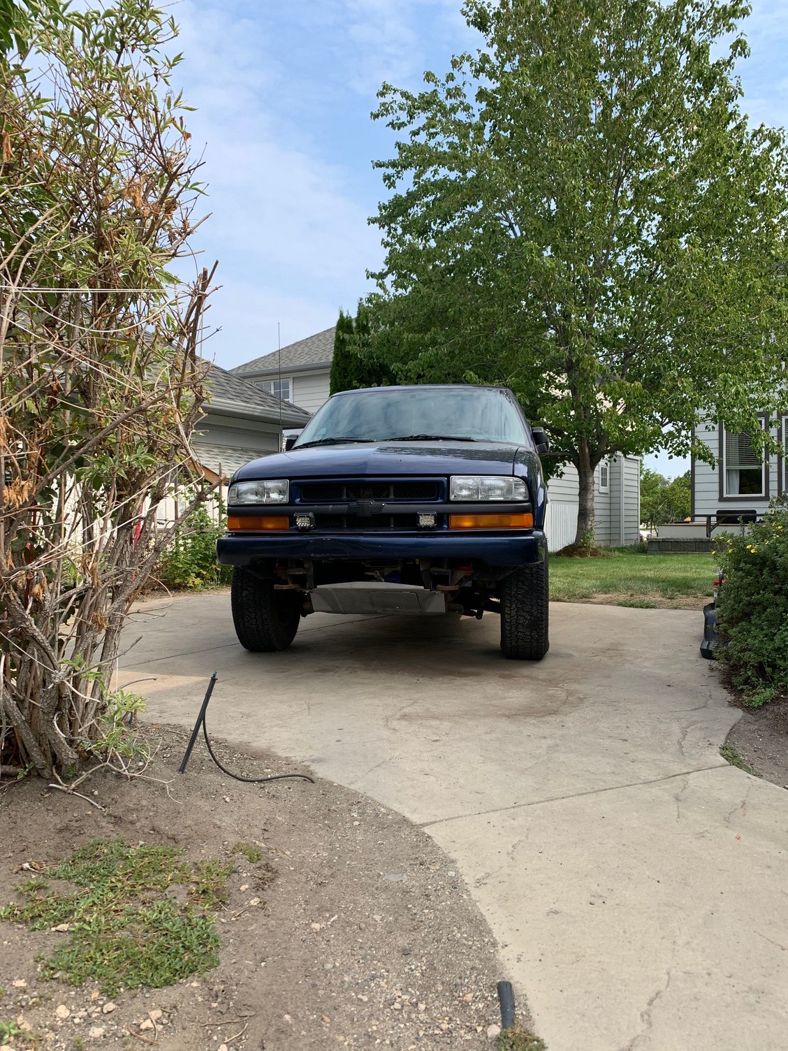

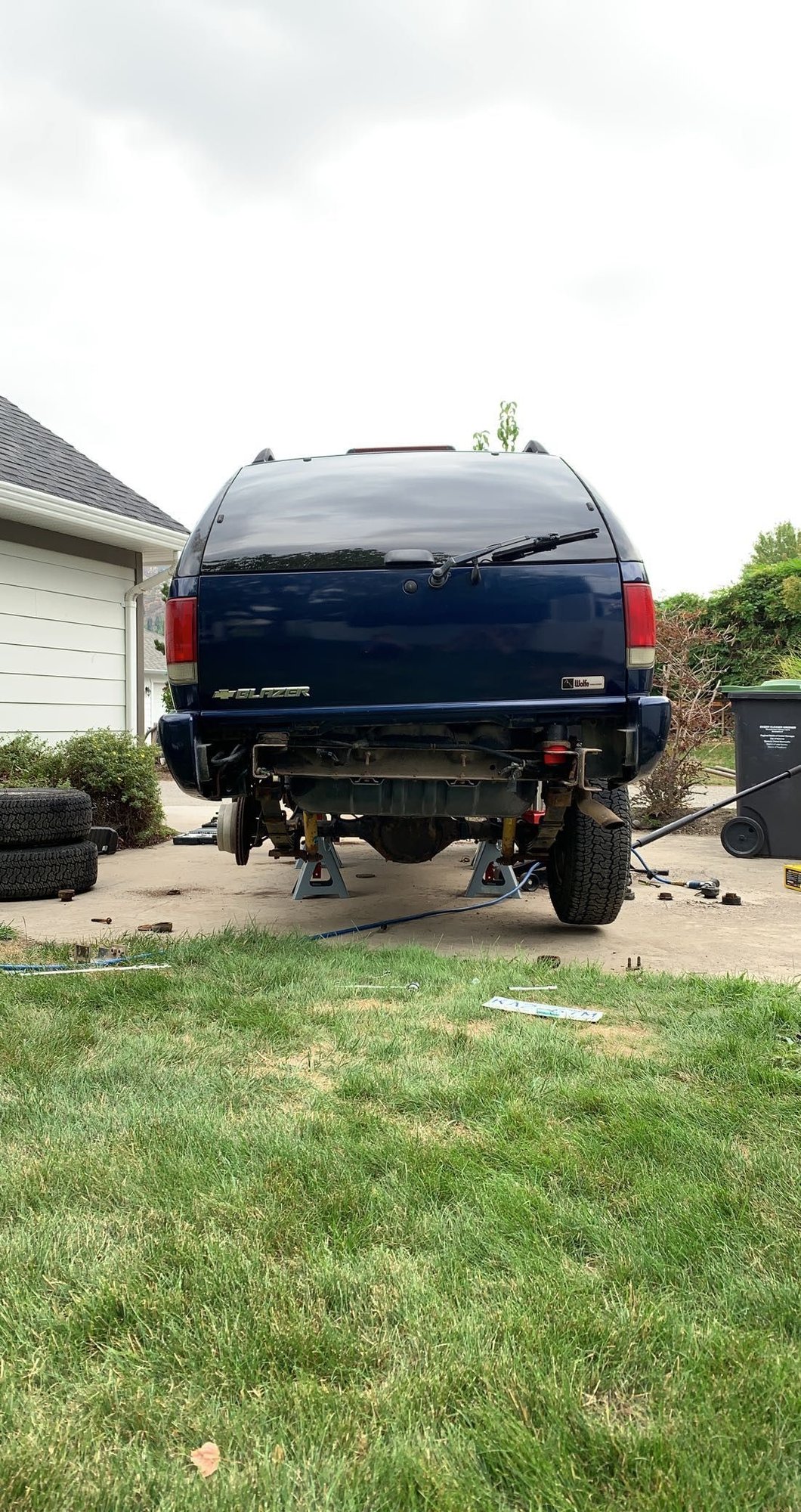

Here are some pics of the 2” body lift installed! It’s just itching for those 31’s
