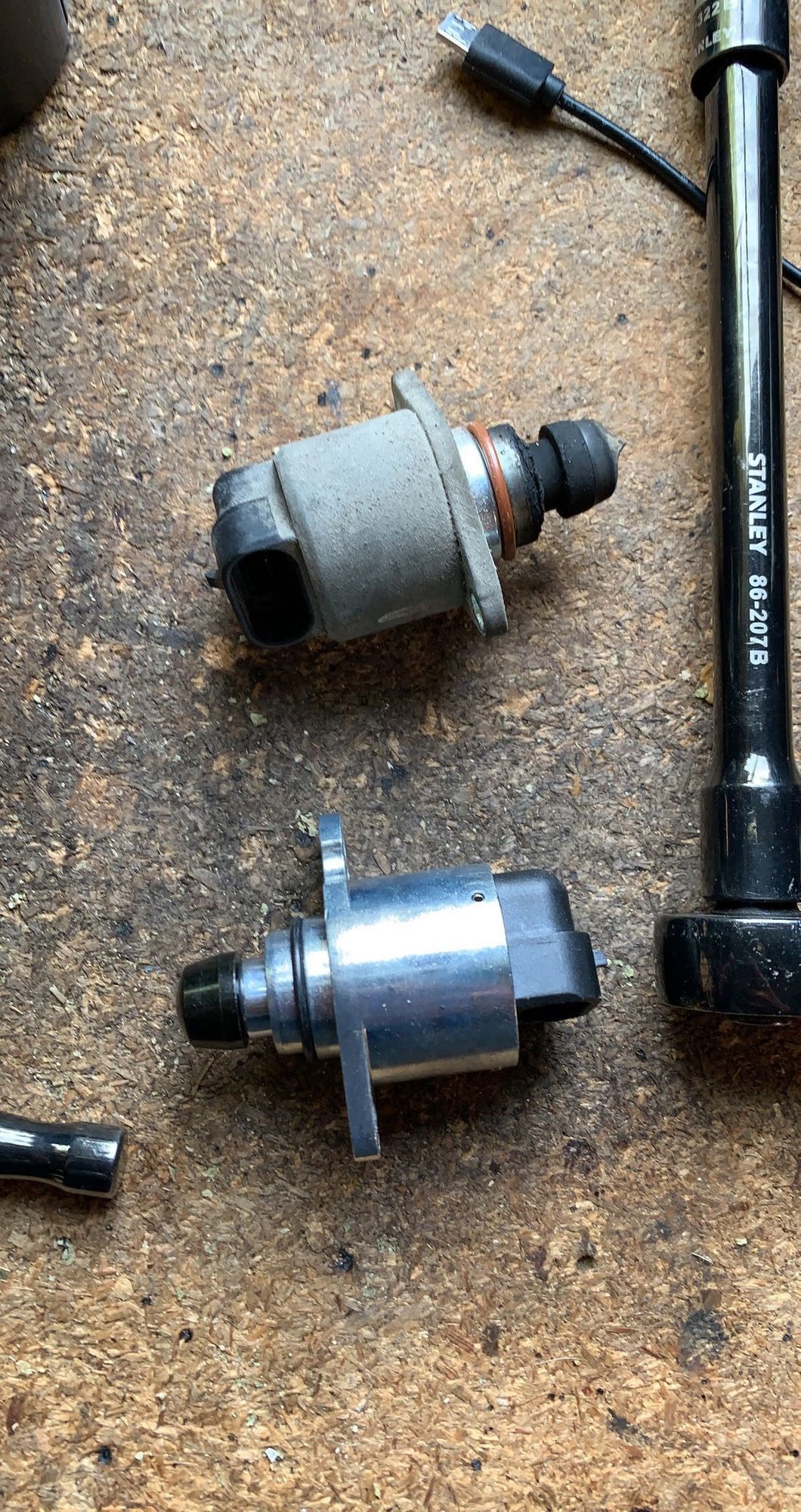

So I drove the blazer to work and back this morning, no issues with it starting again or any codes. Got home and took out the throttle body to inspect it, it was quite gummed up especially in the iac valve chamber, the iac valve was all black and gummed up. Cleaned it all up and threw a new iac valve in it and it is now noticeably stronger at idle and feels much better sitting in the driver seat. Hopefully this fixes the problem.

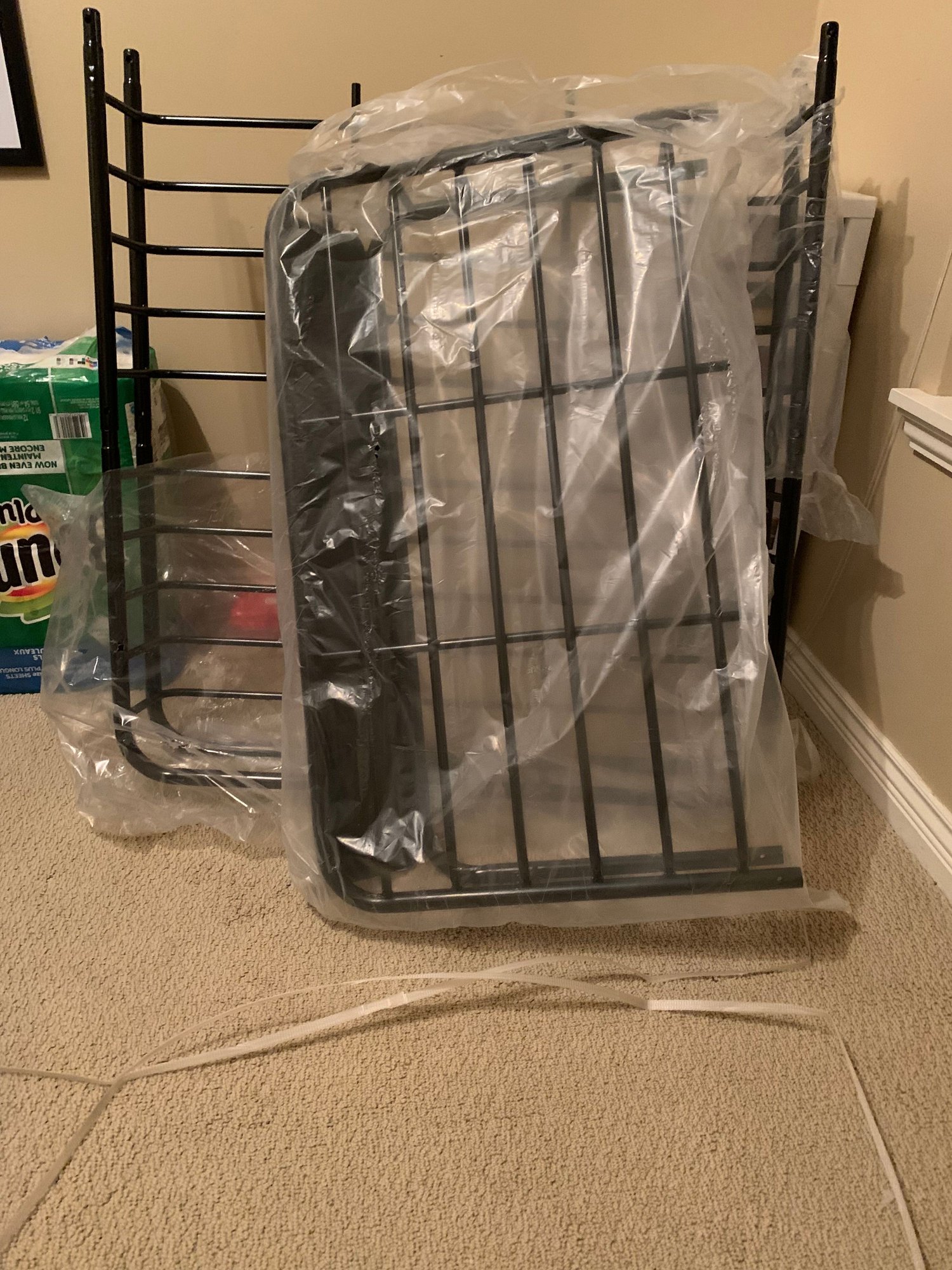

So the basket came in today! Going to put it on tomorrow hopefully, planning to put the lifted shackles on Wednesday afternoon and possibly Thursday depending on how it goes and also crank the t bars. I’m in for an alignment Friday morning and they are gonna mount and balance my new tires and rims at the same time. If all goes well it’s scheduled to be a new truck by the weekend!

Yeah the baskets are expensiveee I was planning on building my own but then I found this one on Amazon for only $300 Canadian and decided to just get it because it would have costed around the same to build in materials. I guess only time will tell how it holds up!

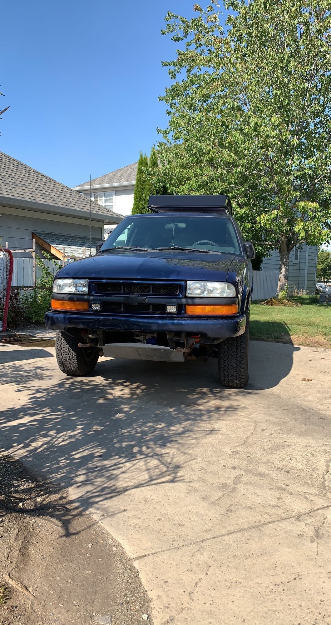

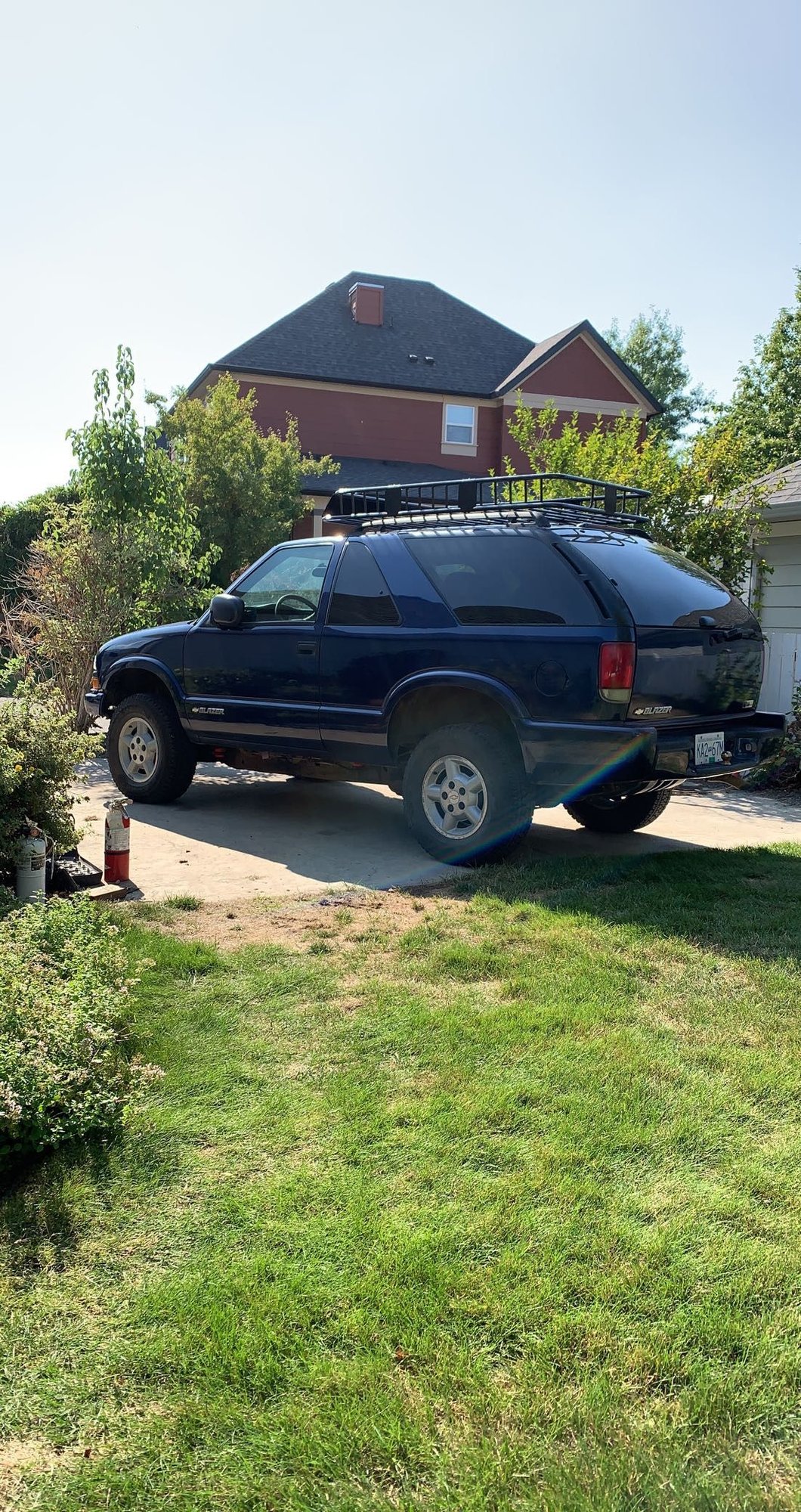

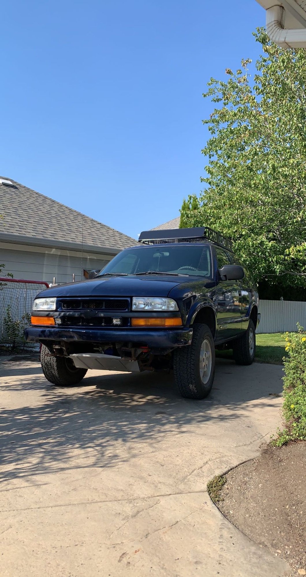

Basket has been installed….
