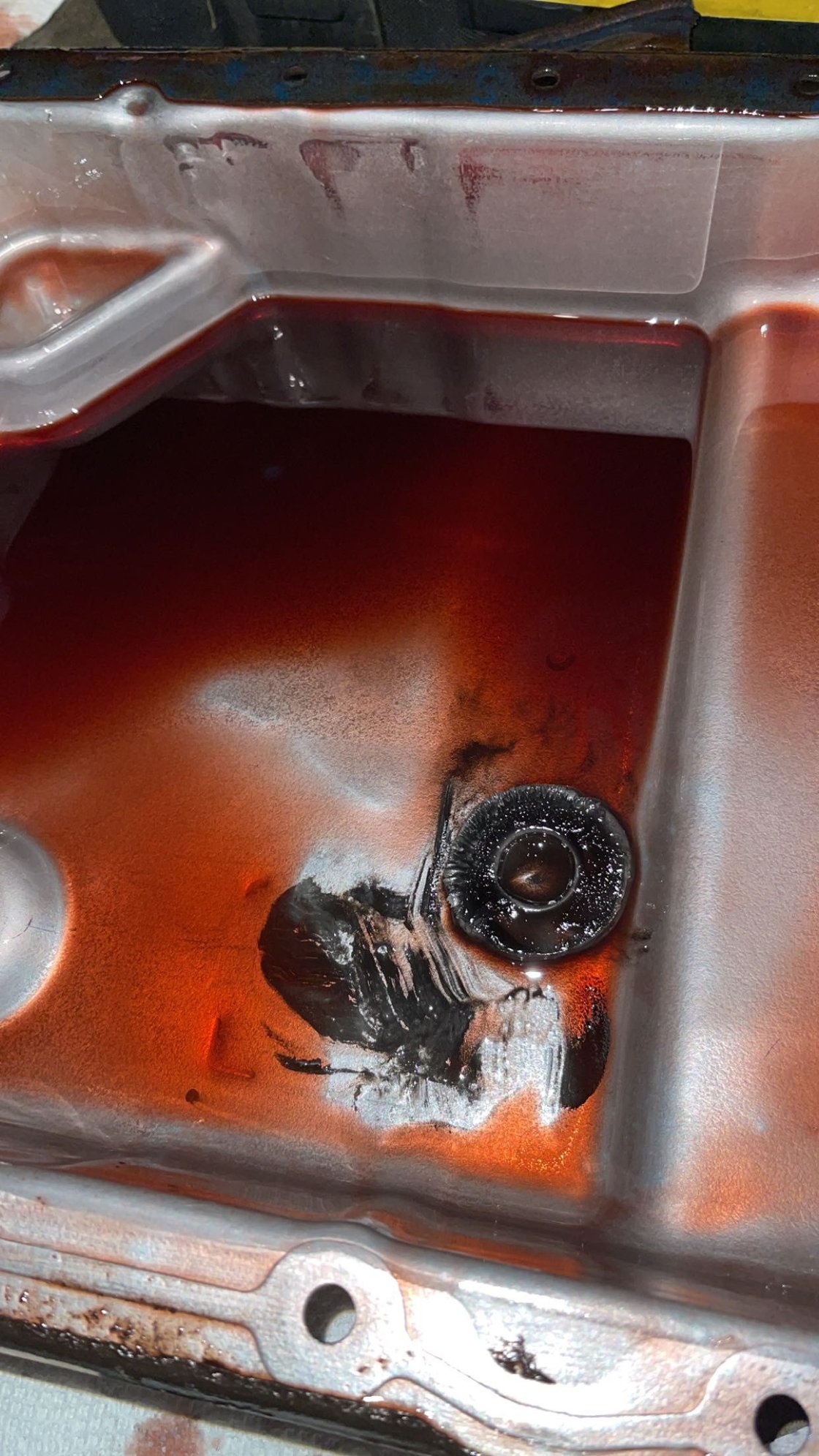

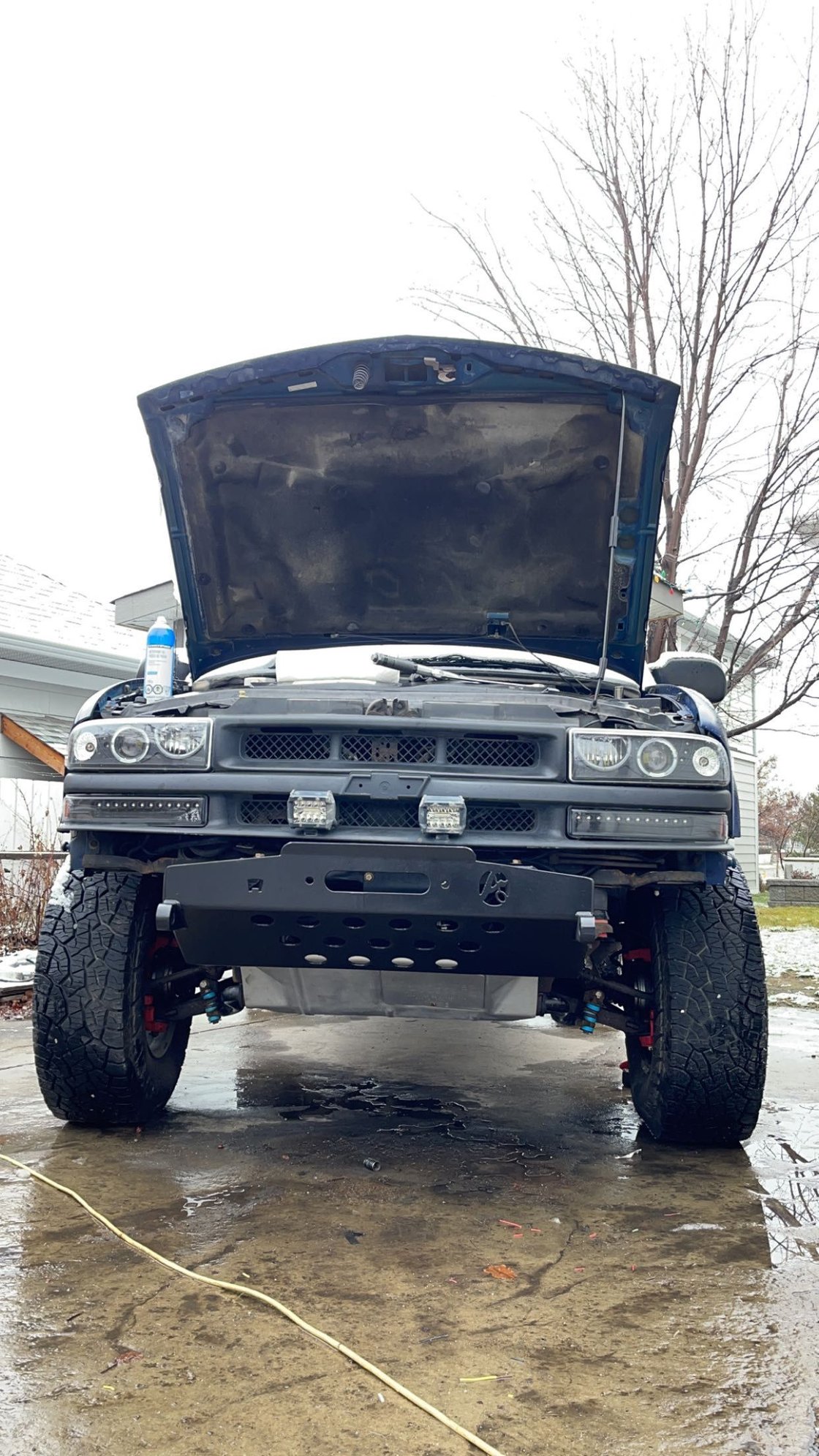

Project over Christmas break was repainting the front bumper, it came out awesome! Few days of grinding the old stuff off then prep for the por 15, then black farm paint on top, then clear coat on top. I had to put the POR on inside since it was way too humid outside, and I stayed up all night painting the one day. I also got some new front speakers in over the break, the same Alpine line as the rear, I was replacing them because I thought the passenger side was blown, turns out it's the tweeter that's blown in the dash. Unfortunately, the Blazer was down over the break as the day after my last Final exam I came out to wash the blazer and noticed a pool of oil under it, turns out the oil line from the filter to rad started leaking because it was rubbing on my front skid plate. It gave me some huge flashbacks to when my engine blew on the first drive after my exams were over 2 years ago, it's like it always gets me to where I need to go then lets me know there's a problem!
Now most recently I have finally dropped my trans pan and replaced the filter and pan, the pan was dented in 2 places from scraping on rocks so I figured I may as well replace it, I was stuck for a while with getting that filter in! I thought it was in, go to put the pan on, and the pan would hit the filter, it took me forever and putting the old pan back on to realize I just needed to push the filter in further.

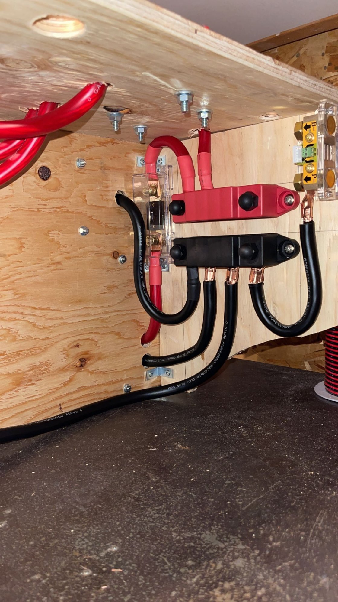

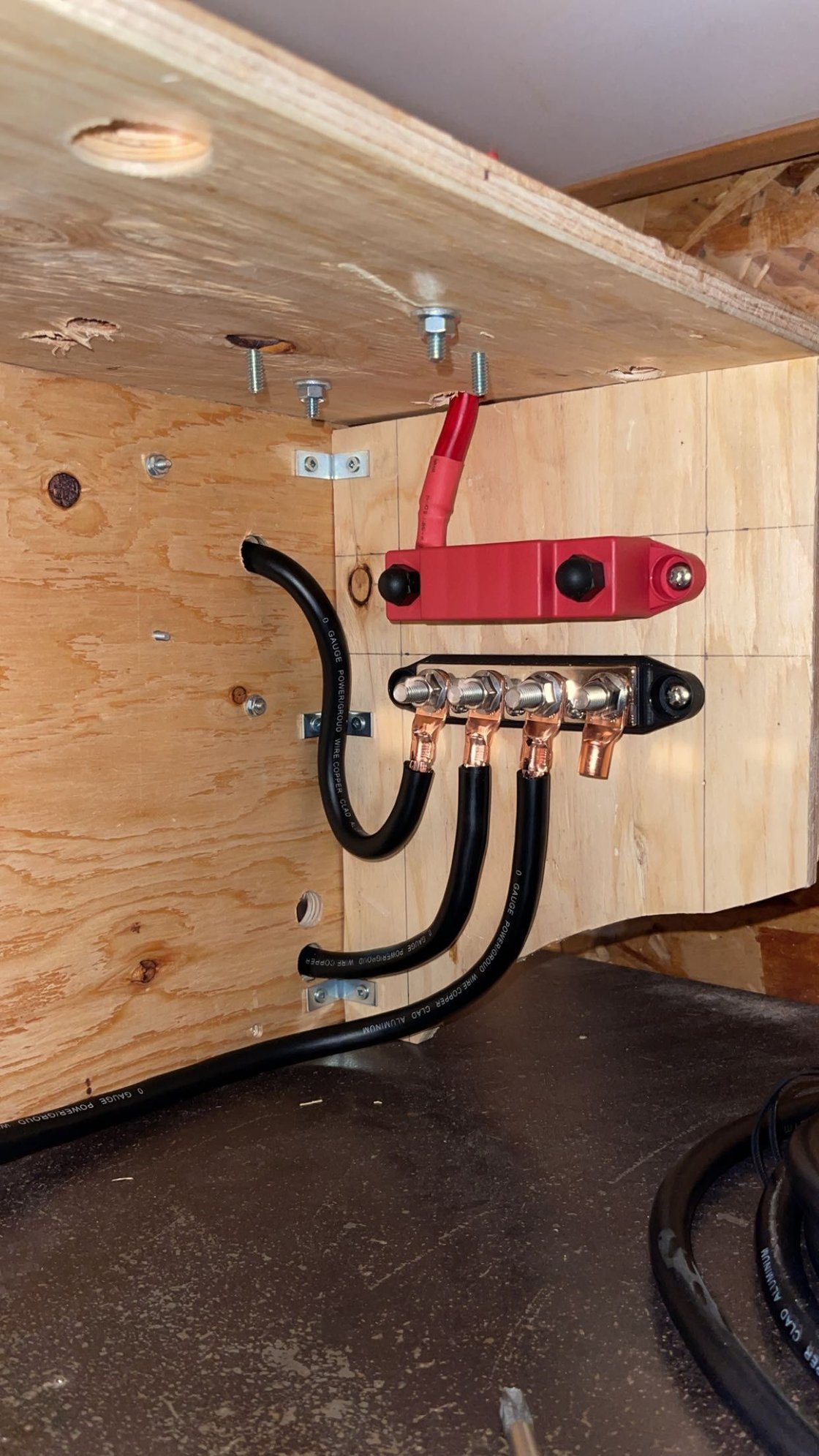

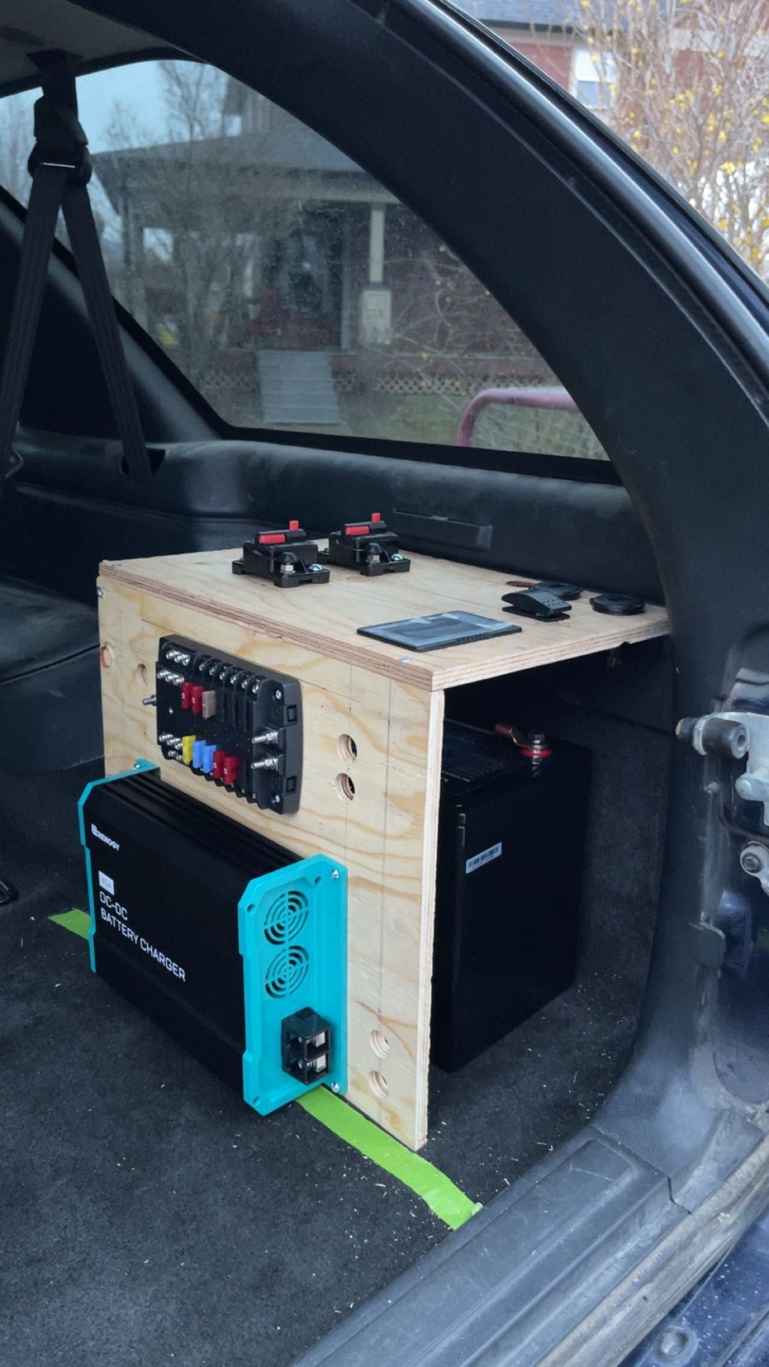

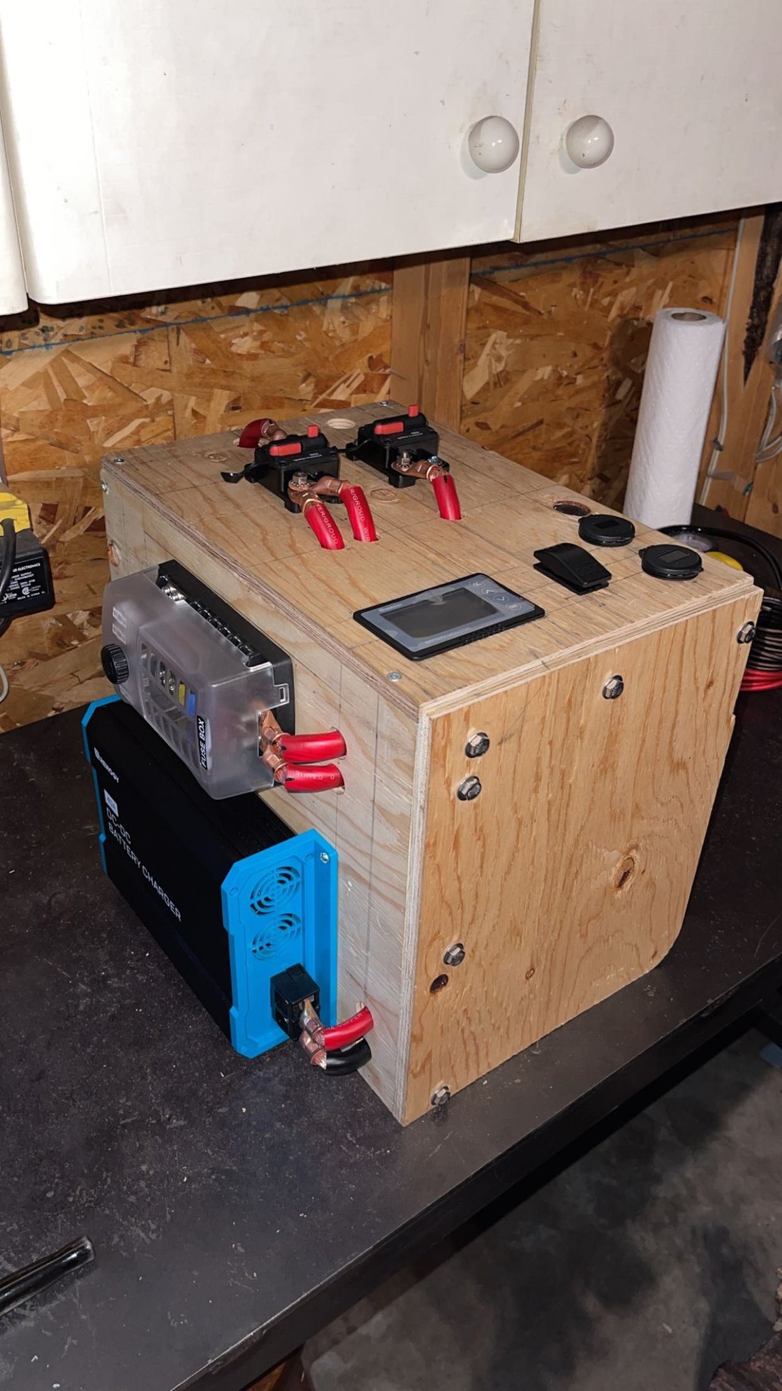

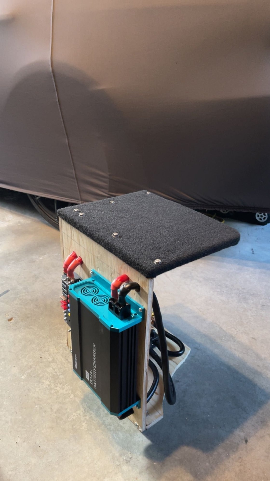

Hello everyone! I finished school last friday, the trip across Canada is closing in now with just 60 days until I leave. I have some BIG updates to share with you guys! I was so busy with finishing up my degree in the past month I hardly had time for anything but studying. I still managed to source a lot of the parts I need to start working, the 12v system is about 90% complete now, if I started explaining all that's going on we would be here forever, so here are some pictures from along the build.

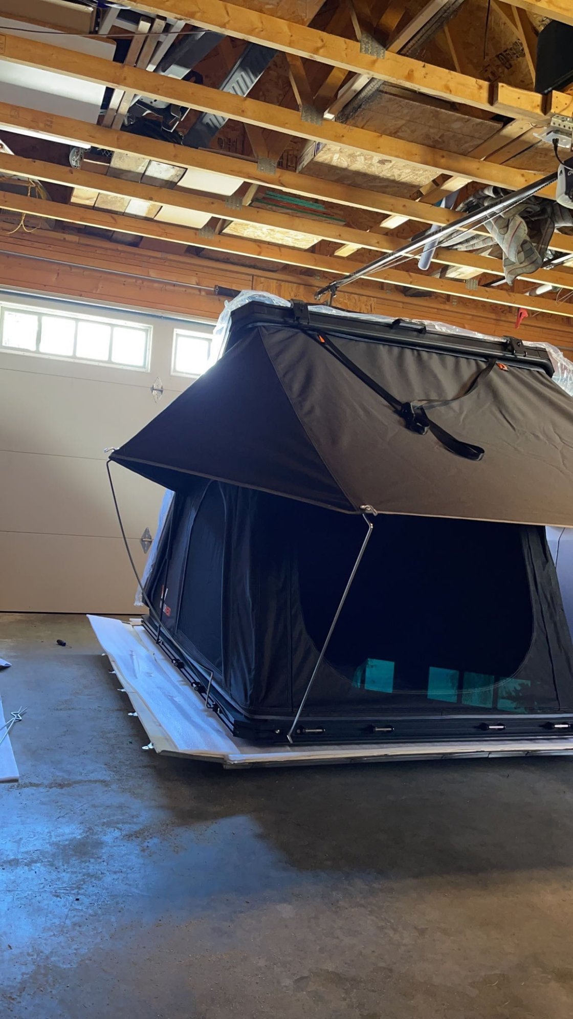

So that's the 12v system, I really just have to secure the box to the floor and fabricate the battery hold down. Next up I'll be doing the big 3 on the primary battery and finally running the wire all the way to the back then it will be operational. The exciting news doesn't stop here folks, I went all out with the naturenest hard shell roof top tent! I was able to get a small discount from them in exchange for sharing my thoughts after I install it, I have only had it open in my garage so far but it seems solid. I'm currently waiting for some grommets so I can drill some holes in the tent and install an Anderson connector to give power in the tent, after that I should be able to mount it. I was originally thinking of making a new roof rack to carry the tent mainly to have the tent sit closer to the roof with no gap between, I'm now on the fence about this and decided I'll put the tent on and see how it all looks. The tent is definitely a little big, it will take up the whole roof and then some on my small 2 door.

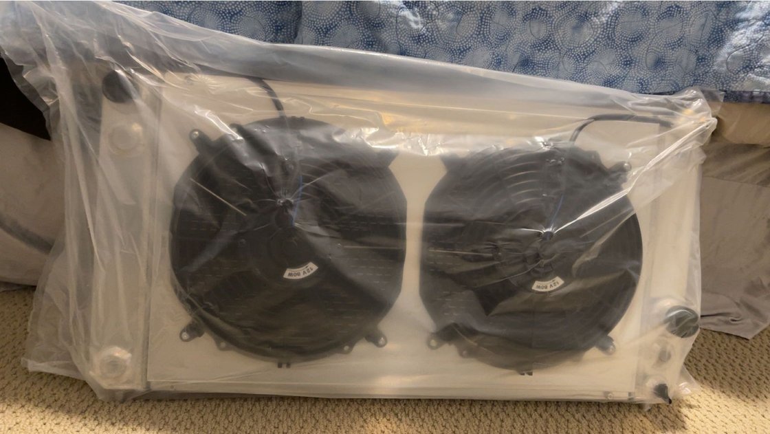

Last honorable project coming up is the 3 row aluminum rad with dual electric fans, this will be a big upgrade as I plan to have the whole front apart and weld up the rad support at the same time where it has been cracking.
