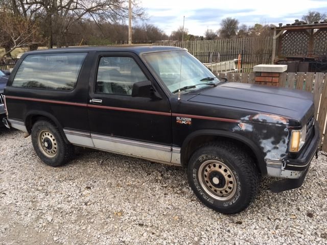

The Project: Here is my 84 blazer. I had this truck in high school when they were still really popular for kids. I have toyed with it a few times over the years, but now I am ready to get serious.
The Plan: ............Add all the great ideas that I will never get to here........... Realistically, I want to have 1 fix/repair per week and keep moving forward, till its useable and somewhat safe to drive. Then work on big budget fun stuff. Ultimately throwing many thousands of hard earned dollars at an HOS that will be barely worth the weight in scrap steel when done.
The reason: I need a 4 wheeler, and I have another couple projects I want to build that will take some experience and skill. Id rather make my mistakes on this one.
First repairs: Rebuilt T-5 OWC, I did the trans rebuild in 2017 and bought new tires for it in 2018. Used it a few times, but I realized that the sloppy steering, barely adequate power, and horrendous road noise made it pretty unsafe to drive on modern highways, so I abandoned it again in 2019. Got it fired back up over thanksgiving break. I had some time after church on Sunday so I did the AC compressor and smog pump delete. Runs much better, but still wants to cough and stutter under load sometimes.
Up Next: Find a space for the parts I take off, brakes, gauges, and sealing up the cab.
1984 blazer sport trim

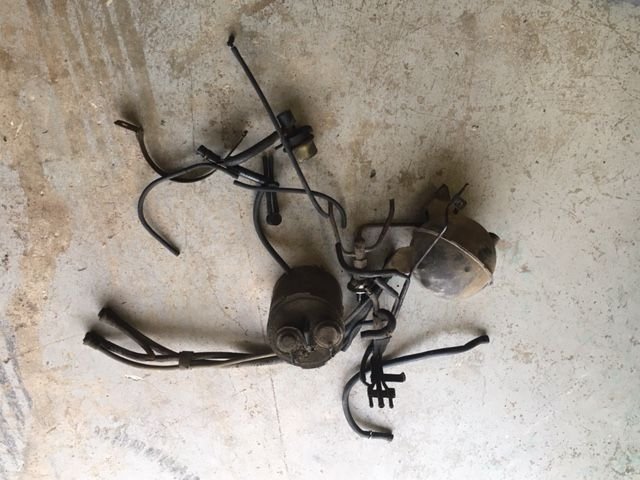

AC compressor removed for space
Smog pump removed for science

Took a few weeks longer to get back on this, it got cold here. Anyway, my emissions delete program had some bugs that needed to be worked out. these old Rochester carbs are pretty dang complex. I got back in and deleted out the remainder of the vacuum pump circuitry and other odds an ends. Plugged up all the vacuum ports on the carb, which turned out to be a mistake. Apparently the idle circuit needs to be open to the air cleaner, but hell, it looked like a vacuum port to me. I cut off the weird exhaust trees and welded up the open holes in the manifolds. I listened to that silly crackling noise for far too long.

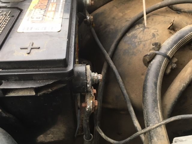

Battery Cables: I got some descent cables from an explorer at the junk yard. No more puny side post screws to bugger up and corrode.
