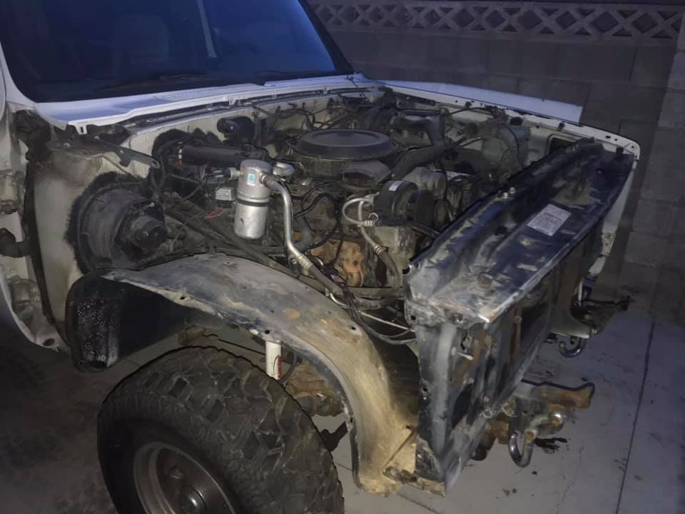

Their is another option I did not throw out there but it was because two different mechanics told me I should stick with the small block, but a few years ago I bought a 1977 Chevy Champion Motorhome. I got it for $800 the motorhome is crap but it has a sweet 454/400HT in it that only has 56,000 miles on it, the guy that owned it was a mechanic and kept it up, just used it for a hunting cabin up in Colorado mostly. I was originally going to use this motor and use it swap out the 350 but again i was told it would be a headache so I got discouraged. So you guys tell me whats the issue here. If I did do a 454 swap can the blazer handle it or will i just shred the transmission, transfer case and differentials? and as I assume I gotta upgrade all that plus maybe more springs etc. So what do i need to be looking for? Any links to parts etc would be appreciated so I can at least get a ball par figure on my cost to go one way or the other. I mean part of building a good truck and making it something that a real owner would appreciate is in the details. So far I have the whole front end off and have stripped everything down to bare metal and gave it all a nice coat of rust encapsulator paint. Just need to figure where to go with this motor thing. I won't lie the 454 is sitting right there but I don't want to go "damn its to powerful and won't work"
