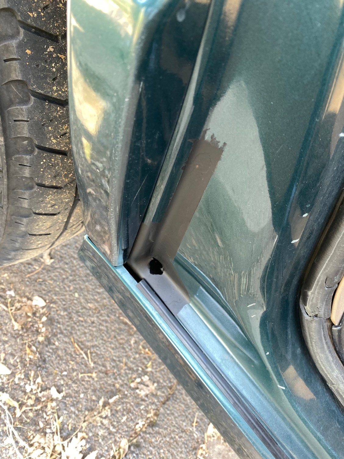

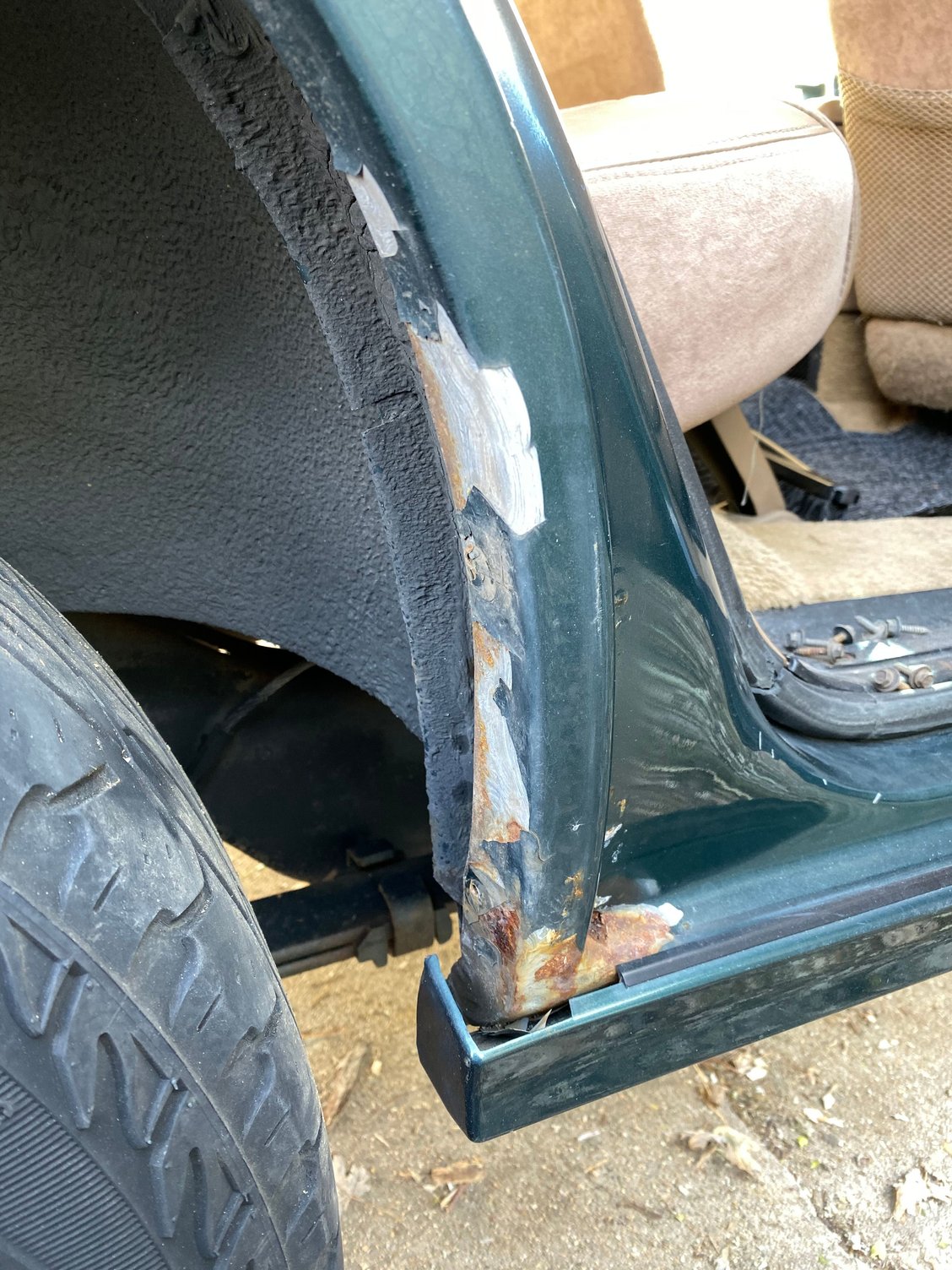

Well...what should I do about this?

That's not too bad at all! I would sand the paint and rust off, slap some primer rust paint and then color match.

There’s a hole in the inside corner that goes all the way through. I don’t have a way of welding new metal in there.

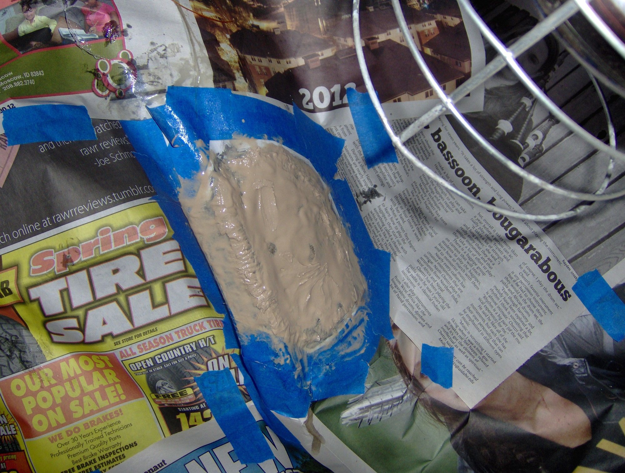

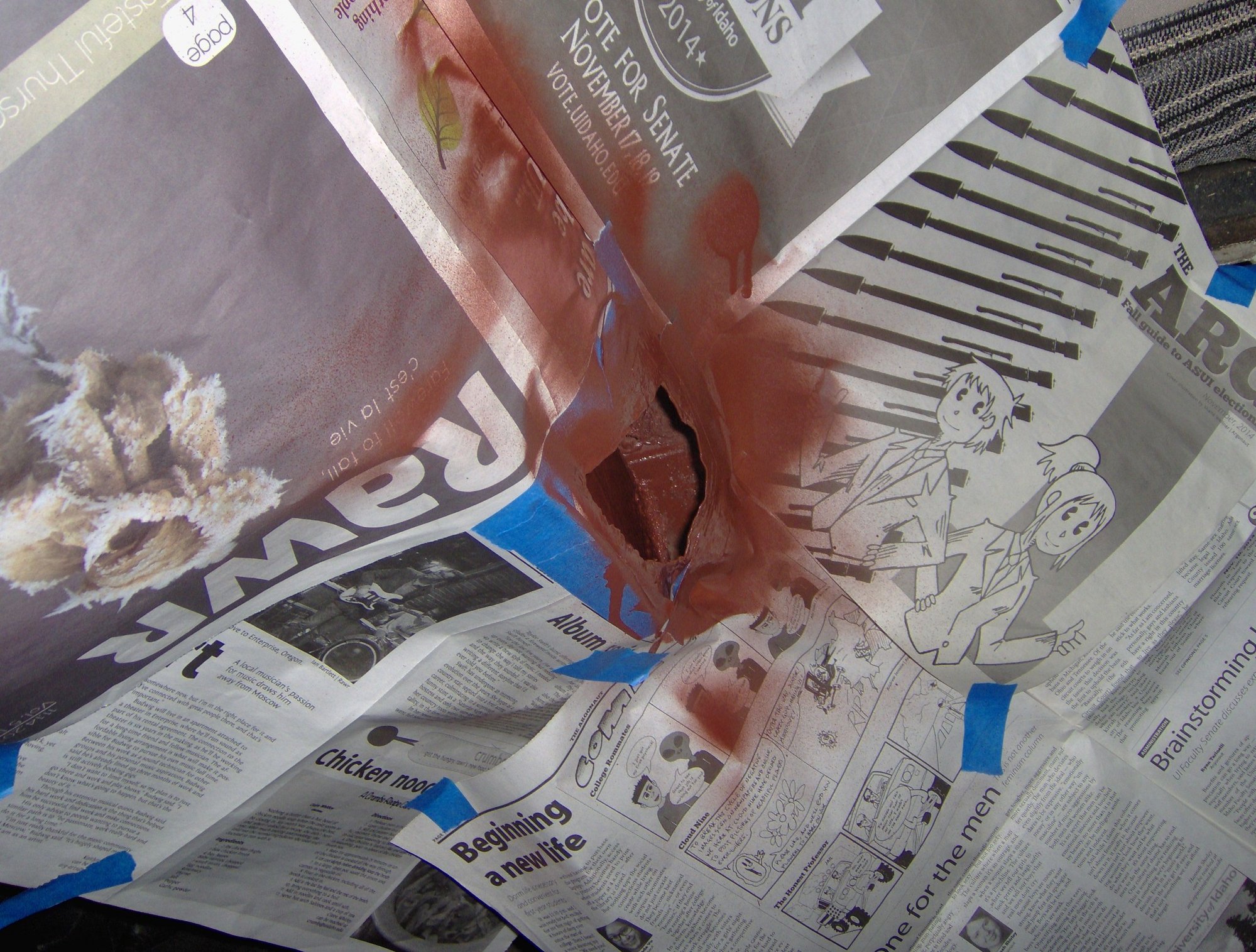

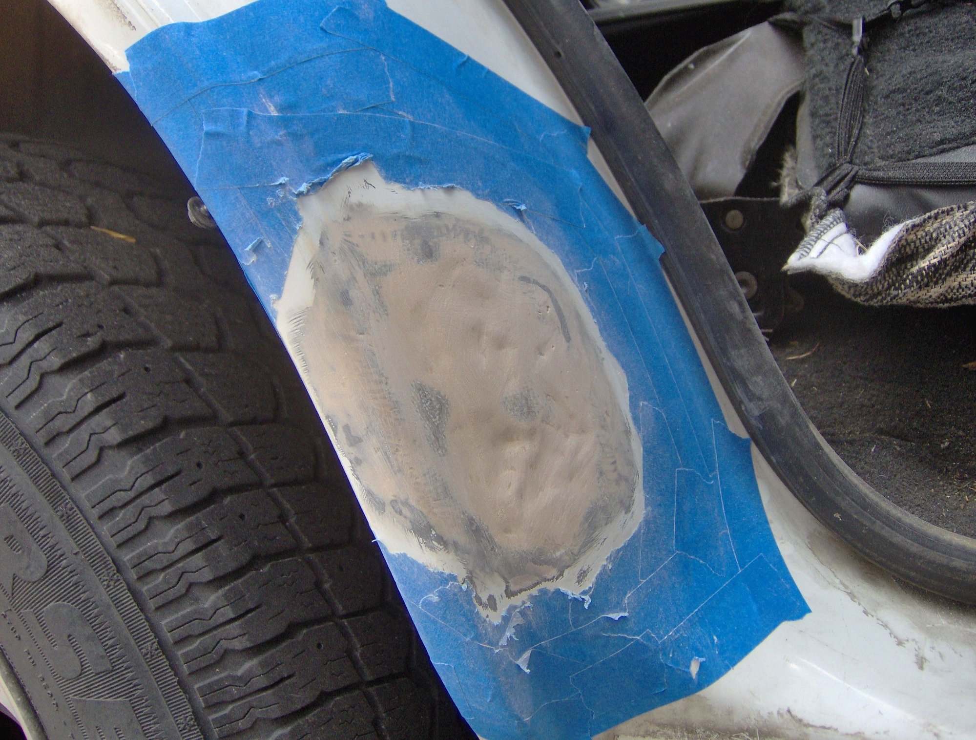

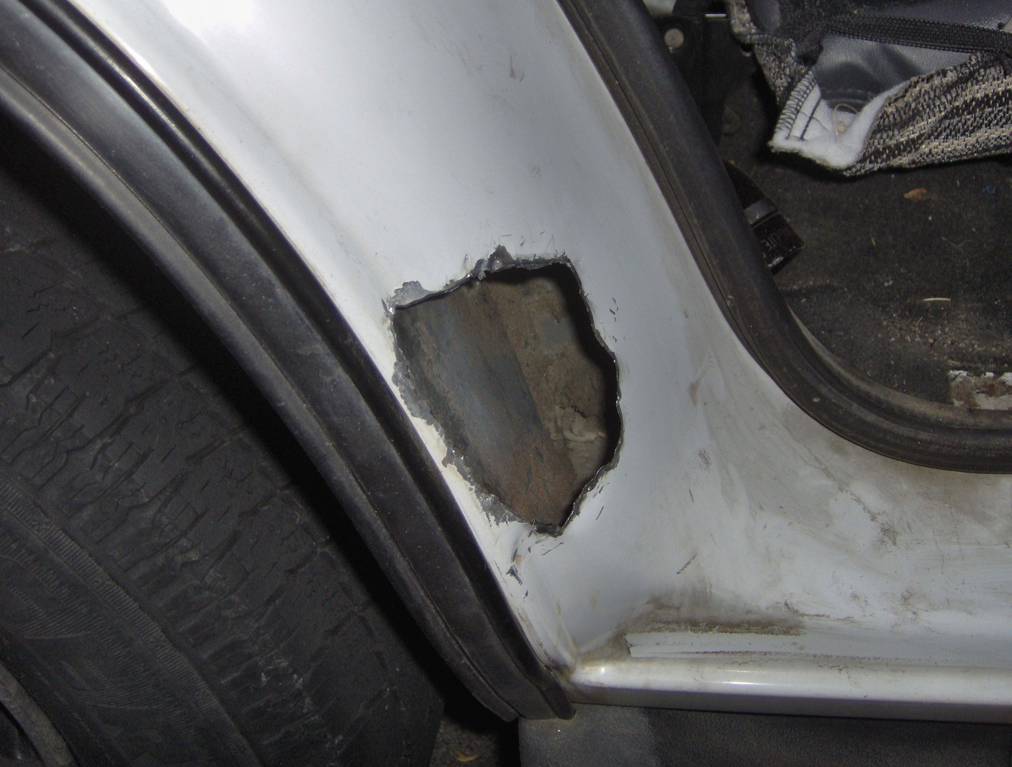

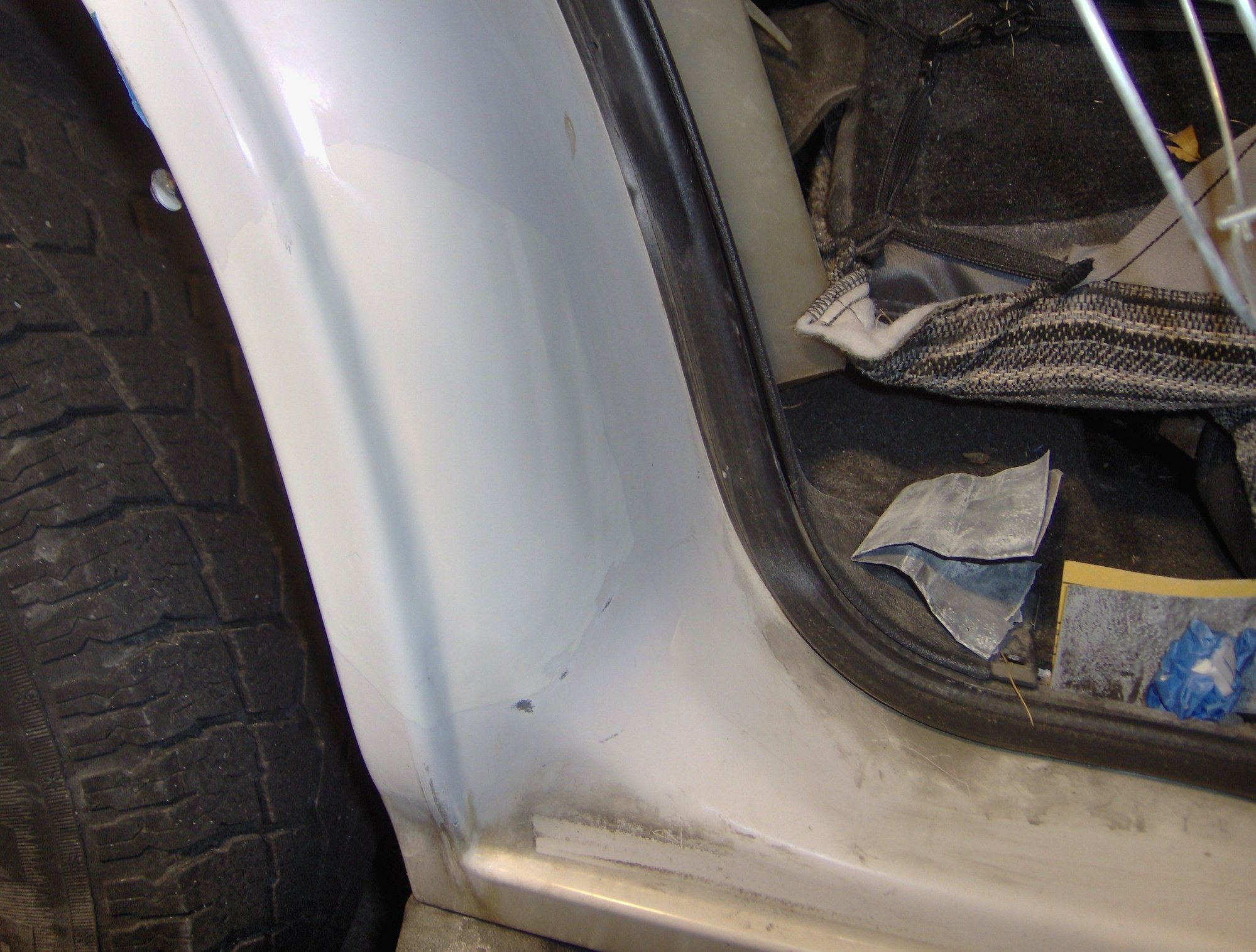

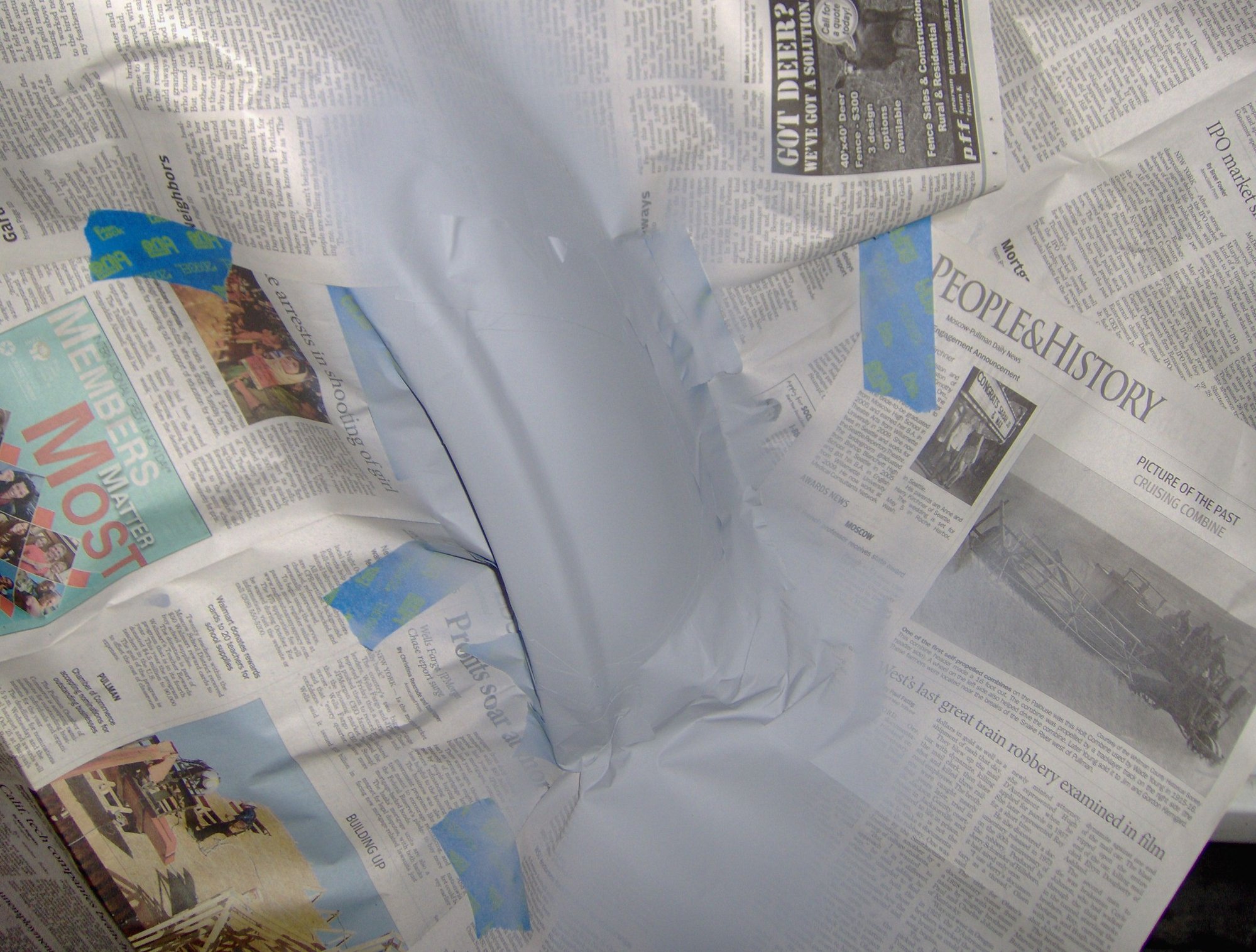

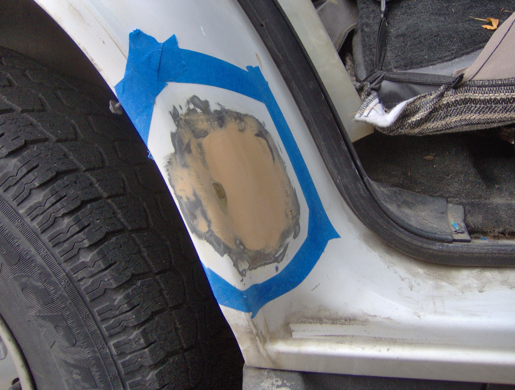

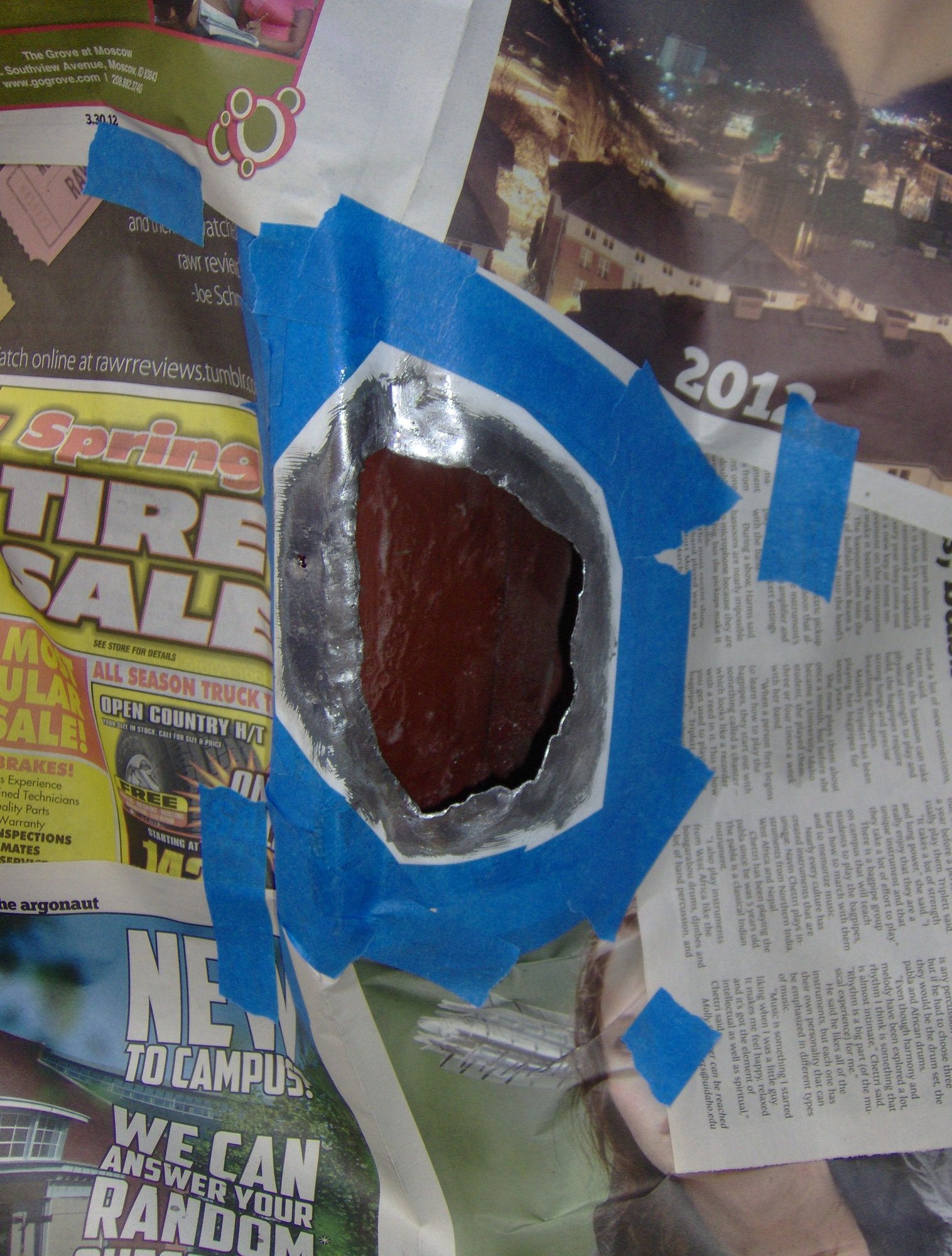

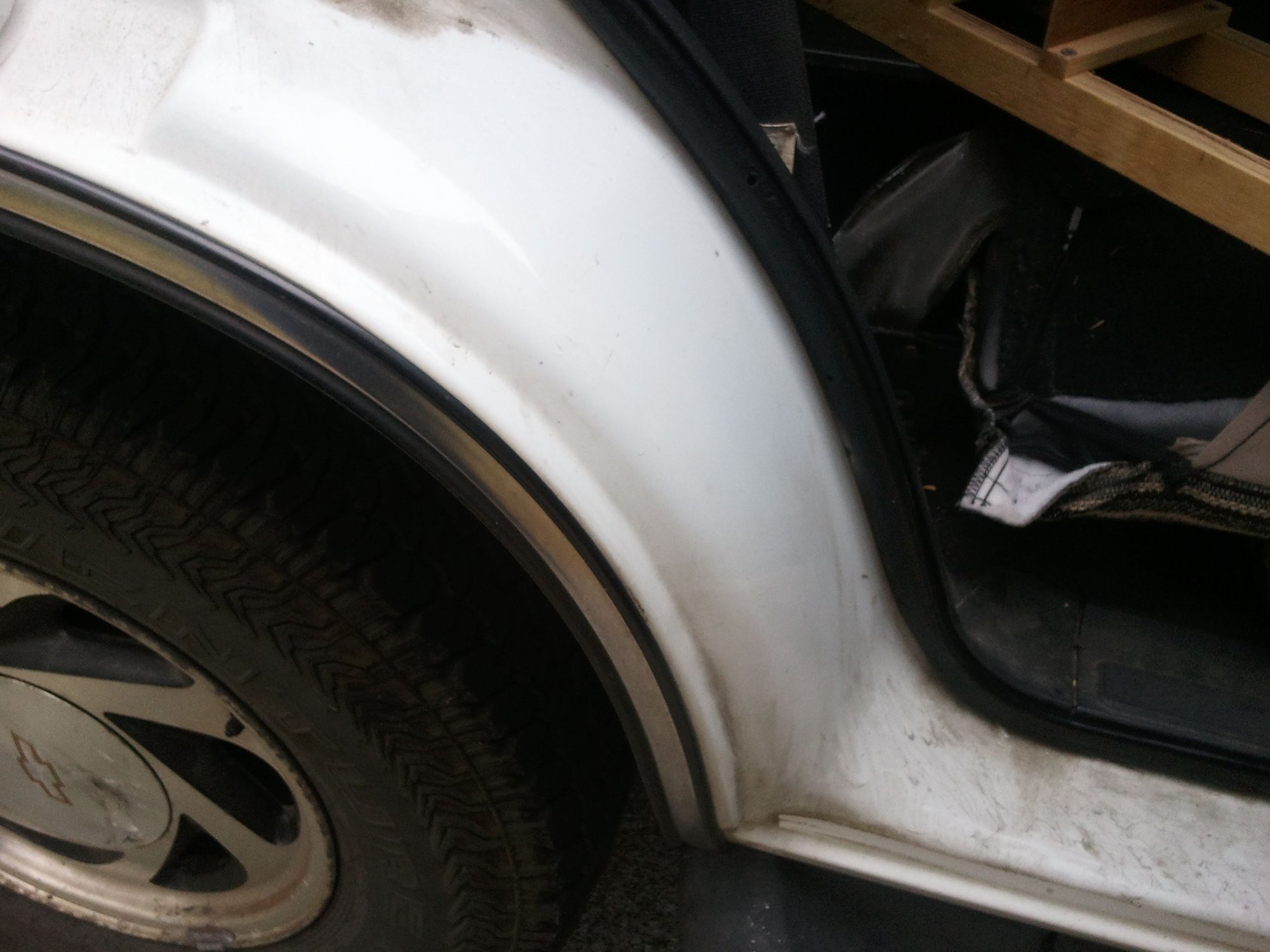

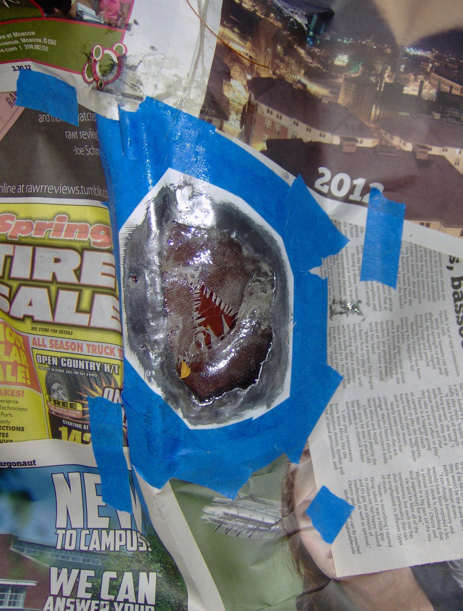

Is this covered by a fender flare? If so, I'd cut back every last bit of rust and neutralize it best you can (rustoleum, naval jelly, etc) and then cover it back up.
If you need something to be replaced, you might try fiberglass and epoxy. This is what I used when I found a rust hole on the top of the wheel hump in my back door from internal corrosion. I cleaned it as best I could and then sealed it using West System Epoxy. This is different than the fiber-glassing kits you get at auto-parts stores or at the hardware store. It will bond to clean metal. The last picture is from two years after the repair. I don't even think about that it is there.
Here are some pics. The repair was done in Oct 2015:

Yes, it’s mostly covered by the wheel arch trim. I took a wire brush to the spots that had rust, and then hit it with Rustoleum Rust Reformer for now.
The hole just looked like a bit of surface rust with paint peeling around it until I started poking around at it and peeling away the paint. The other side of that is the inner wheel arch, so as long as I can get all of the rusting metal out of there, I might be able to fill it in and keep it from rusting again. I’m just terrified that if I don’t have it welded, I’m going to cause a bigger problem in a few years.

I'm sure there is more experienced people here who can address the welding issue but I'm not sure that welding will necessarily stop rust. I think I was told that by a body shop once.
Just make sure you get all of what is inside coated and sealed too. My big hole that I fixed on the outside looked like a pin hole. To get to good metal to which I could epoxy, I had to make the hole as large as you saw.

My driveway fix for rust, and mostly last, cut out the rust, I rivet a thin sheet as I dont have hands on welding, then bondo, prim, paint.
On a hole that small, if theres no more rust, can get away without the sheetmetal.
