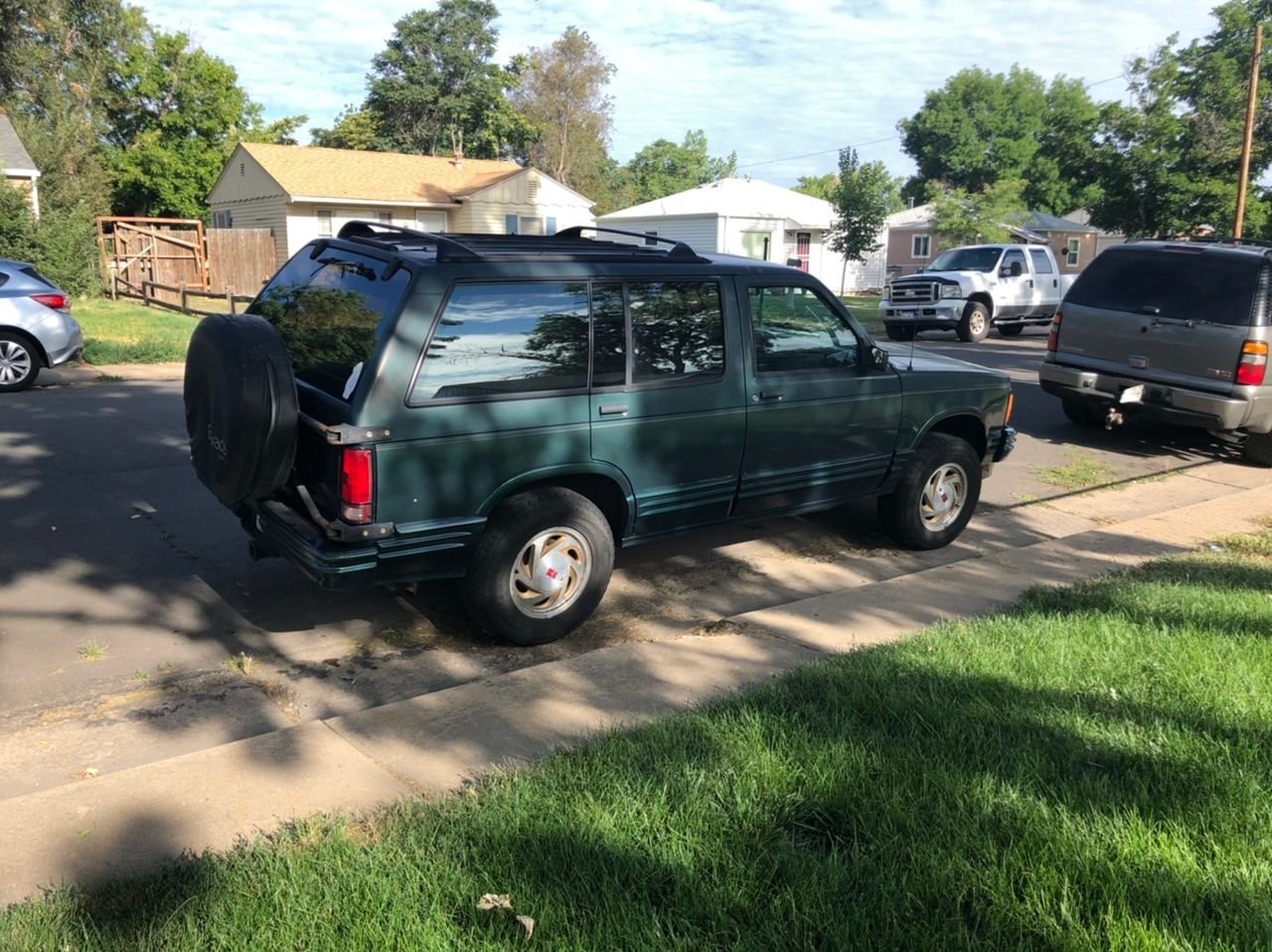

I also waxed the car yesterday. It’s parked on the street, facing north most of the time, so the driver’s side gets hit with the afternoon sun, so the paint was looking pretty flat again. I put three coats of wax on the hood and portions above the body line. I put two coats on the parts below the body line.

Ahh, good it was an easy fix.
The color is going dull on mine as well. My 94 Blazer had no clearcoat on it. All the sides with repairs are shiny , except of the right rear door, right aft side and the roof.
Never done repairs there. Waxing helps.

I used Meguiars Ultimate Compound on the whole car almost two years ago, and it brought the shine back to the whole car. If I would have waxed it every couple of months, it probably would have been fine. I may have to use the compound again on the driver’s side, but I don’t want to do it too often, because I don’t know how much paint I have left to work with. Every time I wax it, I have a bit of paint coming off also.
