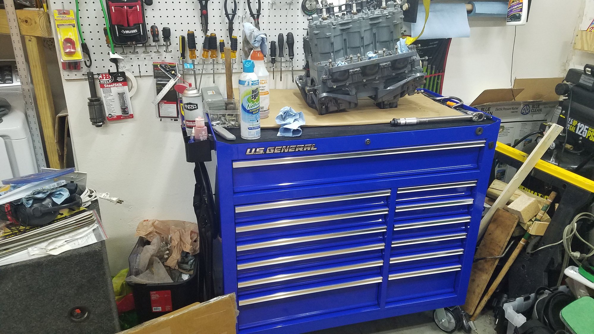

On another note I finally got a big boy tool box the other day. So nice to have a place for tools, so I don't have to rummage around looking for them.
Lol, of course I quickly filled up the box, and already need a bigger one. Fortunately HF sells add-on cabinets and drawers, so I can expand.

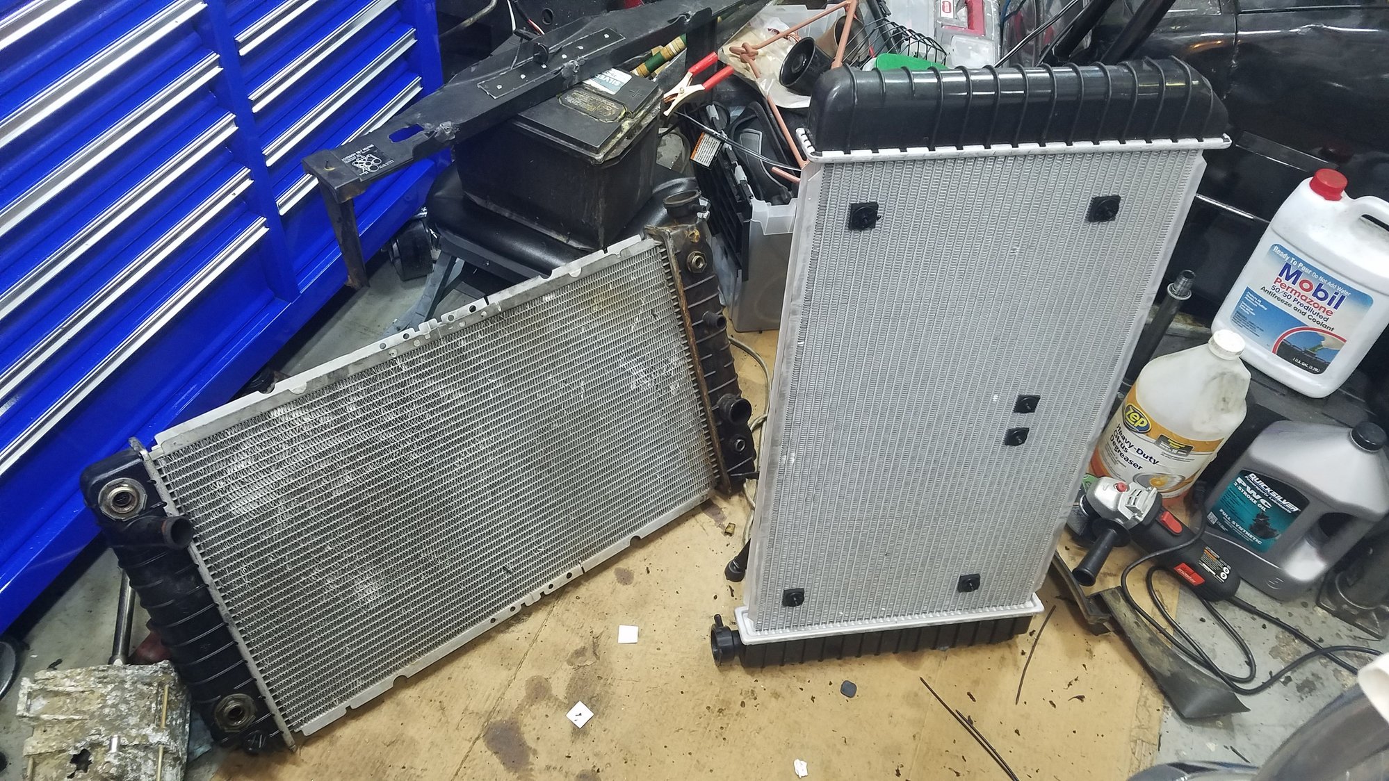

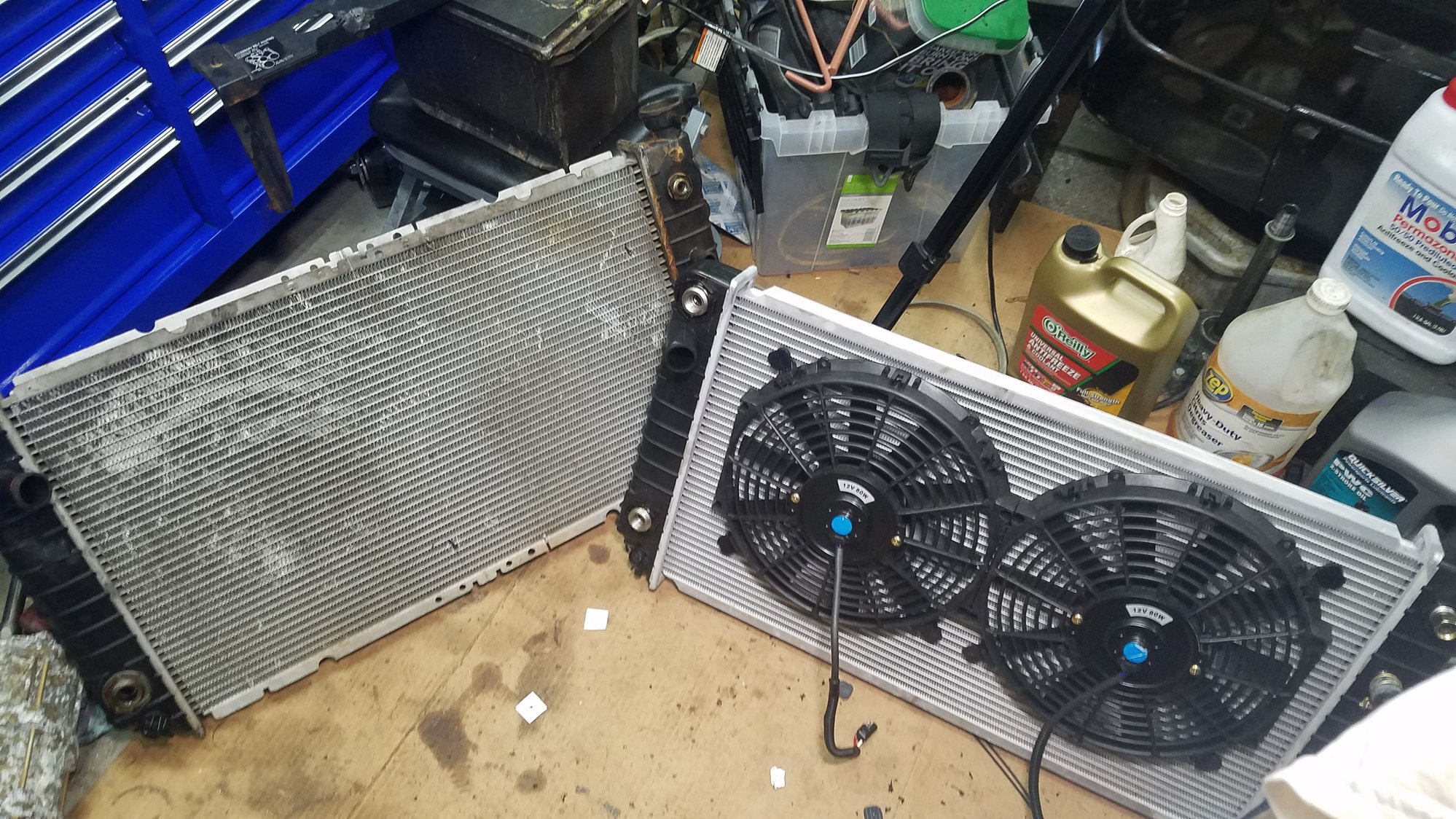

So since my last post I've been having more issues with the Blazer running hotter. . . Between it being hotter outside, and because of that using the A/C all the time now. Also, from the previous post I fixed the no air problem by installing a new blower motor.
Decided to bite the bullet and ordered a new radiator. I would have gotten a bigger aluminum one, but wanted to keep the OE Trans & Oil coolers. Just got that installed yesterday, along with trimming down the upper and lower OE fan shroud. This time I tried to install the fans a little higher on the radiator.

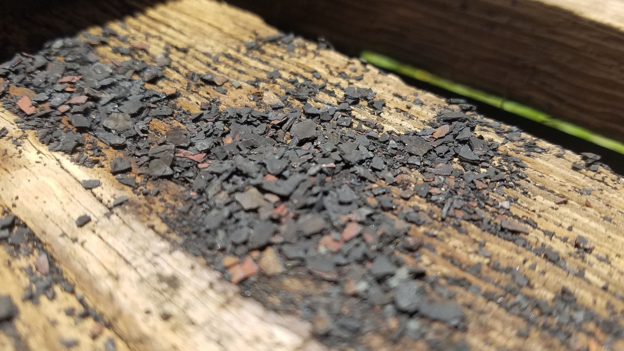

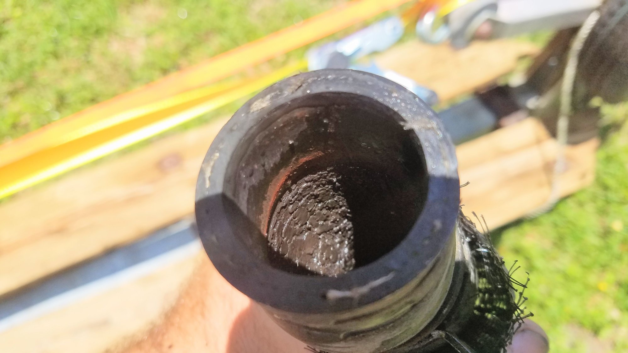

A while back I had found the hose to my overflow tank was totally plugged up with gunk, so when doing the rad I fully removed all the hoses to inspect. Good thing I did. . . They all had a bunch of black crusty build up.
I squeezed the hoses, used a long screwdriver to break it all up as much as I could. Then went out with the pressure washer and really went after them. Turned out pretty well, glad I didn't have to go spend $100 on all new hoses. Here's just some of what came out:

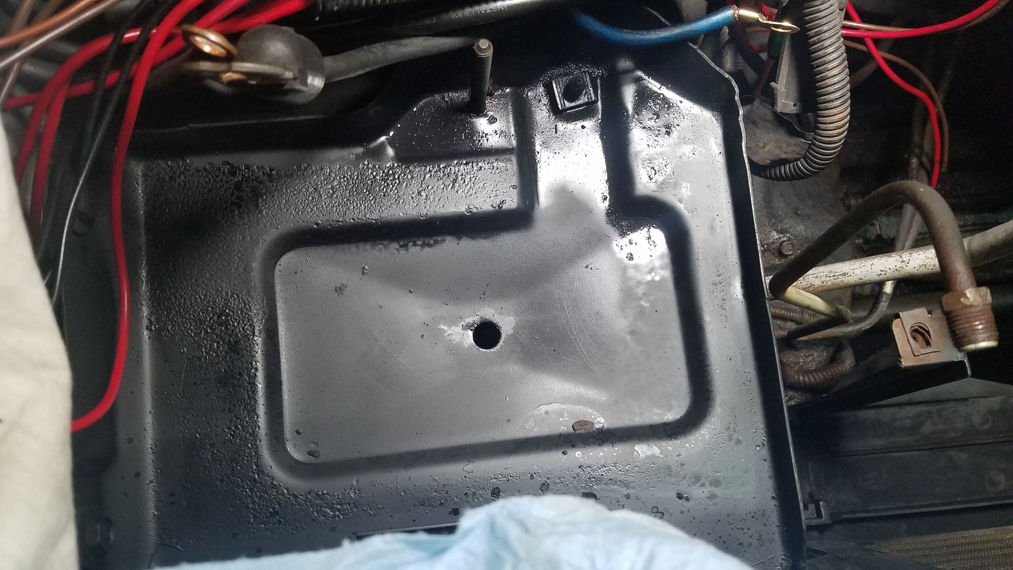

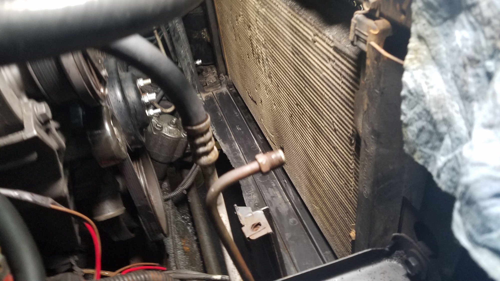

While I had things apart I cleaned up a little, and hit the bottom of the battery box with a coat of rust reformer. Fixed a few fins on the condenser as best I could.
After putting it all back together and letting it run in the driveway there's definitely an improvement. Without the A/C running I could barely get it hot enough to kick the fans on at 200. Unfortunately with the A/C running after about 15 min or so it crept back up north of 215 again. . .Hard to say exactly since the digital dash is barely precise enough to be considered a gauge cluster lol.
First thing I checked the A/C pressure again. Somehow I had it way overfilled, even though I just filled to the correct pressure last time I topped it off. After fixing that the compressor seemed to be less of a load, and slightly helped the overheating. If I'm moving with the A/C on there seems to be no issue now. We just end up spending a lot of time stopped in traffic around here sometimes so I want to be sure I can have A/C and not overheat.
I've hopefully gotten all the air out of the system, but possible there's still a bit since I did have everything fully apart. It seems however that the Two 12" 80w fans just aren't sufficient in the South FL climate! So I guess I'll have to get something better soon. . .I'd also like to have a 2 speed set up anyway.
Another upgrade I decided I'm going to do as a result of all of this is the A/C. Upon inspection I saw that I still have the OE Tube and Fin Condenser, which was meant for R-12 and is not as efficient with R-134a. So I'm going to install a new Parallel Flow Condenser. My compressor is also making terrible noises again too. Rather than getting another R-4 style Compressor, I'm going to upgrade to the Sanden 7 piston Compressor - 4864. I'll need to make or order mounting bracket to make it fit the OE location. Also going to add an additional filter to protect the new condenser.
